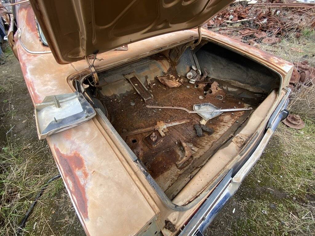

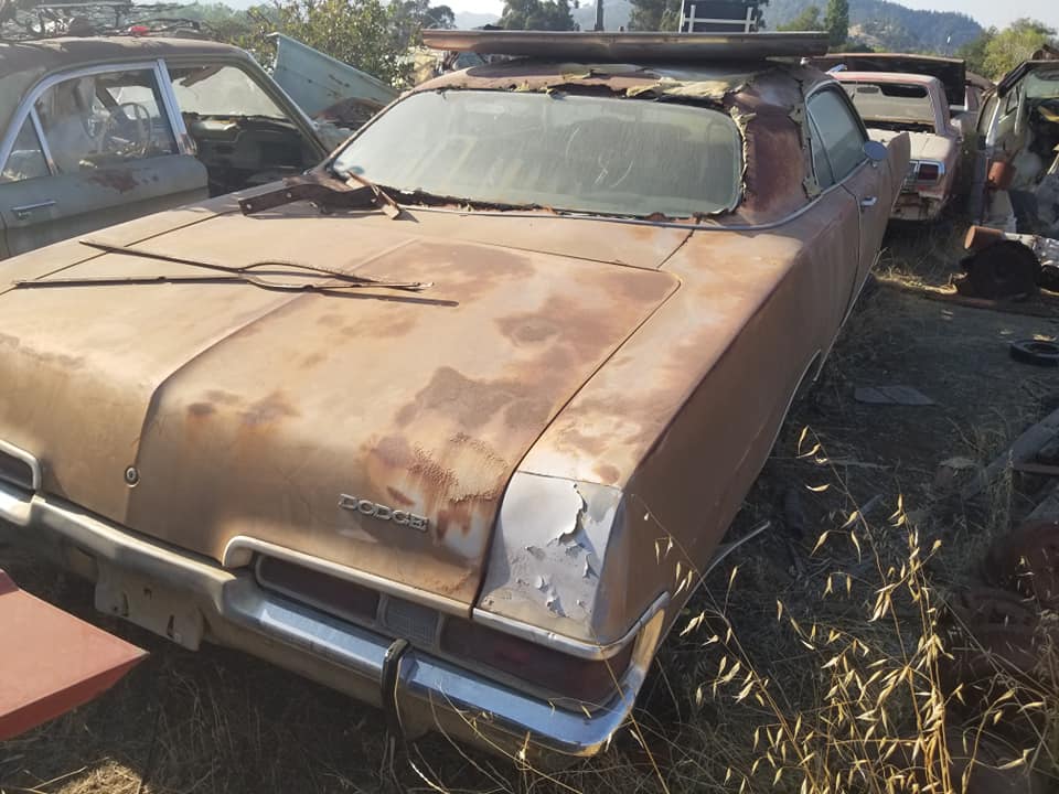

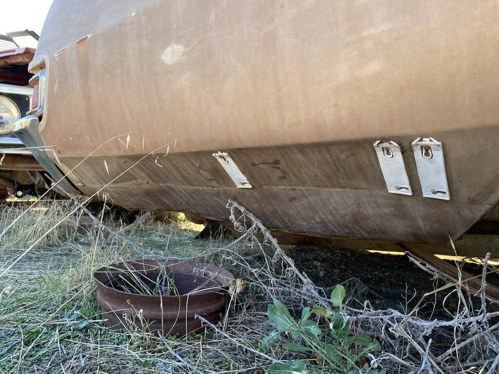

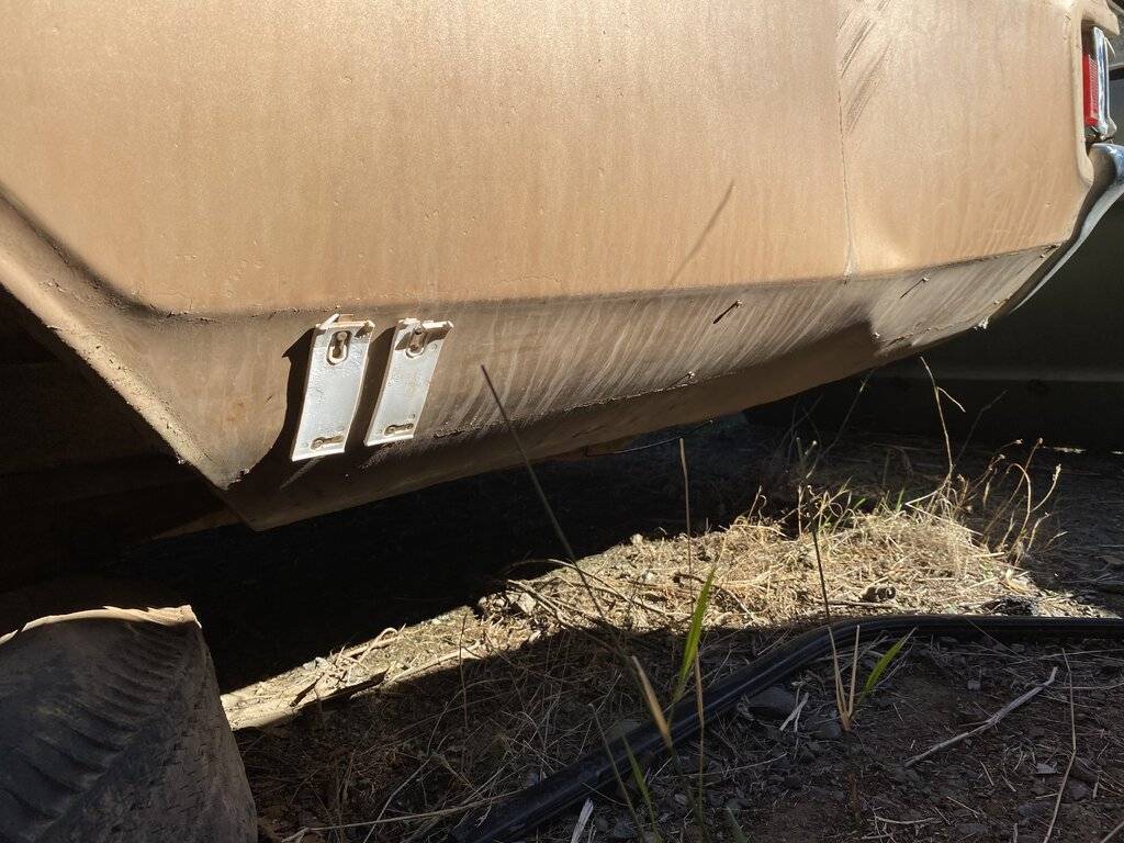

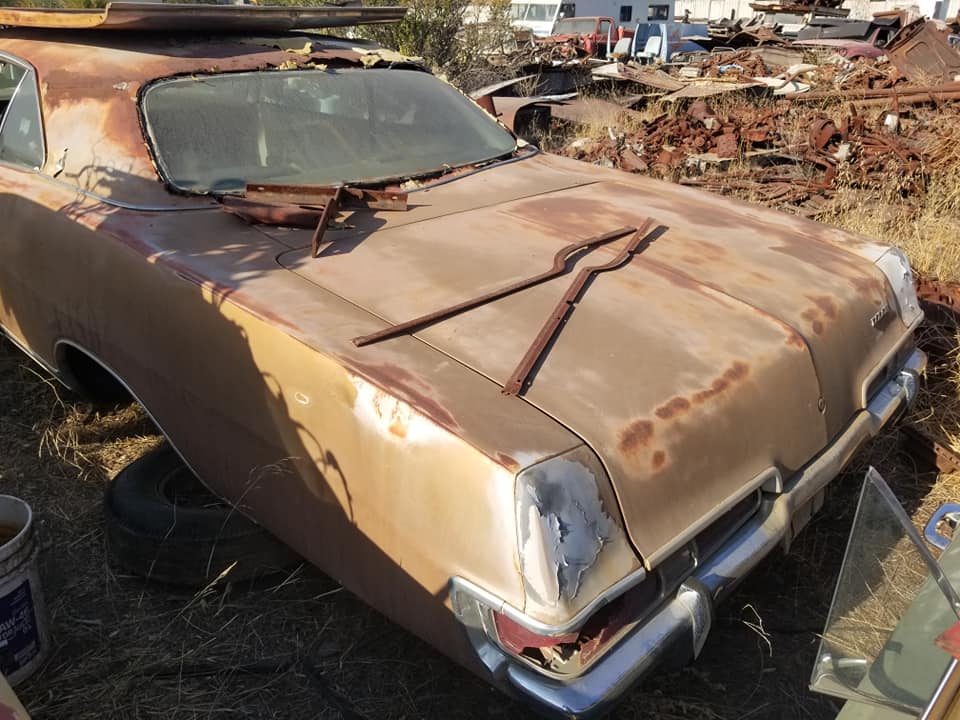

uhh, this one might be a pretty long shot...but there was this Polara 500 Coupe in a salvage yard in Cloverdale, California...it was advertised on FB....
IIRC @MrMoparCHP has gotten parts from this car..
I didn’t get a good look at them, car was actually pretty solid.
call Logan 707-540-5208

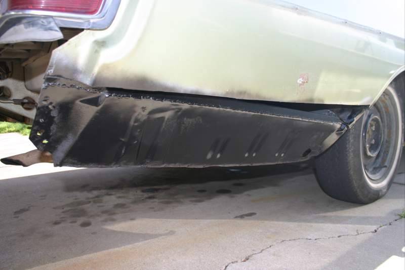

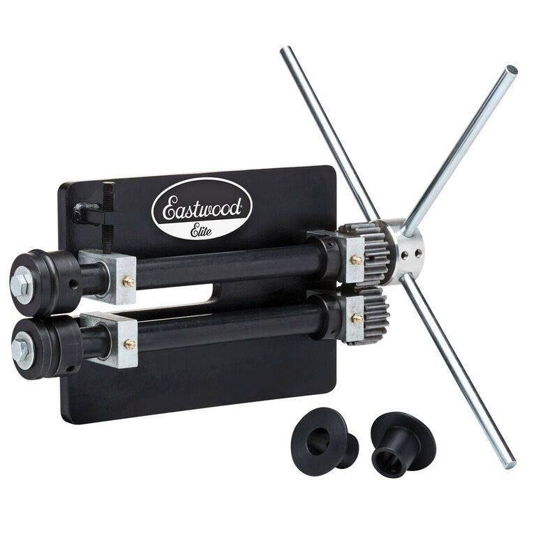

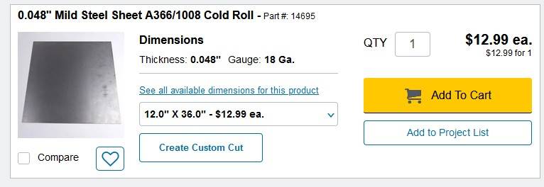

It may be hard to find a place that's willing to destroy a rust free quarter panel in order to sell the inner. If you strike out finding used ones, here's the only solution I can think of: the following two items, plus some time.
Keep in mind that they don't need to be perfect.
Jeff
If the lower portion is all you need you could probably fab it easily (there is a little twist to it), the outer may have to come off to get access.
Here the trunk floor portion was in good shape, both the vertical portion and the outer were bad.

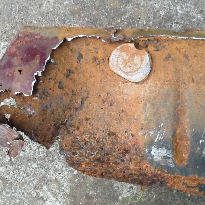

I'm starting to finally cut up the 70 300 I'm parting.

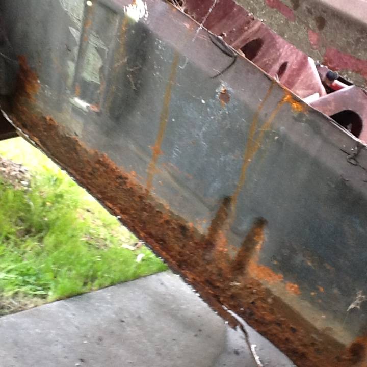

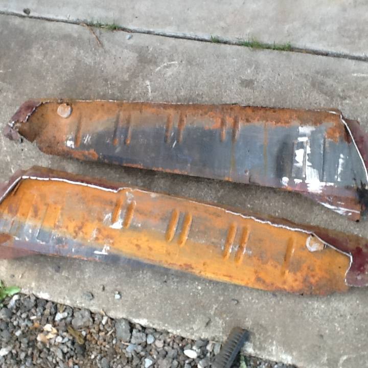

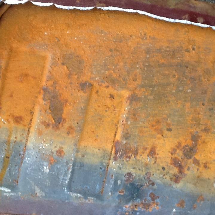

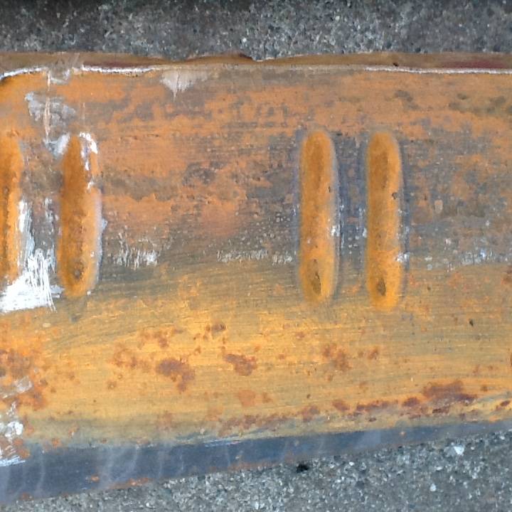

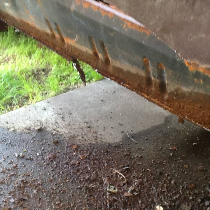

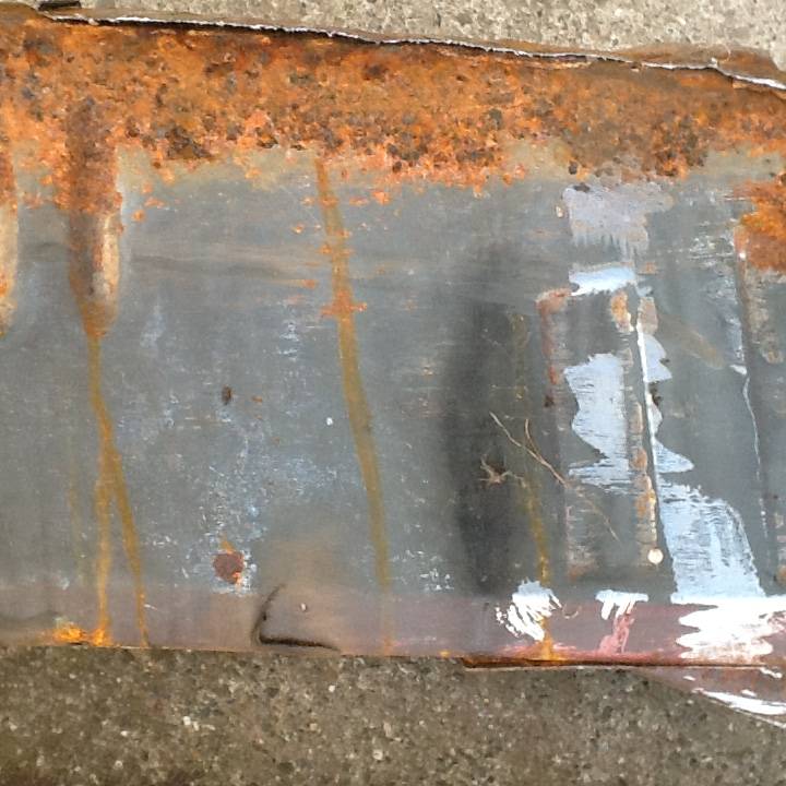

I cut away the rusty outer,but the inner looks to be usable to me?
Little scale,but no holes. Some thinness towards wheel
The trunk floor portion of drop down isn't very usable,but the sides are.
Not sure if 70 300 is the same as 69 polara?
There yours for postage if you can use them?
The 300 pieces would be pretty close to the Dodge ones. Would likely need to make some tweaks at both ends, but easier than making them from scratch.

Thanks... the trunk floor portion of mine are ok. I really need the drop down portion. When you have time, my zip is 53934 if you can get a quote to ship....
The other side looks to be good also. Should have the rest cut out soon.
Will Post pics when there out.
You can have them for the cost of postage.
They do look usable....
