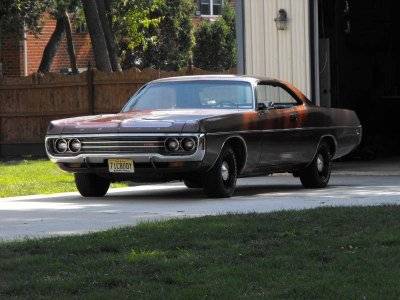

Can anyone tell me if 69 c body HP exhaust manifolds will fit a 71 c body with little or no modifications?
Thanks in advance!

Get rid of the white after the engine swap. PLEASE
