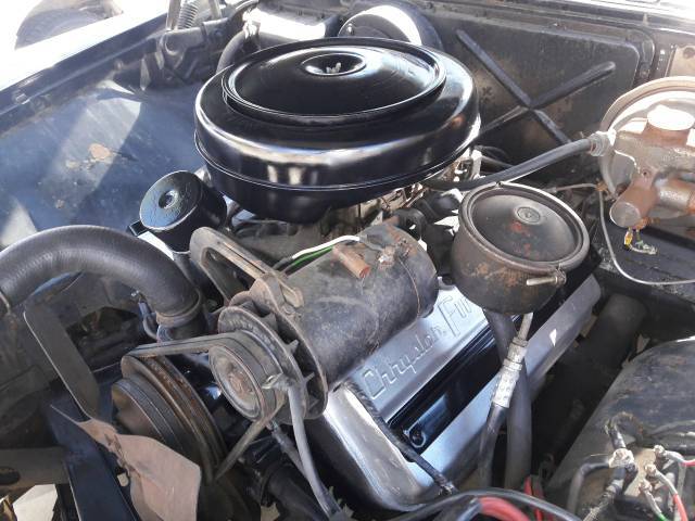

    Happen to have a photo of the generator handy? I'm trying to convert my 55 to 12V and have the 6V version with power steering pump combo. It would be nice to see the physical differences. Thanks,

    There is no physical difference. they are Identical

    Thanks! Looks fairly similar.
