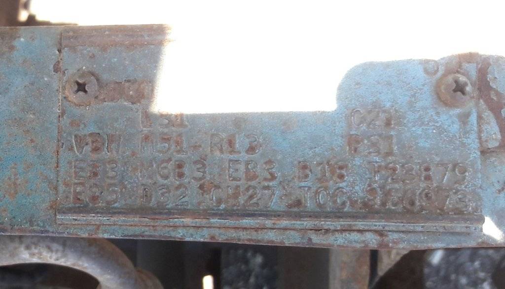

The super-nice Mr. Metaldad has taken some pictures of the car. Well, it is in quite some disarray and I have got stumped wih the decoding... Is this a Newport or a 300? The VINs and fender tags have much more information than GM's but not model code?!? I would say it is a genuine 300 because of the engine but your are the experts...
A Newport would be CE27, not CM27. It's a 300. The "Bahama blue", though, is a repaint: the original is B3 (light blue metallic -- see the tag and VIN pictures for a look at the original paint).
The following is courtesy MyMopar - Mopar Forums & Information - 1969-1974 Mopar Fender Tag Decoder:
C: Chrysler
M: Medium
27: Convertible
T: Unknown (should be a 440-4)
0: 1970
C: Jefferson Avenue, MI, USA
166973: Sequence number
E85: 440 cid 4 barrel V8 350hp
D32: Heavy Duty Automatic Transmission
EB3: Light Blue Metallic Exterior Color
M6B3: Trim - Opt. Decor Group, Vinyl Bucket Seats, Unknown Color (should be blue)
EB3: Light Blue Metallic Int. Door Frames
B18: Build Date: November 18
123879: Order number
V3W: White Convertible Top
H51: Air Conditioning with Heater
R13: Deluxe AM Radio (5 1/2 Watts)
P31: Power Windows
L31: Hood/Fender Mounted Turn Signals
C21: Center Front Seat Cushion
???: Unknown

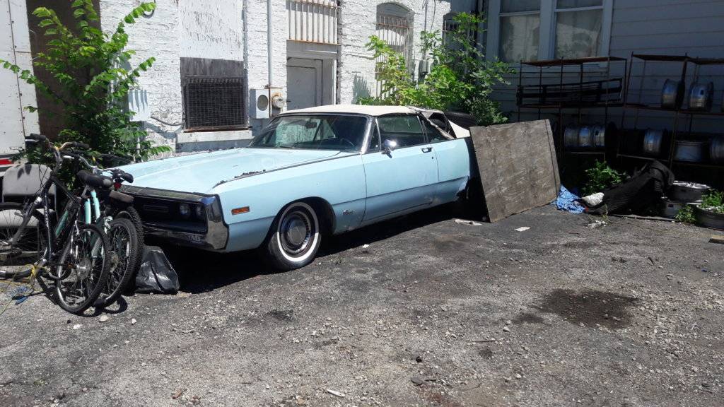

it was a cloudless BRIGHT day, i wasnt sure i unlocked my phone. needed a welding helmet with a #10 lens to see
So was it the crappy little mexi-shop I was thinking of, Bob?
lake st is lined with crappy little shops.
meckanic in garage in back no ever see blue chrysler.meckanic in garage in front say go ahead and go in yard.

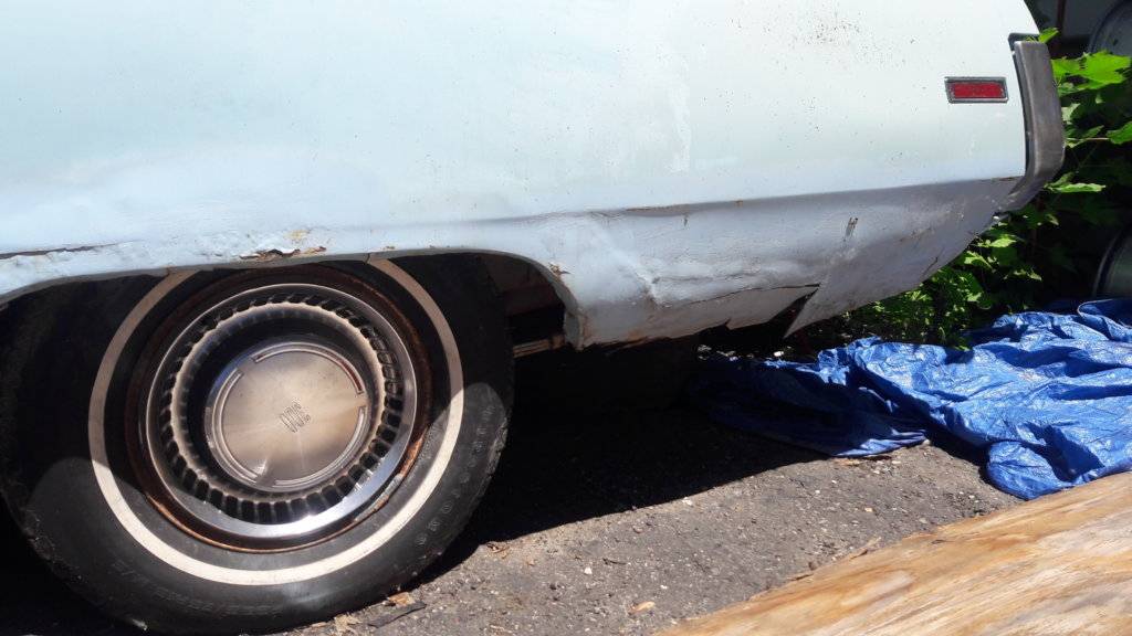

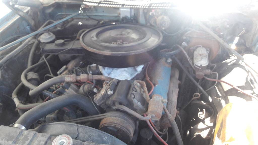

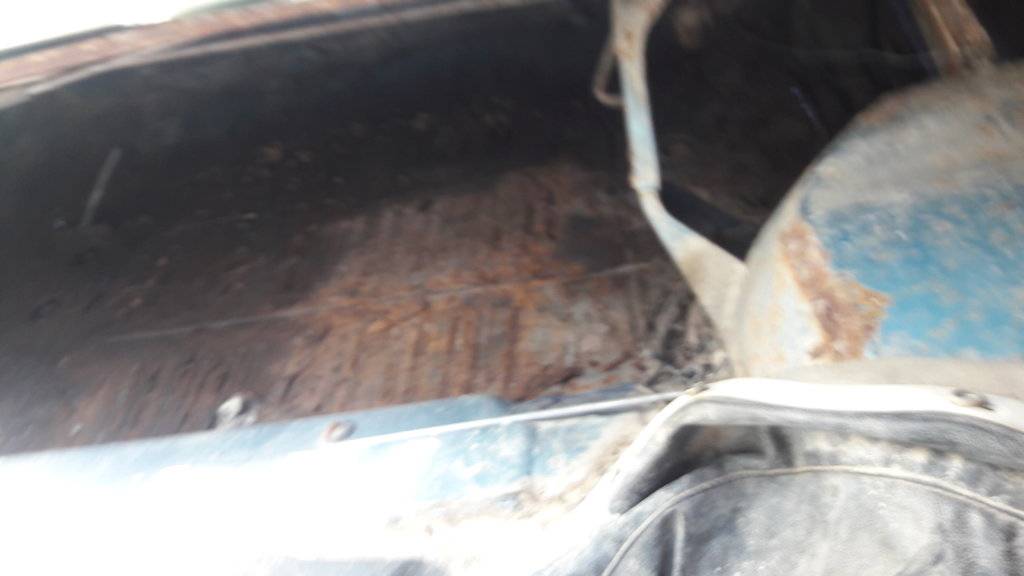

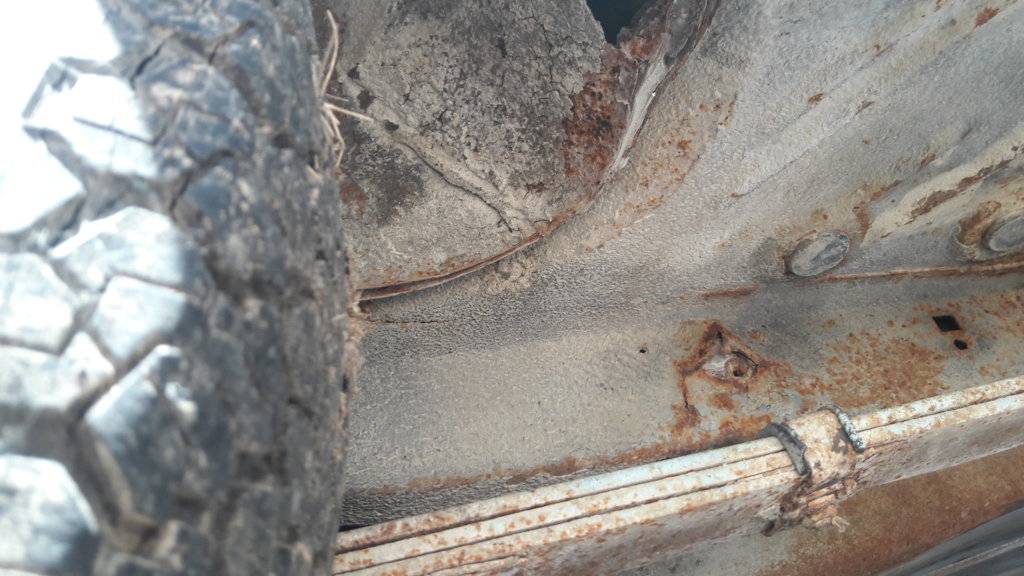

car is stored outside, no cover. top ripped, interior, well, it does not look like the first pic at the top. looks like woozels made a home in it. car was parked passenger side against wall, and backed up to wall. did NOT get on the ground to look under, car is low, and there was dog **** and dead woozel scttered around. took pics of driver side rear rail, by kneeling, and hoping pics would turn out.took a shot of trunk, from the cabin. trunk doesnt look that bad. glance down in between outside panel behind driver door, and passenger seat. that cavity didn't look that bad. carb off, owner stated carbs very difficult to work on, he found a 'guy', who's had it for awhile. stated brakes frozen. also engine does spin, as he put a pipe wrench on the crank.
sticker on wind sheild states virginia. he's had it about 18 months, and he's firm on price.
