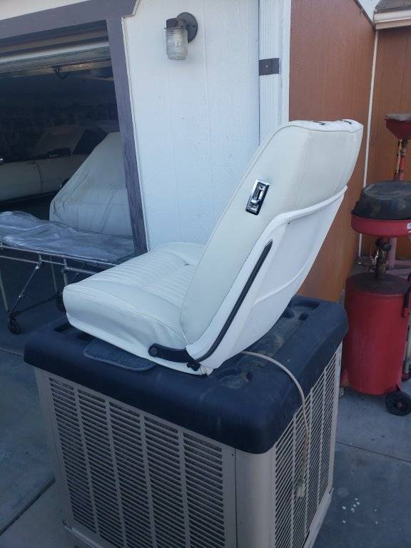

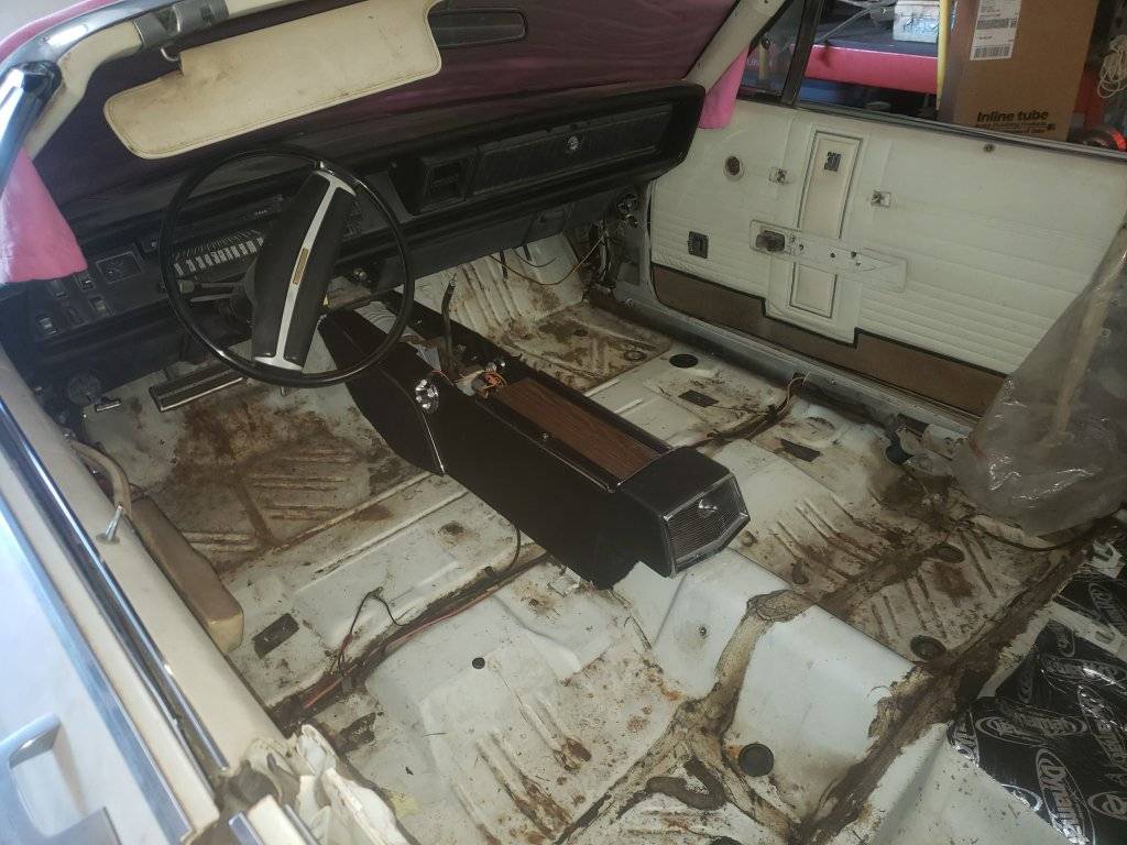

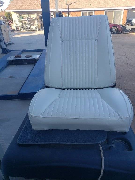

The 70 I have is factory with T/T and console. Iam in the process of doing the interior and have everything out. If there is anything you want a pic of let me know. I, am using a 69 repop top as I like that better than the 70 style.
Are you getting new seat covers from Legendary or are you having your upholstery guy doing them from scratch? I would like to see the results either way if you wouldn't mind. It looks like you are adding sound deadening and using dynamat. Great way to go in making those cars more quiet and luxurious feeling. If you need any new door pulls Bob Baker now reproduces them and they appear exactly as the originals and I have seen no other efforts that came close at all. Even the Chrysler 300 Club International had some reproductions made but they didn't look close enough to the originals for me to go for them. If you do go with Bob Baker, you would need to send him your old parts and he could take it from there. Just FYI.
Thanks for the info, the car came with legendary covers front and rear. Ready for install once i get the floors done.
Interesting that you got the rear seat covers too. Currently, Legendary no longer carries them. Do you have any idea when yours were originally received?
As a result, I asked Legendary if they would remake them if I supplied a good set of seats to make patterns again and they agreed??? So I sent them on a pallet about 3 months ago now at some expense so they would supply them again. What is Legendary doing when they must apparently throw out patterns and then agree to remake them again??? Wierd.
Friend that I bought the car from had purchased, the front and rear covers, carpet and he had sent his boot cover in as a sample for them to make that also. Was at least 8years ago.
That's a little strange... The boot on my '70 300 vert was done by Legendary probably about 15 years ago. I was told by the PO (a good friend) that the original boot from mine was used as a pattern. I replaced it again last year.
I also have Legendary seat covers, front and rear, from the owner before that.. at least 20 years ago... I have the paperwork and I'll dig it out.
Wonder if the '70 300 pattern box got lost.
