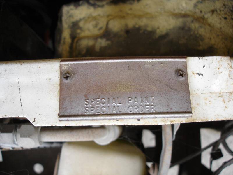

I was able to take a quick look at this last week. It has all the Hurst parts etc and looks real . Quick look under the hood there was 1 data plate on the core support and had only special order and special paint on it nothing else. I ,am going back to look for another data plate broadcast sheet etc. Any ideas on anything that would identify it as the real thing? With my little knowledge on these it should not exist? Any help would be appreciated .Thanks

Took a second look and found the other data plate from the cowl support . All the codes put it to be a base engine 440 4bl= E85. Did the 300 start with the base engine or should it have the E86 440 hp engine? The only thing I can not find out is what this other plate might have meant? Pic below Thanks for all the help.
The data tag is likely from a fleet car that was special ordered and painted "special", and added later.

The car you are dealing with is not the Hurst convertible, or the scheduled "second" Hurst convertible, which was never built.
It is a clone/replica/fakie-do/tribute,...whatever.

I found the other tag in a box and after running the #s I came up with the same thing . It has a boatload of Nos parts with it so if the deal is right I might do it.Thanks
