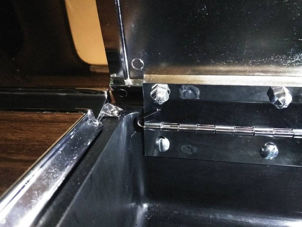

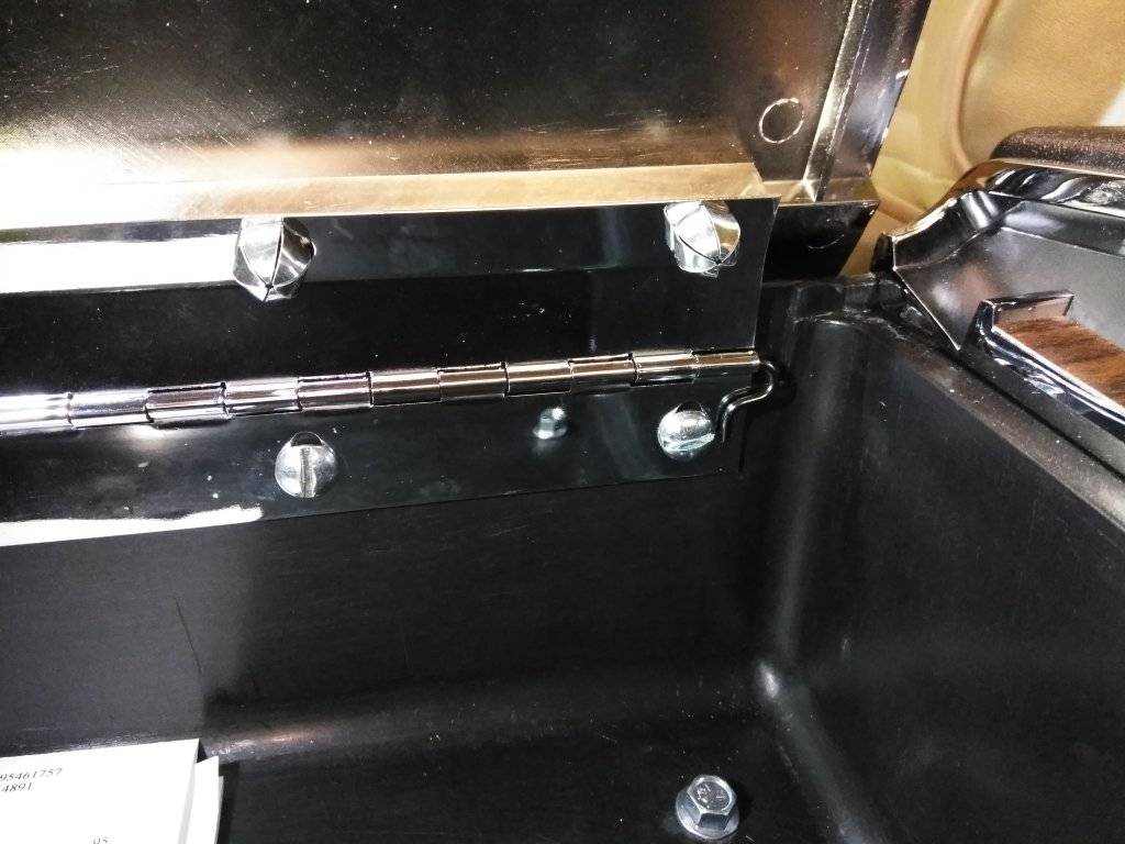

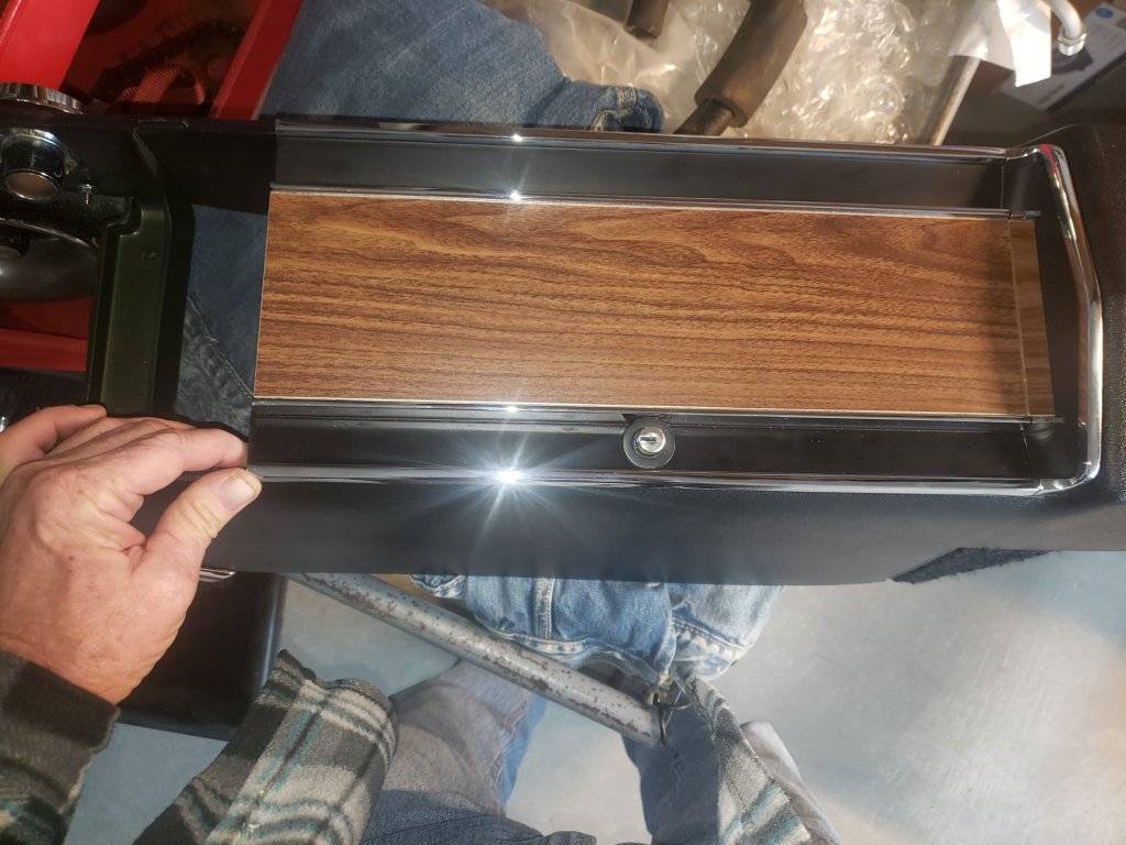

I have a 70 and replacing the vinyl tops with a 69-woodgrain top. I have 69 re pop woodgrain tops. Cannot seem to get the 69 hinge to work with the 70 console. Could anyone get a pic of a 69 or 68 hinge area, not sure how far back that console base was used. Thanks for the help.
I can't help with a photo. The console plastic housing was the same from 1966 - 1973. There is no reason that a '69 lid should not fit unless the screw holes don't line up.
I've read that the re-pop tops don't fit well, except possibly with the re-pop base.

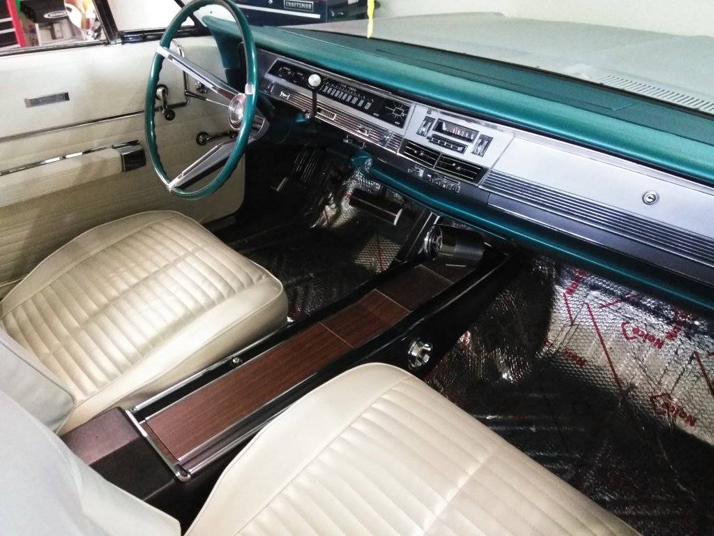

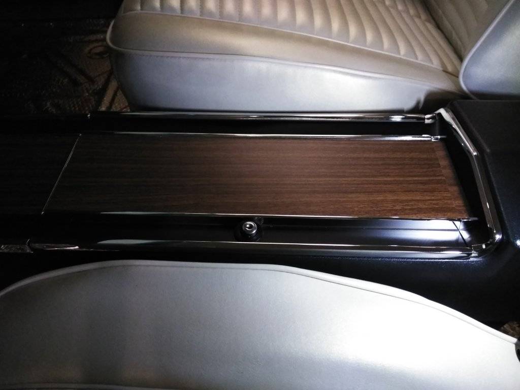

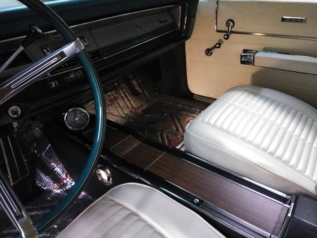

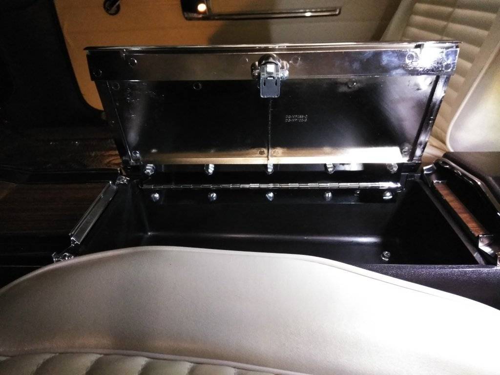

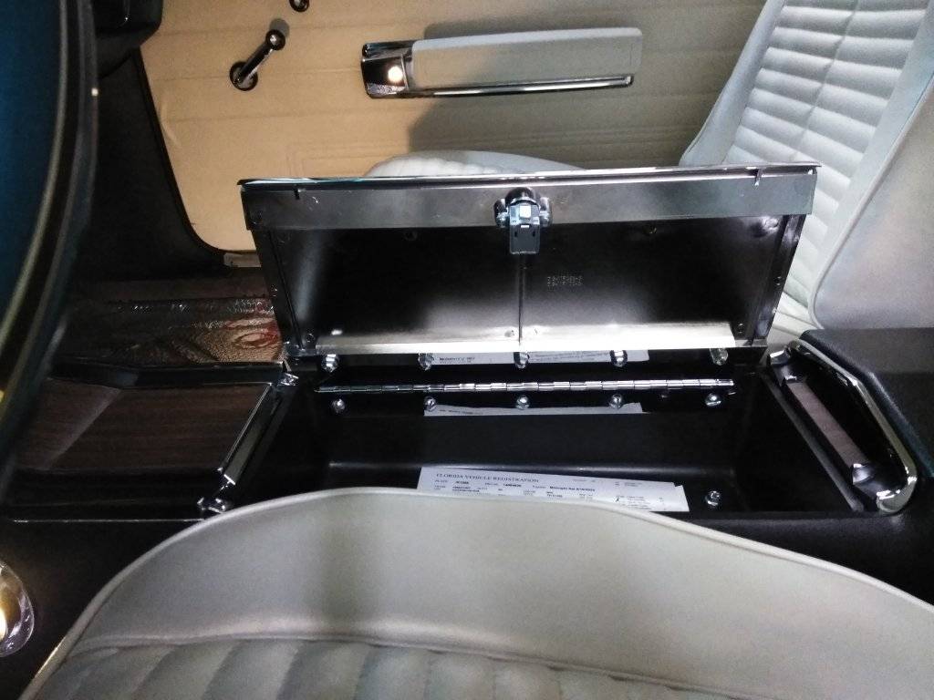

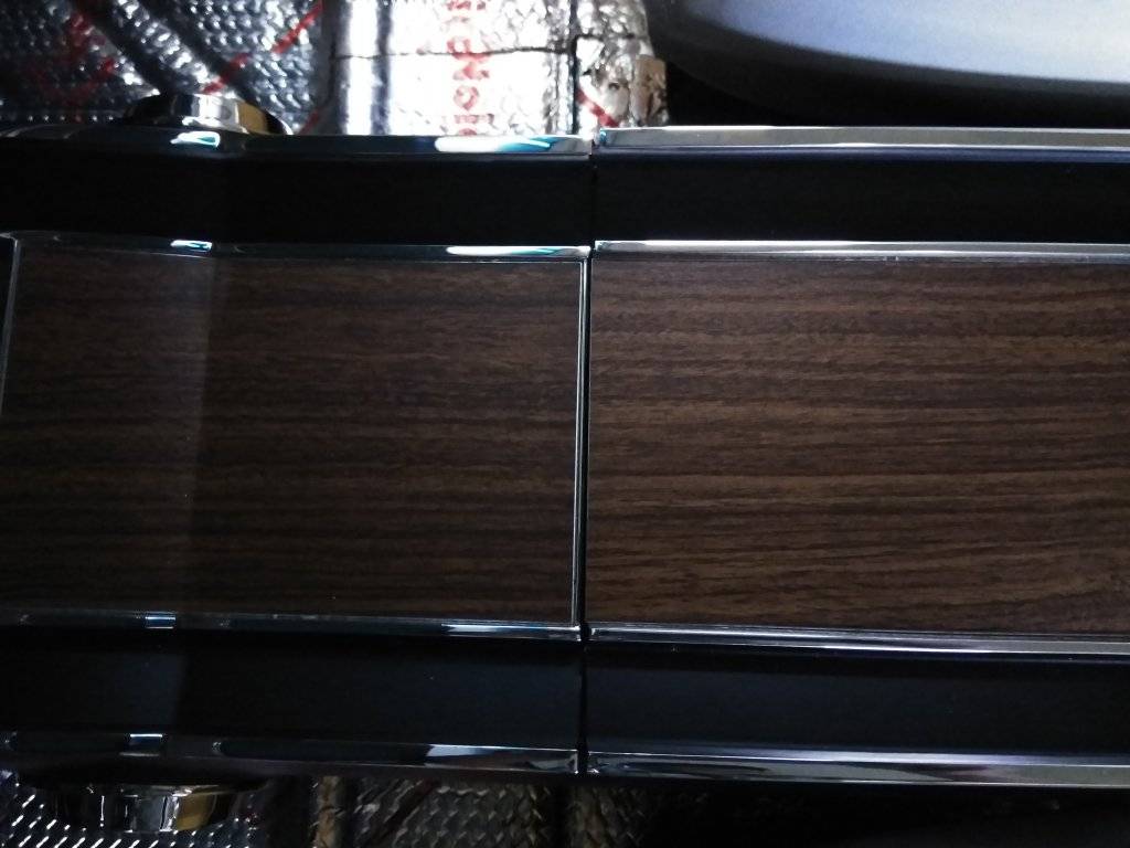

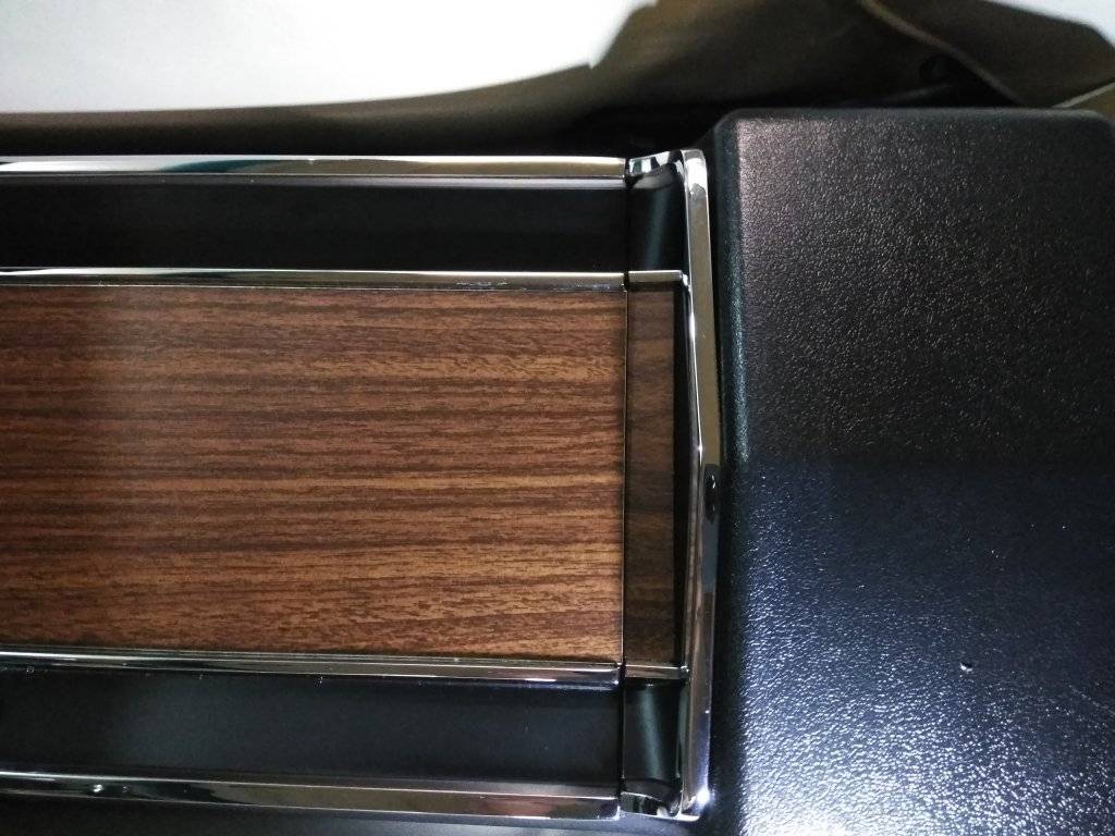

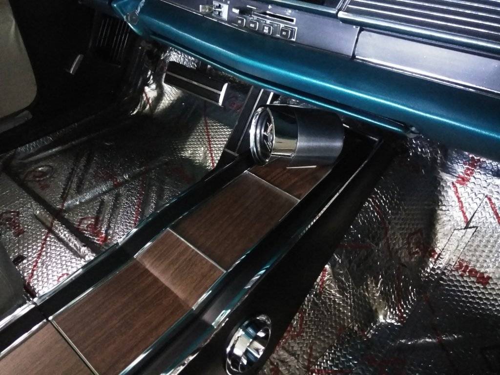

Not sure if this is what you're looking for. Here are some images of all re-pop stuff I have installed. The gaps are very close and take some patience to get right.
Nice! Unless it's there and I can't tell from the photo (dark), you need one of those shifter delete plates that are so hard to find.
That would have been nice. Fortunately, I have access to CNC equipment at work so I could make do.

The pics really helped, thanks. Had a brain fart with the hinge, pic clarified it in a second. The top fits the original console nicely. Looks like the latch tab for the lid is different than the 70-latch tab. They sell a whole kit that has the screw reinforcement plates for 69 and down and the lid latch tab. I just need the lid latch tab, If I have to, I'll buy a whole kit or does anyone have just a tab for sale? Thanks
