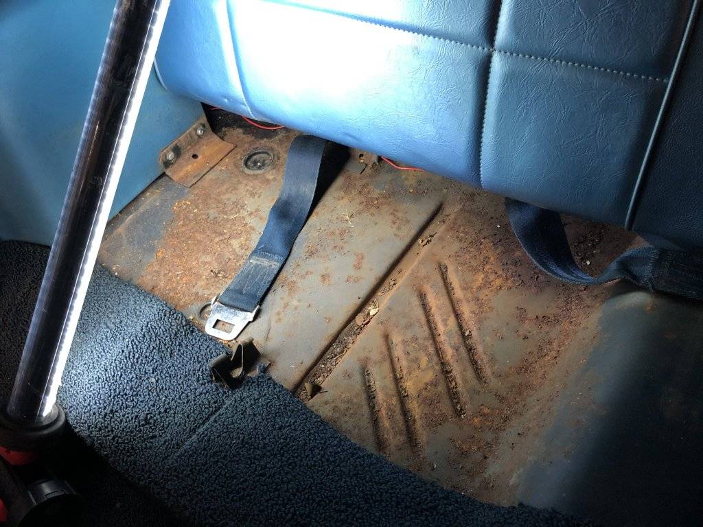

This shows it stopping just under the seat all the way across (I suspect this is a non convertible replacement).
It does go back far enough to cover what might be seen at the ends of the seat.
This was the issue that I was thinking about.

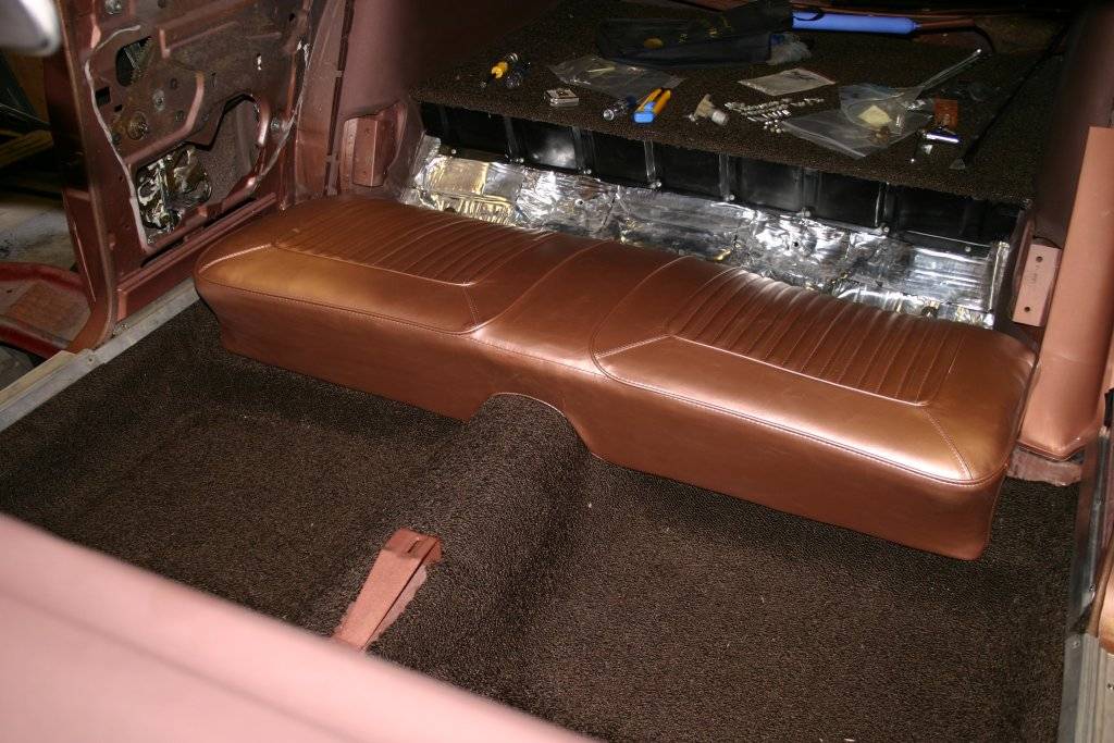

This is my Barracuda.

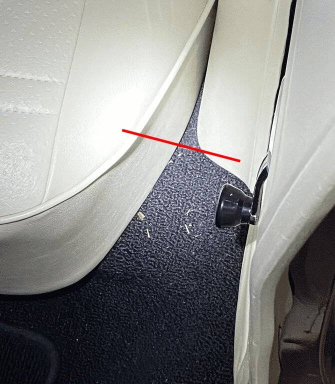

As I understand it, the big issue is the area around the rear seat. The 'vert rear seat is rounded off more than the hardtop. This is a pic from one of the mentioned threads.
The only other issue may be the seat belt area, but I'm not sure on that one.
I think that if you buy some extra yardage of carpet, or if you can get them to trim it long, you can make the hardtop carpet work, but that's an educated guess at best. The company that made the correct carpet was bought by ACC and they haven't bothered to offer the convertible version.
The area behind the red line is what is missing.

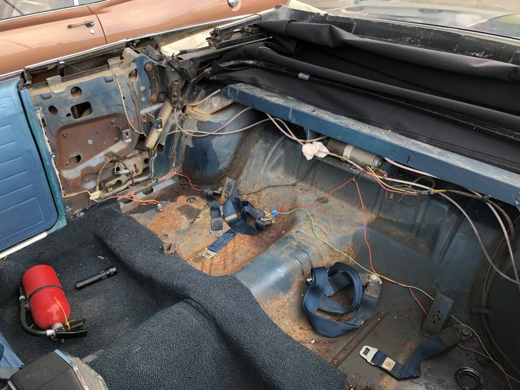

On my Barracuda I found a piece of the original carpet that wasn't worn and tucked it under the other one there. Looks like they did that here.
