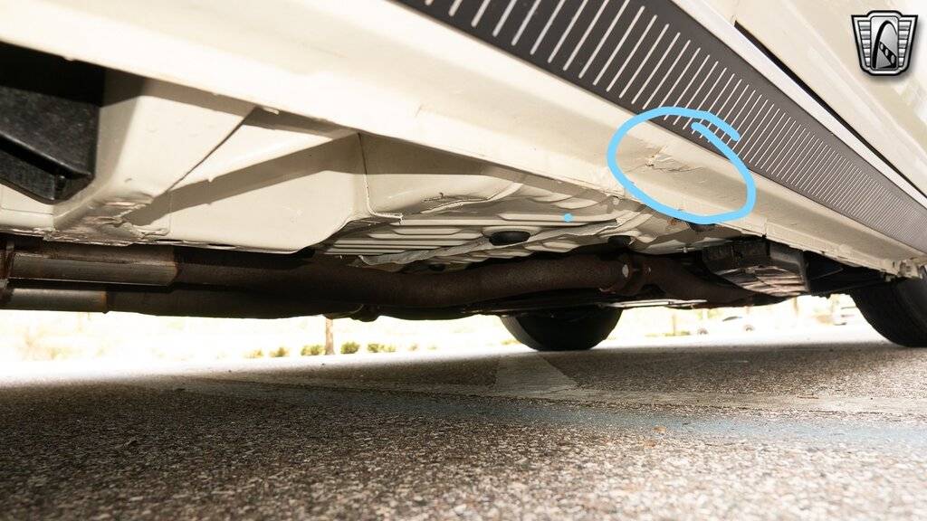

Yep, seen it. Been thru EBAY with no reserve start price a couple of times. Hasn't busted $20,000.
Seller seems to know a lot about the engine but doesn't seem to know the interior was from Imperial.
"Factory modified dual exhaust." Not!! That's aftermarket stuff.
This car has had a lot of work done on it. See the new strut bushings and washers?

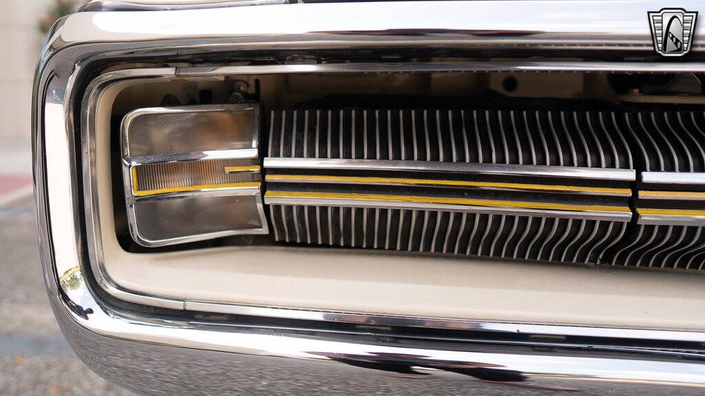

The fitment of several items looks bad.
What really looks bad is that aftermarket AC. Yuck!!
Would this be a good car to own? Sure, but not at that price.
In my opinion....

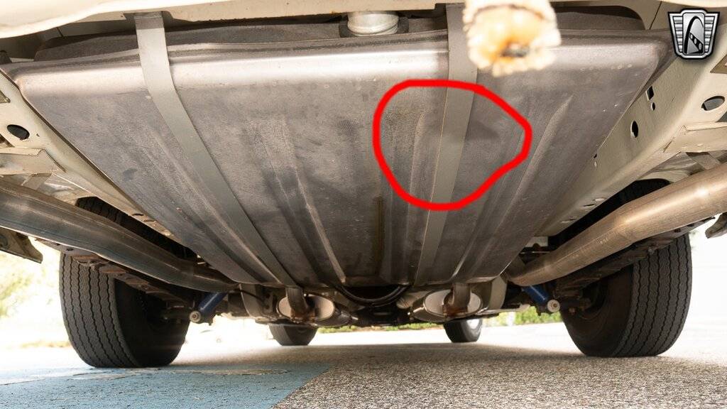

Is this a dent in the gas Tank? Also looks like something is leaking on front of gas tank, pinion seal? chuck gasket? sender seal gasket?

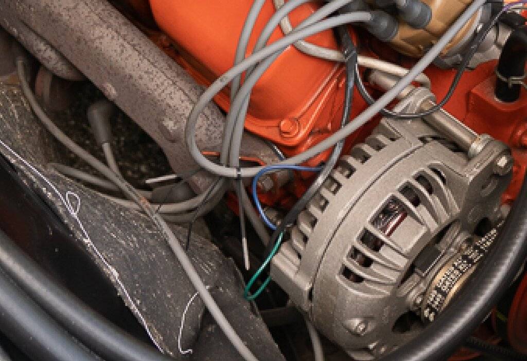

Questionable plug wire routing. Are those Ty-Raps, oops zip ties, factory?

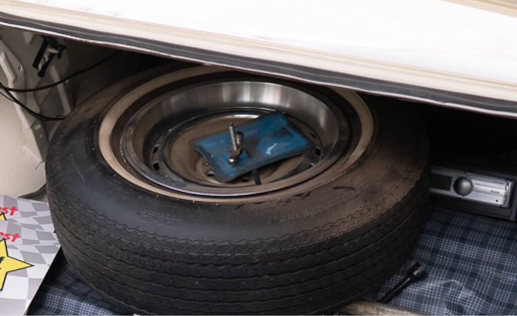

I'm straining my brain on this spare tire, is that overspray?
And we won't mention the headlight cover alignment...

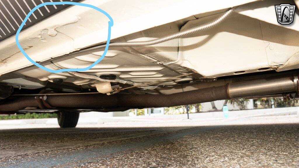

Wow....he must of got it cheap, or had it repaired cheap...
I was selling a repaired park ave years ago, my body work was damn neat perfect
However, the frame shop pulled out the quarter, and seam sealer popped out. In a hurry, I put the rear seat in
The buyer was looking it over, and couldn't believe it turned out so good. He wanted to see the floor, so I pulled the seat
He noticed the small area without seam sealer. The amazing bodywork then turned to " hack" I'm his eyes. I even showed him the tube, and told him why I hadn't sealed it yet
He passed, next guy fell in love with the car, loved it
Some people talk them selves out of purchases sometimes
Another guy heard " these tranny's go out" it had service records and shifted perfect, didn't matter...
That dealer bought it from my brother in law 3 years ago for 36 grand. It went to medium right after that and went up to 60 grand reserve wasn’t met. Now he’s stuck with it. Pigs get fed, hogs get slaughtered.

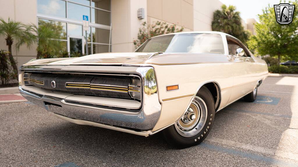

If you check the pin stripes on both front fenders they are waaaaay off. At best a 36000 dollar buy w/ the above mentioned errors.
I still wanna know about the mis-matched paint.
It's like the longer you look at the car the worse it gets.
