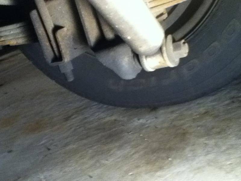

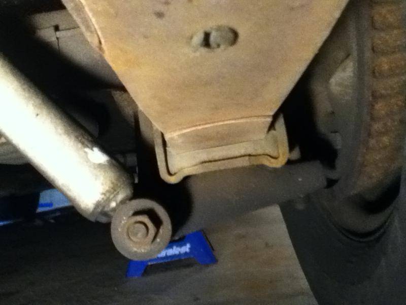

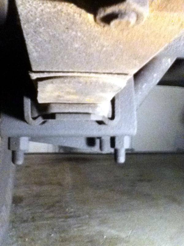

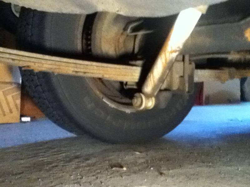

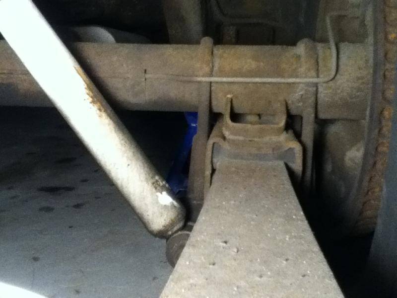

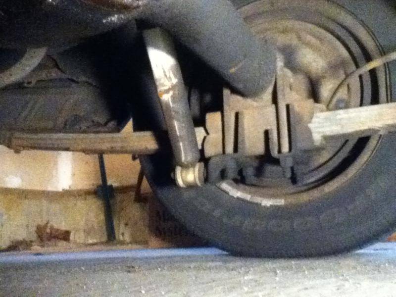

I am swapping out my rear springs for new ones myself. Speaking with Springs N Things vendor to secure new pieces (I think some here might have used them?). I am having problems getting the correct/proper parts as SNT says the brackets holding the springs are not "scalloped". Whaaa? Anybody else with Chrysler fuselage car run into this? SNT says this is particular to the Chrysler bodies as apposed to the Dodge/Plymouth fuselage models of the same year. Mistaken thought that small detail would be the same between Dodge Chrysler Plymouth. IMG_5655.jpgIMG_5657.jpgIMG_5658.jpgIMG_5659.jpgIMG_5660.jpgIMG_5661.jpg

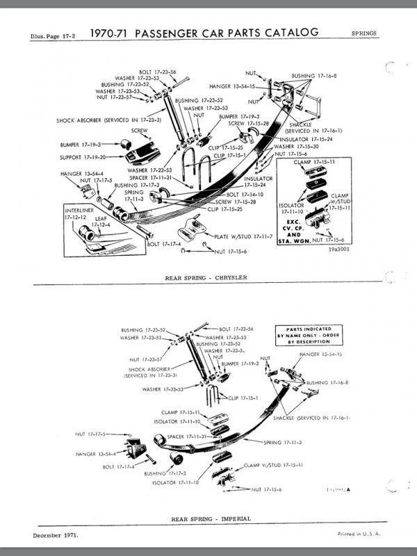

There are different brackets and springs, convertable, coupe, hard top, etc. I noticed the difference when I was under my parts car this weekend. Here is a shot of the parts catalog, maybe help to make sense of the setup.
I'm not sure what Scalloped part you're looking at.

If you want your Newport to have a nice rake order the 1" over stock height springs. They will start off tall but will settle in nicely. I also recommend 7 leaf springs if your car doesn't have them .
Is the "scalloped" piece right where the isolator is? Unless yours is broken or damaged you will not need to replace any of that, you'll even use the same isolator.

Yes, apparently part of that torsion quiet system.
I believe PST, and energy suspensions offers poly insulators if wanted. Cost the same as new rubber insulators.
Part numbers:
This is what the vert ones look like:

Me neither. I've never seen what they are describing (scalloped bracket).
Do you know who does make the correct shackles? Laura is very nice , spent a bunch of time talking with her last week about this. She thought they has my springs, but this little issue apparently changes all that. They are saying this scalloped bracket doohiky came out on full size mopars (C bodies) in 1972. I have no idea what the hell that is, never seen a "scalloped" bracket holding the springs in place.

Looking at FirmFeel's website I noticed that their spring eye bushings are wavy or scalloped.
I also found Isolators from various vendors that have wavy or scalloped sides. this would not be clearly visible until they were removed.
One of you have a stand alone picture of this scalloped part you are talking about?

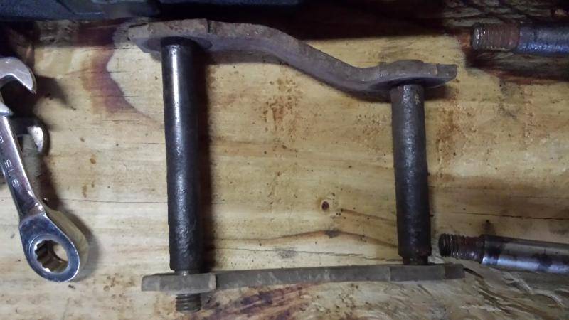

Gary, your springs and brackets look like what is under my 71...
And to my research there is no reproduction shackles for our cars, unless I missed something . Laura was also surprised to see the shackles that we have. She has been selling people straight shackles without the offset and no one has said anything. My bolts snapped and I had to source used.

Just wondering if you could use 1/2 of the 2" offset shackles that Mopar offers?
Wow, THANKS Dave for the info. Thinking about using a torch to heat the metal up to avoid breaking/snapping bolts (if need be). I kinda thought my car would have the same type hardware yours does. In fact I mentioned this to Laura when I first started talking to them last week (similarities between the 70 c bodies Dodge Chrysler Plymouth). Did you ultimate purchase springs from them (SpringsNThings)?
