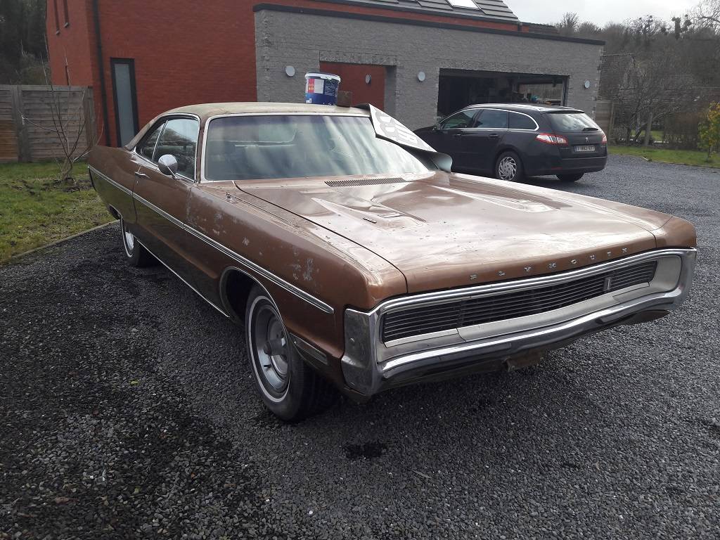

Hello everyone,
I'm starting a thread here for the restoration of my '70 Plymouth Sport Fury.
It's a highly optioned car, with desirable options :
- 383HP non-AC
- anti-sway bar
- power disc brakes
- bucket seats
- console
- tilt steering column
- power Windows
- remote trunk lid release
- light package
I'm looking forward to your help as I go along.
Can't wait to see the end results -- your '58 is stunning!
(PM addition): This is an N-code, will be interested in your reviews of the car/drivetrain.
Yes another '70 Fury being restored, a really great year for Plymouth! I look forward to watching the project.
:thumbsup::thumbsup:

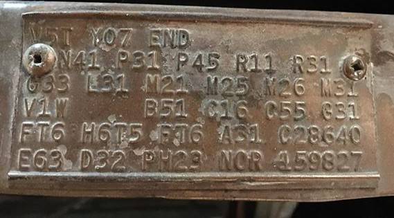

Here is the fender tag
PH23: Plymouth Fury, High, 2 Door Hardtop
N0R: 383 330HP OR 335HP 1-4BBL 8 CYL, 1970, Windsor ONT CAN
159827: Sequence number
E63: 383 cid 4 barrel V8 H.P. 335hp
D32: Heavy Duty Automatic Transmission
FT6: Burnt Tan Poly Exterior Color
H6T5: Trim - High, Vinyl Bucket Seats, Tan
FT6: Burnt Tan Poly Int. Door Frames
A31: Build Date: October 31
C28640: Order number
V1W: Full Vinyl Top, White
B51: Power Brakes
C16: Console w/Woodgrain Panel
C55: Bucket Seats
G31: OS RH Manual Standard Mirror
G33: LH Remote Racing Mirror
L31: Hood/Fender Mounted Turn Signals
M21: Roof drip rail moldings
M25: Wide sill moldings
M26: Wheel Lip Moldings
M31: Belt Moldings
N41: Dual Exhaust
P31: Power Windows
P45: Power Deck Lid Release
R11: Radio Solid State AM (2 Watts)
R31: Rear Seat Speaker(s)
V5T: Body Side Stripes, Tan
Y07: Build to Canada Specs
END: End of Sales Codes

How Canuck specs differ from those of cars made to be sold in US?
Per this, the 383HP makes 330hp: https://www.hamtramck-historical.com/images/dealerships/DealershipDataBook/1970/70_Fury0014.jpg
