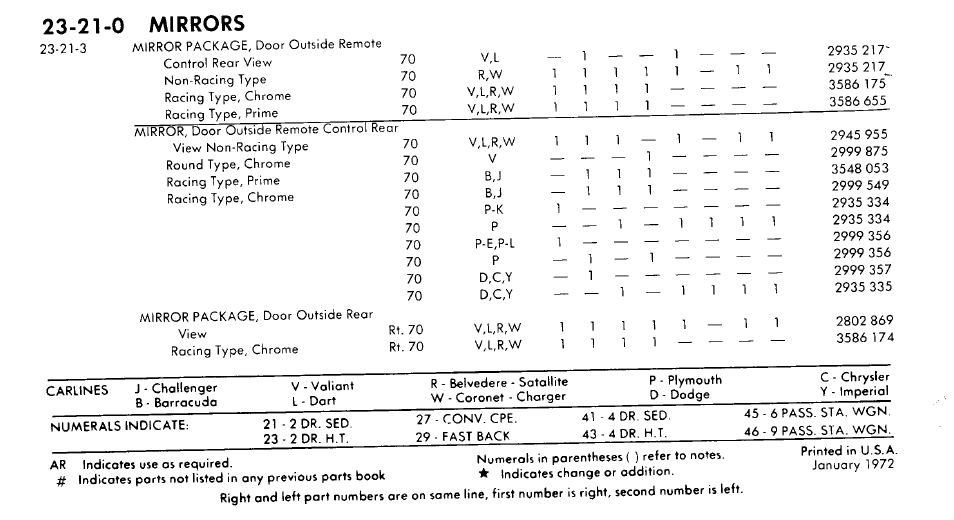

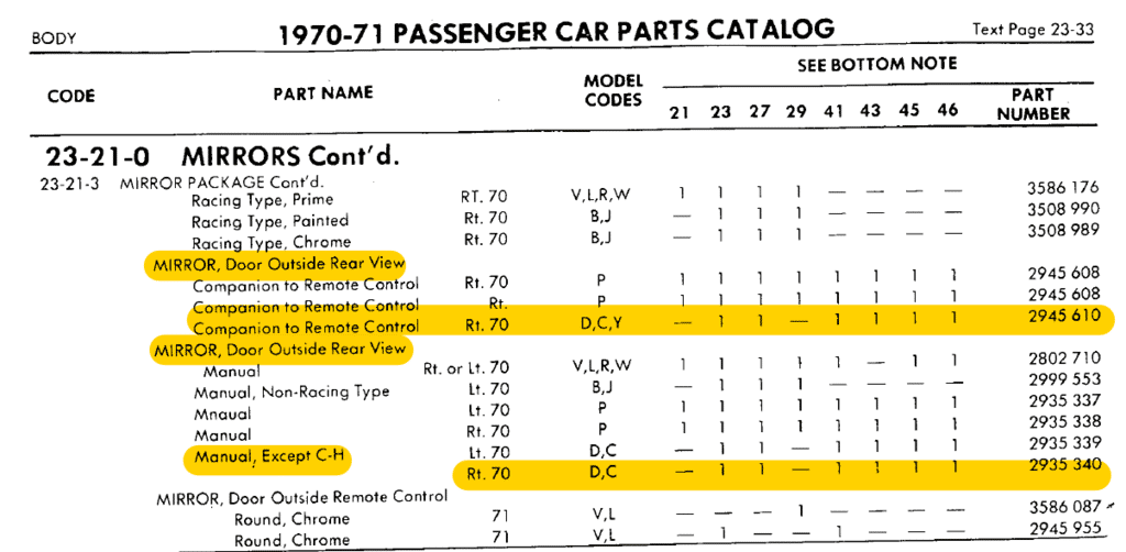

Here are some scans I made last September of the 1970-1971 parts manual. I inverted the order of the two pages for greater readability, and for your convenience I have highlighted the part numbers for RHS 1970 Polara mirrors:
Searching for with above info should help you identify sources. Hiltop has a RHS companion to the manual mirror (PN 2935340):
