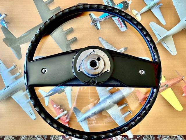

I guess I'll need to start there, with determining the wheel I currently have. It was given to me many years ago and I have no idea what it came out of, nor did the guy that gave it to me. I recently had it completely refurbished with modifications made to add a new rim blow and switch installed (via The Steering Wheel Guy). A buddy and I made an attempt to see if things would line up with my existing components and the turn signal switch does not for starters. At that point we aborted the mission. I'll get to researching it a little further and see what's up. Appreciate the info. Thanks.

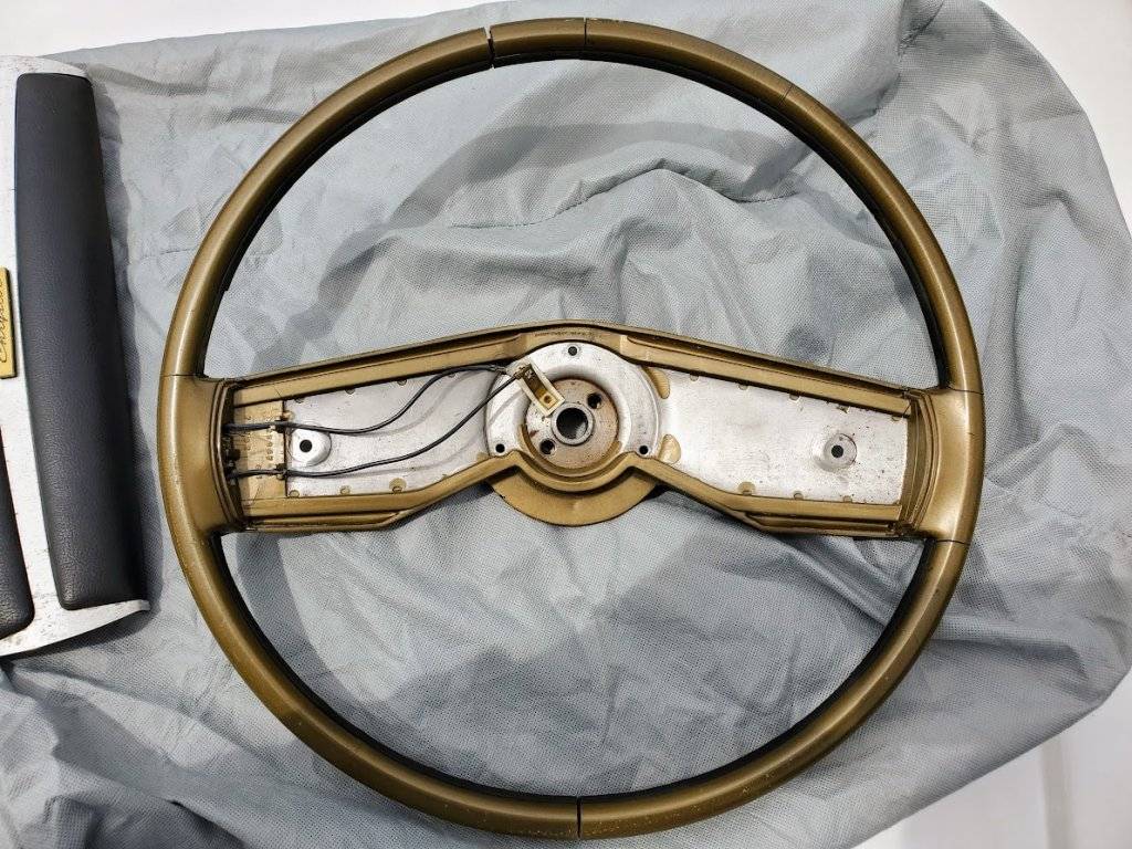

I'm looking particularly for the parts to convert my standard steering wheel to this Rim Blow which I'm not 100% sure which version I have. I know I couldn't swap the 2 wheels for each other because I tried that already.....that would have been too easy. I was on vacation for the past 2 weeks and haven't had a chance to research it in the parts manual. The service manual was of no help at all. This is a picture of the wheel prior to restoration. The part number is partially obstructed from the wiring, but I think I see a 29987...??? I believe this might be a tilt wheel which requires a different turn signal switch, etc. Sounds like I might have to replace the column? Thanks.

That looks suspiciously like the one that is on my '70 Monaco Brougham tilt wheel. There should be a recess at the bottom, behind the wheel's center, that is cast but not machined for the telescope lock lever. The center trim piece is the same, too, other than mine has a "DODGE" name on it.
