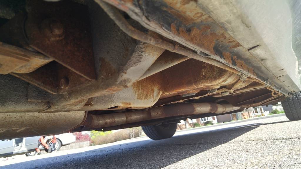

I swear I remember seeing a post on this, but my search is coming up with nothing. Just to clarify, the rocker to floor "pinch" from the front of the rear wheel well to the rear of the front wheel well was blacked out at the factory, correct?
He's a pic of the original 70 SF up for sale on the boards right now. I was stupid and didn't take any pictures before stripping mine.
Yes the pinchweld is supposed to be black from factory, that picture you have posted is a good reference.
