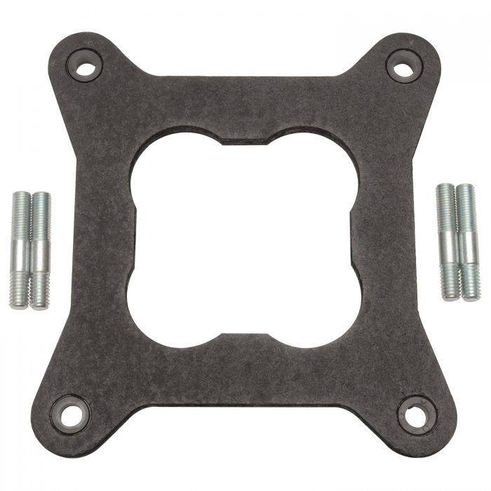

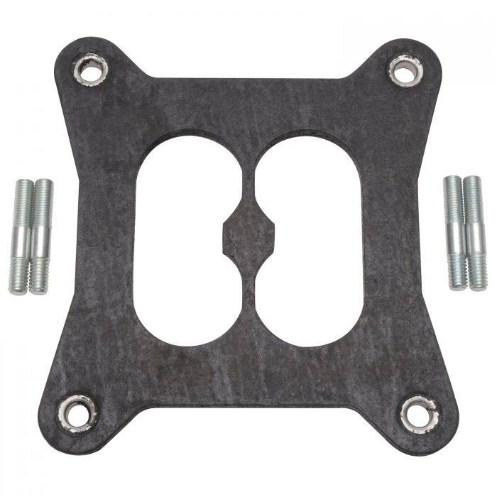

CBODY67

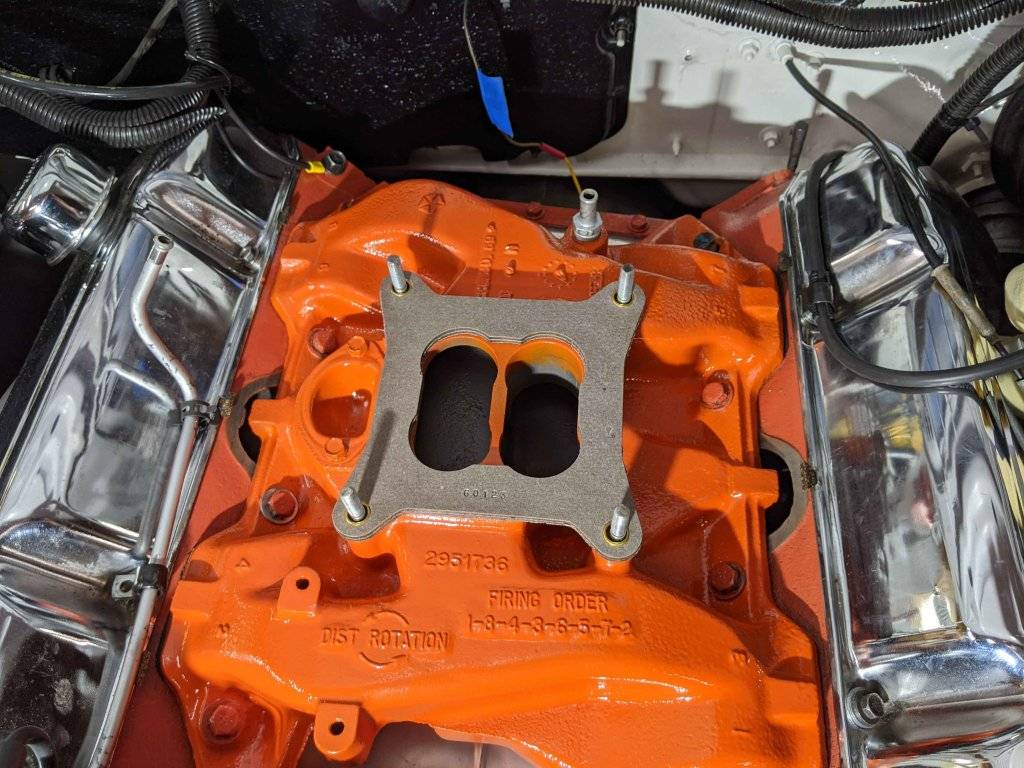

I used one of the gaskets Willis mentioned on my 1970 Fury 440, factory intake
Open design has worked well with Edelbrock carb AVS2 800 cfm
