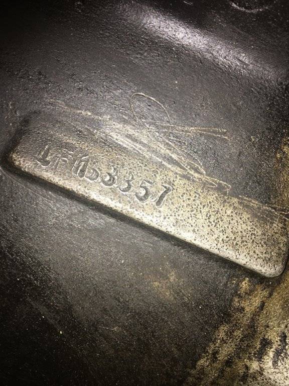

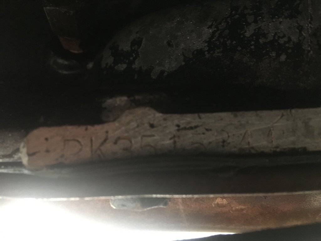

    6B7A72FF-8EEA-4B0F-A82E-A5360A8C04D6.jpeg 7AB6EDE4-12B0-4757-BACF-6F31FF5C7373.jpeg 6B7A72FF-8EEA-4B0F-A82E-A5360A8C04D6.jpeg 7AB6EDE4-12B0-4757-BACF-6F31FF5C7373.jpeg Here are pictures of the numbers. The first two letters on the drivers side looks like DK

    Driver's side numbers start with PK
    Looks like 3515344, confirm?
    That number does not work.

    Are the last 8 digits of your VIN. F1153857? Or something close?
    The first letters are PK. Write PK and DK on a paper, cover the bottom third. Which one looks like your trans?

    The numbers are stamped poorly. I found the number on my mopar.com but the 8 looks like a 3. I think the first two letters are DK.
