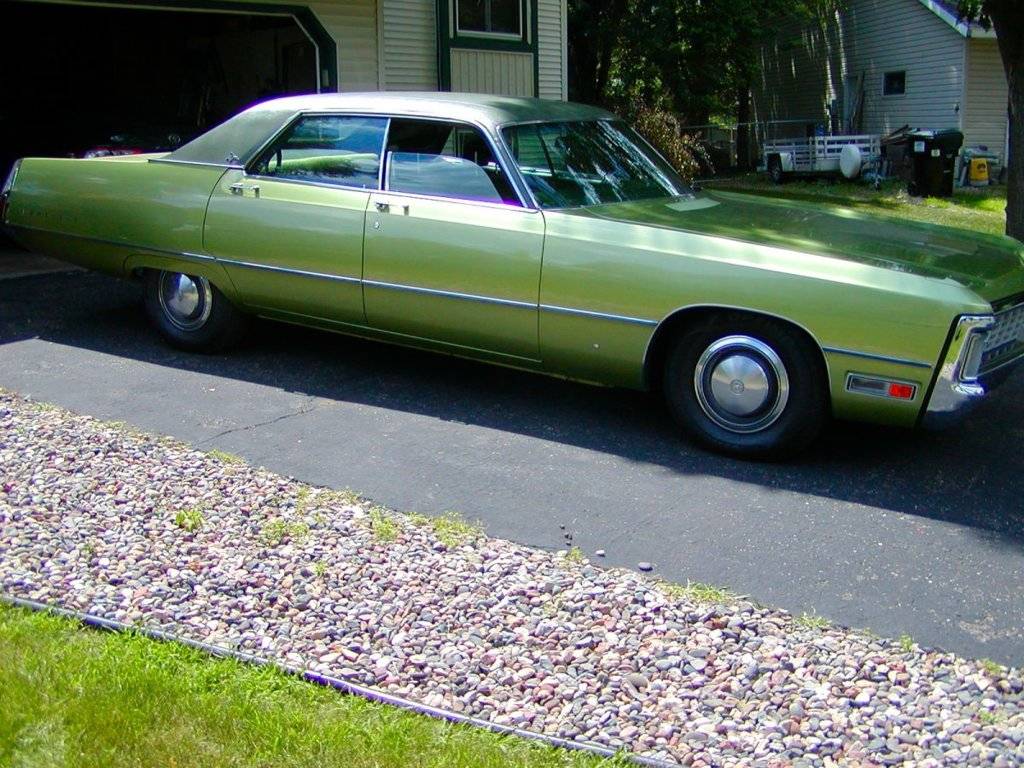

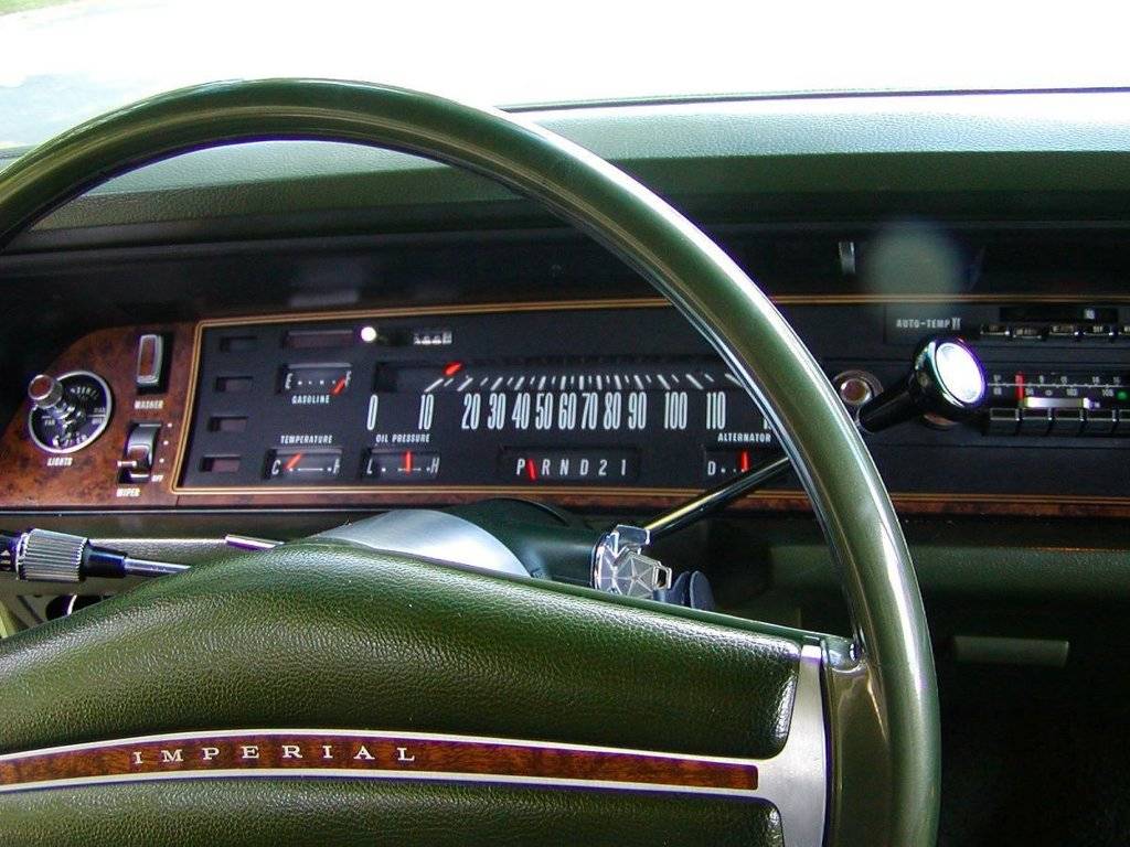

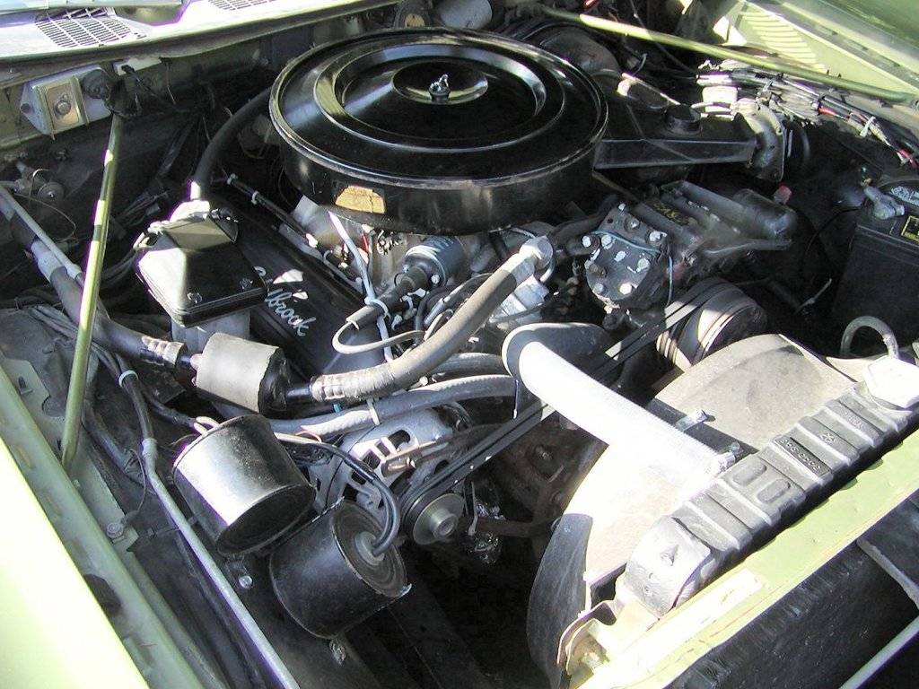

So after saving my pennies and dimes I finally bought a 71 Imp. The price was right and I knew the non-working A/C reflected that but the interior is like new and the paint is a few years old but still looks great.
I want to get the rest back in shape bit-by-bit starting with the A/C but I was wondering how easy it may be. I'm retired and disabled so I need to have a shop do it that restores classics (checked multiple reviews of place in question 4.9 out of 5 rating), I'd rather get it back to original but barring that they said it could be fitted with a complete after-market system for around $7500, does that sound about right to those in the know? The car looks and runs great but I actually paid less then 7k for it. Just wondering. (I used to work on all my own cars (mopars) years ago but can't anymore, age bites in times like this.)

First off $7.5k for after market air sounds very high to me. Second, does the car have standard air or ATC? Standard air is not difficult to work on and parts are still readily available. Unfortunately, most Imperials of that era have ATC which was highly unreliable even when the cars were new. Parts for these systems are often difficult to find and most of the diagnostic equipment used to test the various components and the folks who knew how to work on them are long gone. The RV2 compressor was used on both standard air and ATC and was a very good unit running on R-12. RV2 compressors do not do well running on R-134a and need to be checked often for state of charge so that the compressor does not burn out. There really is no good fix for trying to make an ATC system reliable, you can spend a thousand dollars on it this season and in all likelyhood it will keep needing expensive repairs year after year. If the car has standard air, a conversion to a Sanden rotary compressor would be a good option and will cost a lot less that the quote for after market air that you received. Spending $7.5k to repair the air on a car that cost you $7k makes no sense at all. I would suggest that you do more research on this.

Not that it really matters, but someone has installed an aftermarket manifold and valve covers. The car looks to have been very well cared for and is stunning to look at. You should check the compressor to see if it will still turn over. Put a socket on the bolt at the center of the clutch assembly and try to rotate the compressor to turn over two full rotations. If it will turn, the compressor has probably not seized. The A/C system does not appear to have been converted to R-134a yet as it lacks the updated service fittings.

You already have an upgraded Performance Analysis Company remanufacturered controller under hood, so the major cost is taken care of in fixing the system generally. The ATC II system is not "dreaded" by me at least, and Performance Analysis Company is very helpful if your technician runs into issues. Any a/c specialist should be able to get the system running well, and could call the PAC company up for advice if issues arise. The most usual part that fails is the vacuum check valves, as if one of them fails, the system will not even turn on. But they are accessible and easy to replace. The other component that might fail is the amplifier, which is also available at a fairly low price and easily replaced too.

Your system looks complete, is there any refrigerant still inside? If so you should consider an underhood conversion to modern compressor and condenser rather than a complete aftermarket conversion. I just completed such a conversion on my 66 Monaco wagon with dual a/c, it cost me $975.00 and I did the work myself. I can't say anything about ATCII but I wouldn't replace a whole system unless a bunch of parts are missing. Take a look at my thread - good luck.

-- Put a socket on the bolt at the center of the clutch assembly and try to rotate the compressor etc - The compressor turns free as far as I can tell, I was able to spin the outer ring (clutch?) with no problem and the compressor itself spins free and the (fan) belts are still all in place. It is still the old R12 unit so it hasn't been upgraded, also, no hardened seats either so I need to use a Lead additive when filling up.

If your compressor still turns over, it can still be repaired. The leak at the front of the compressor is probably caused by the system being low on gas. The front seal uses refrigerant oil and gas pressure to make the seal. If the rest of the system appears to function, you probably could get away with replacing the front seal and filter dryer to attempt a recharge with R-12. Trick is trying to find somebody with a supply of R-12 who is no yet retired, the system would need to be topped of with fresh refrigerant oil. Failing that, the Sanden conversion is probably the next best option.

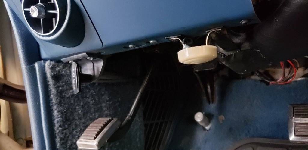

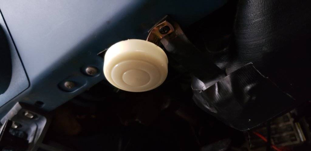

In relation to the horn, it's probably a rim-blow horn which has long since expired.
Doc can send you a photo of what was done to Lee, his white one, formerly mine, but basically a white button was installed to the left of the steering wheel which you bump (lift knee up);with your knee and it works. Sounds like you got lucky with a pretty solid car.
Great news about the ATC! Sounds like you need only to get the compressor repaired, and you are back in business!
There are many posts and opinions about retaining the RV2 or replacing it with a Sanden. FWIW- My 77 Cordoba has been running with R-134 since 1999 in its 1988 Mopar reman RV2 compressor. I had to replace the shaft seal in 2008, but no problems otherwise. My 71 NYer is still running the RV2 compressor it left the factory with. I replaced the shaft seal in 2003, and converted to R-134 at that time. No problems since.
If you determine that your Rimblow horn switch is faulty, a replacement is available-
1960-1976 All Makes All Models Parts | MD8034 | 1960-76 Mopar - Rim Blow Steering Wheel Switch | Classic Industries
I have one in stock for my car, but haven't gotten around to installing it yet. (I hid two small pushbuttons under the vinyl in the horn pad as a "temporary" :rolleyes: fix back in 2002 when I first bought the car).
