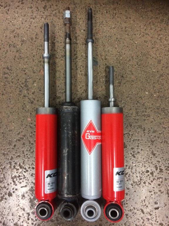

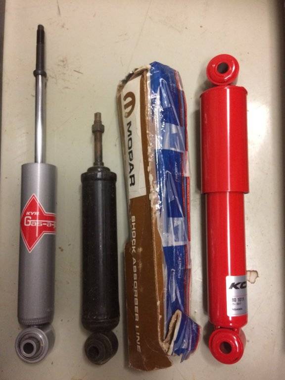

    There are other options, as I'm sure you know.
    Left from right: KYB, NOS Oriflow, and KONI 80-1011 before modification.
    Left from right: modified KONI, Oriflow, KYB and another modified Koni.
    The KONI's will be going to my '70 NYer.
