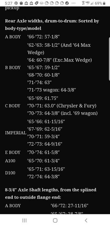

FIRST, check the rear track width of the B-body item you perceive you want to use. Not many B-body rear axles have the width to be under a C-body, unless it might be the '68 and prior C-body models.
Seems like the '71+ B-body wagons had a approx 63" rear track, but station wagons ONLY? Which allowed the wheel tubs to be wide enough to allow a 4x8" plywood panel to be put in the cargo/load floor area.
Spring saddle width will be different, too, even if the track width is similar.

Direct Connection printed a chassis book that gave you all the dimensions for all the different rear axles. You could probably find a copy on ebay.

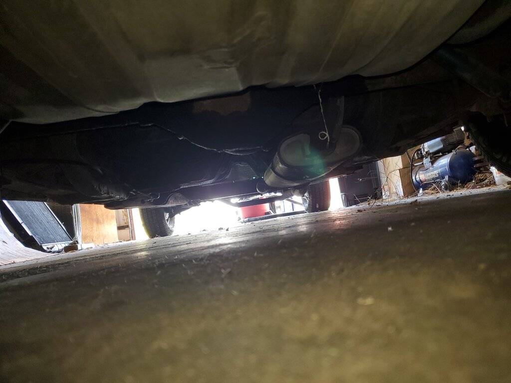

I just had a thought, your car is a factory big block 72 fury isn't it? Could you take a pic of rear of the diff to show us? I cannot believe it has an 8 1/4 in it.
This got me thinking. Don't know where this site got the data but it is nicely laid out.
Mopar Rear Axle Dimensions – BigBlockMopar
Its definitely an 8.25 and its a factory 400 gran fury
