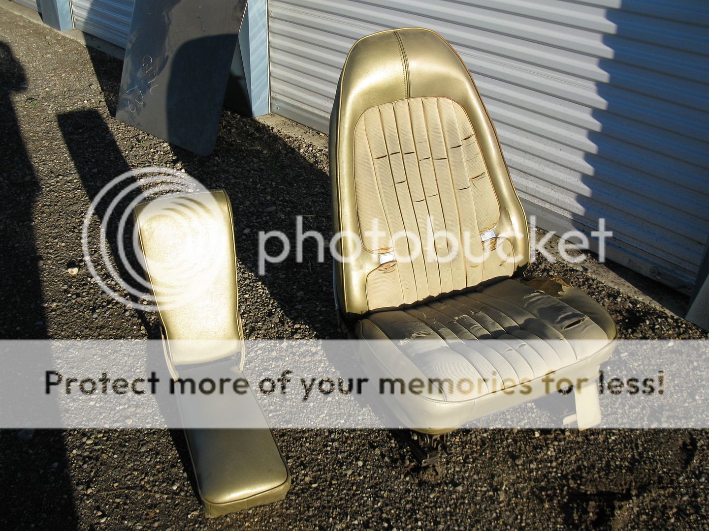

pulled seats out in the sun and after 40 years the gold still pops..can just imagine them when thier redone

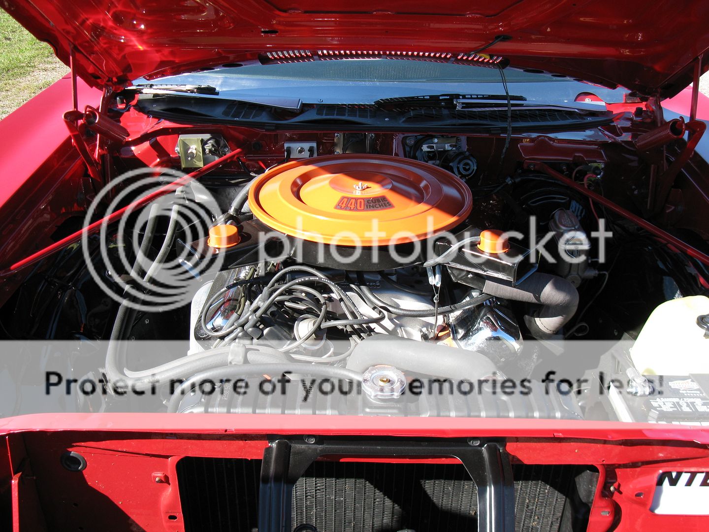

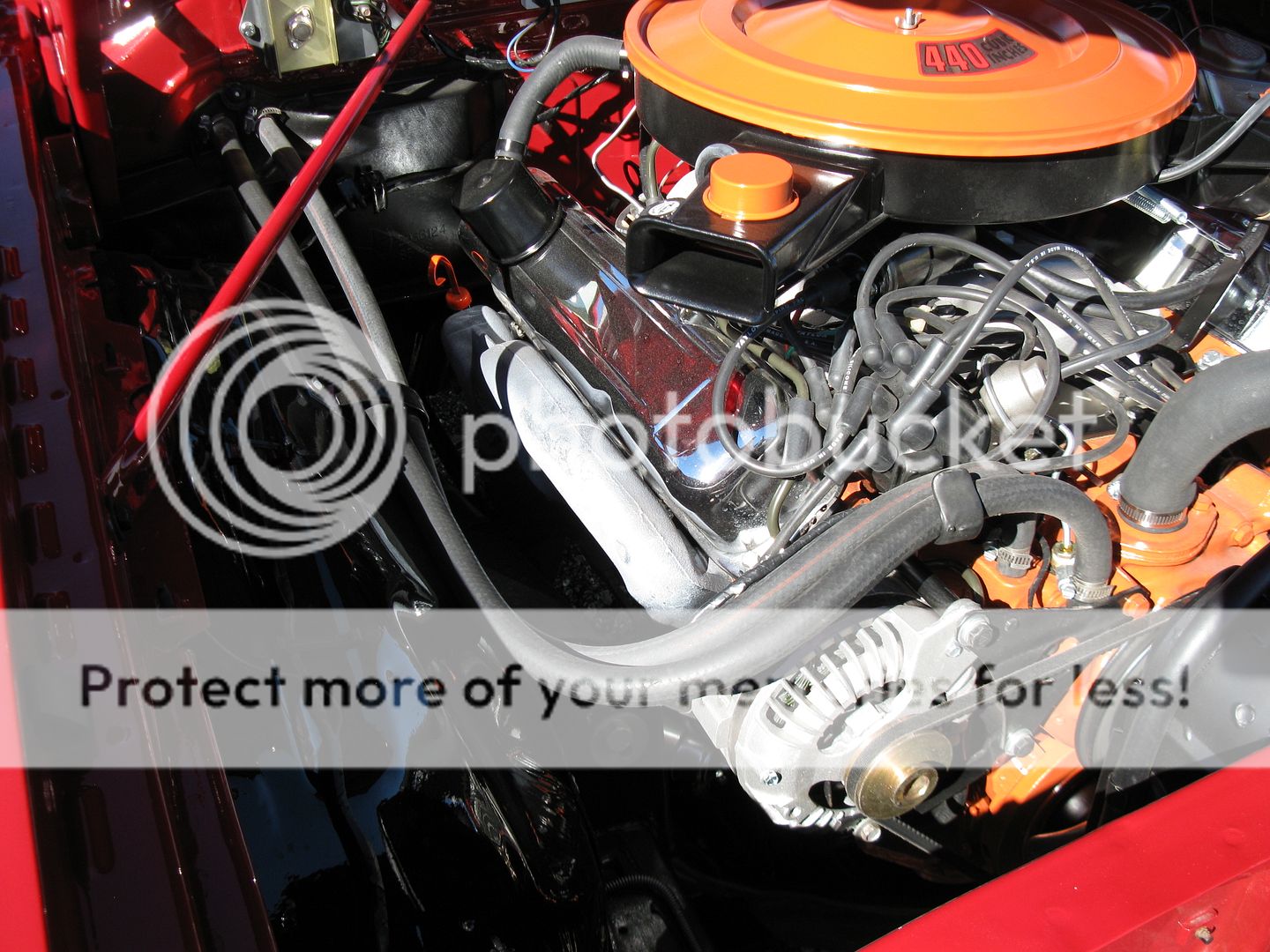

Pete from Carstairs stopped by as well as Bill ..he was kind enough to stop by today with his second love and help me sort though all the parts that were with the car..of course l couldnt send him on his way without a couple goodies hehe
managed to get a few pics of Bills honey..pics are good but dont do the car justice..thanx kindly for the help fellas

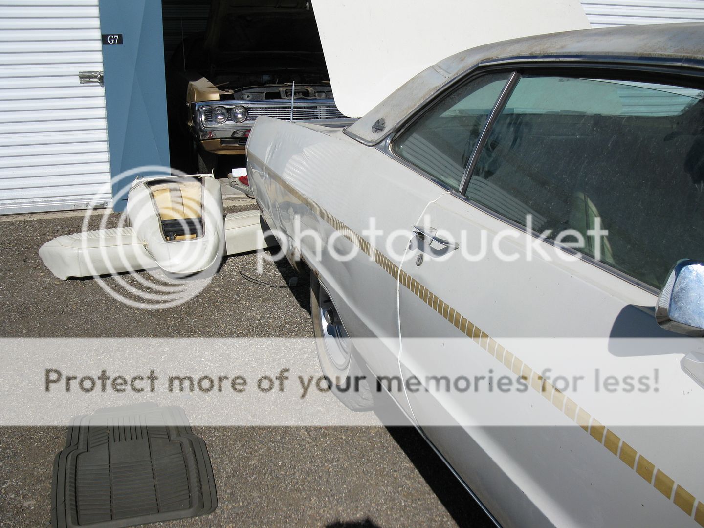

took the white seats out to replace the orrignall in car for the trip and managed to find a perk for my center seat and a couple replacement pieces l need for my build...srry Marco..need a coule pieces..made arangements at storage and Nick should pick them up for you this week

I wish I had been there when Bill came. I would like to have seen the finished product. Based on what I have seen of Paul's work, that GT will be a stunner.

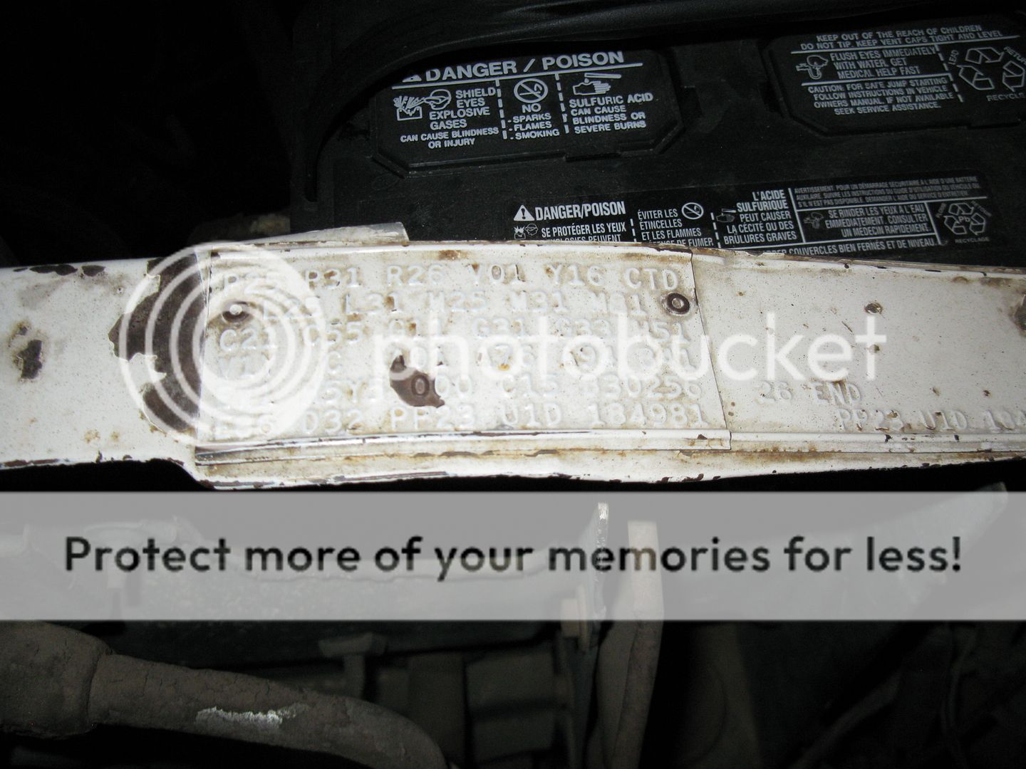

2 tag car
p25
p31
r26
v01
y16
ctd
L25
L31
m25
m31
m81
c21
c55
g11
g31
g33
h51
v1y
c
a01
a76
a94
b41
ew1
h5y5
000
c15
830256
e86
d32
pp23
vid

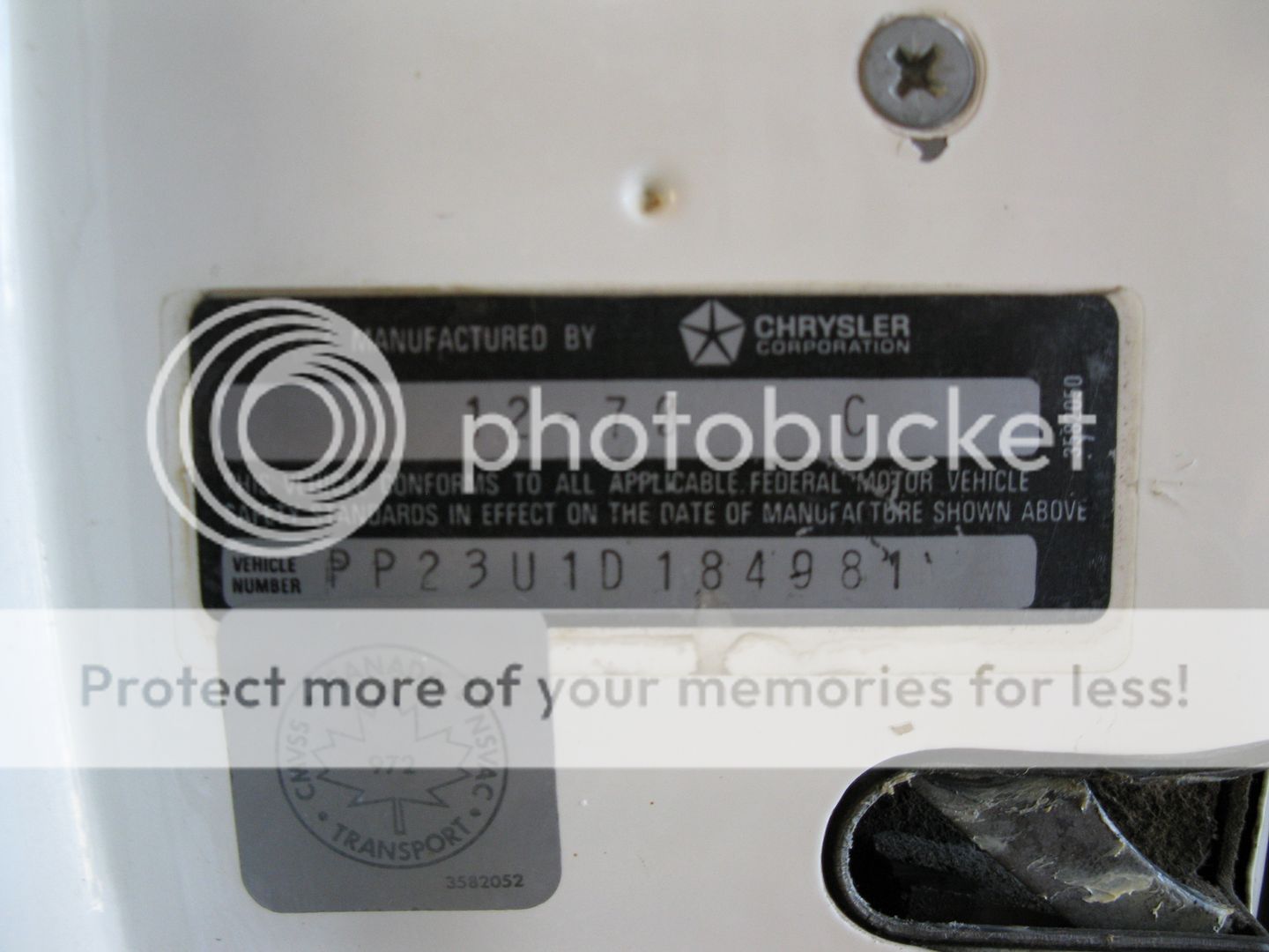

184981
PP23:
Plymouth Fury
Premium
2 Door Hardtop
u1D: 440 385HP 4 bbl 8 CYL
1971
Belvidere, IL, USA
184981: Sequence number
E86: 440 cid 4 barrel V8 (High Performance) 375hp
D32: Heavy Duty Automatic Transmission
EW1: White Exterior Color
H5Y5: Trim - High, Cloth/Vinyl Bucket Seats, Unknown Color
000: Full Door Panels
C15: Build Date: December 15
830256: Order number
V1Y: Full Vinyl Top, Gold
C: Canada Specifications
A01: Light Package
A76: brougham package
A94: light reminder
B41: Front Disc Brakes w/Standard 10in RR Drum
C21: Center Front Seat Cushion
C55: Bucket Seats
g11: tinted glass all
G31: OS RH Manual Standard Mirror
G33: LH Remote Racing Mirror
H51: Air Conditioning with Heater
L25: Trunk Lamp
L31: Hood/Fender Mounted Turn Signals
M25: Wide sill moldings
M31: Belt Moldings
M81: Front Bumper Guards
P25: Power Left Front Seat
P31: Power Windows
R26: AM Radio with Cassette
V01: Mono Tone Paint Treatment
Y16: Sales Bank.........................................sales bank??????????
CTD: Codes Continued on 2nd Fender Tag...second tag????...second tag 26 -26 in rad
