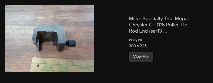

Yea John the double hammer trick is a skill that takes time to acquire, me thinks (without digging through the FSM's) he would be better off searching out the proper tool.
I've used two hammers by placing one on the object to be smacked and then the other strikes it. A friend showed me that trick for some AC fitting "nuts" that were frozen in place. Worked great for that... and I seem to remember trying it (with success) on a stubborn tie rod.
Hitting two hammers at once? I'm not coordinated enough.... I'd hit myself in the face with one or something like that. I got enough scars and replacing missing teeth isn't cheap (scheduled for a replacement eye tooth next week!) so I don't see myself trying that.
Never seen the factory pullers in real life. I think somebody was making them in small quantities for the Mopar market though. Those would be the more expensive alternative although if done right, you can probably keep the seal intact. IIRC, the idea was to pre-load the tie rod end (or ball joint) with one of these pullers and then smack the tie rod with a hammer for the same result. There may be a universal type puller that your nearest Advanced Auto Zone will rent, but I never looked into it.
