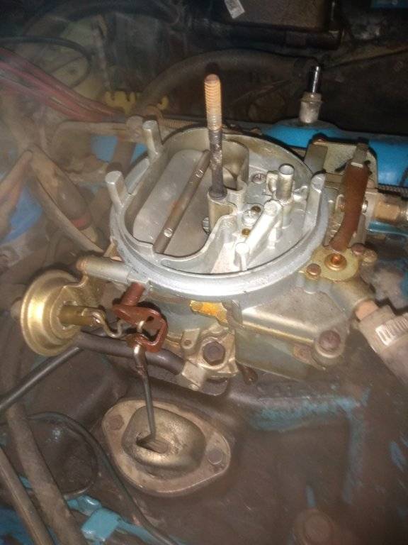

When I give it throttle, it hesitates and almost shuts off...I figure that to be the accelerator pump. I sprayed the carb with cleaner and then PB blaster. Tired to adjust the mixture screws..the driver side turned til it sputtered and then backed it off...the passenger side went all the way in before it had an effect so I backed it off a couple turns.. I'm thinking a soak and a rebuild kit. The carb on there now is a reman. The original was in the trunk. I am thinking to rebuild the original (practice?) so I don't mess up what does work so far because I have to keep this car able to move itself.

Any tips on adjusting the carb before I resort to rebuild? I am going to just take it apart (pics of everything along the way), soak it and blow it out and re-assemble.

Holley 2210. There might be a new product MasterTech video in somebody's archives for the "New for 1972" vehicles. The Holley 2210 was first used in 1970 on 383 2bbls. For what MyMopar.com doesn't have, ImperialClub.com might have, in the way of MasterTech videos. Be sure to use a thick, OEM-style carb base gasket, rather than the thin one that usually comes in the carb kits. They just work better, period.

Get the proper rebuild kit, make sure it comes with a float. Also get a new choke thermostat and choke pull off diaphragm. After all those years the rubber in the pull off will be shot. That carb sure cleaned up nice. Aerosol carb cleaner is the way to go. Good luck and keep us posted.

I suspect that any choke thermostat you might find will be universal and still need to be adjusted for your application. My experiences have been that as the orig coil will tighten with age and use, you can adjust it 1 notch leaner to compensate for that. Choke pull-off can be variable, your judgment call.
As noted, it's not a hard carb to kit. Do pay attention to the imprint on the air horn gasket at the rear of the float bowl. Make sure there's an imprint there and no evidence of it not sealing well. THEN, only tighten the air cleaner wing nut just enough to ensure a good seal between the air filter element and the air cleaner top. ONLY that much, not more! No "two turns more for good measure"!
