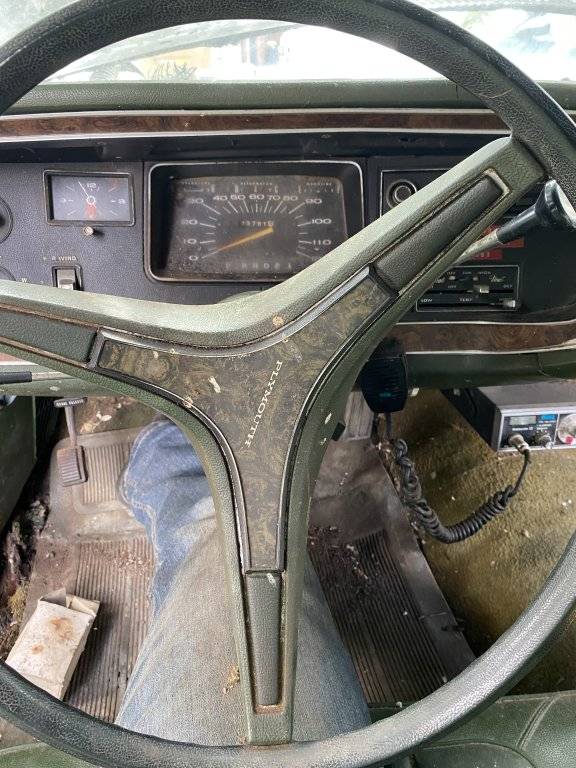

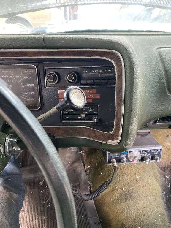

Is that a CB Radio?

Yes, has a 70’s CB radio; I will likely pull that out.

I would be interested in the CB radio if you are getting rid of it, I suspect my car had one installed at some point.

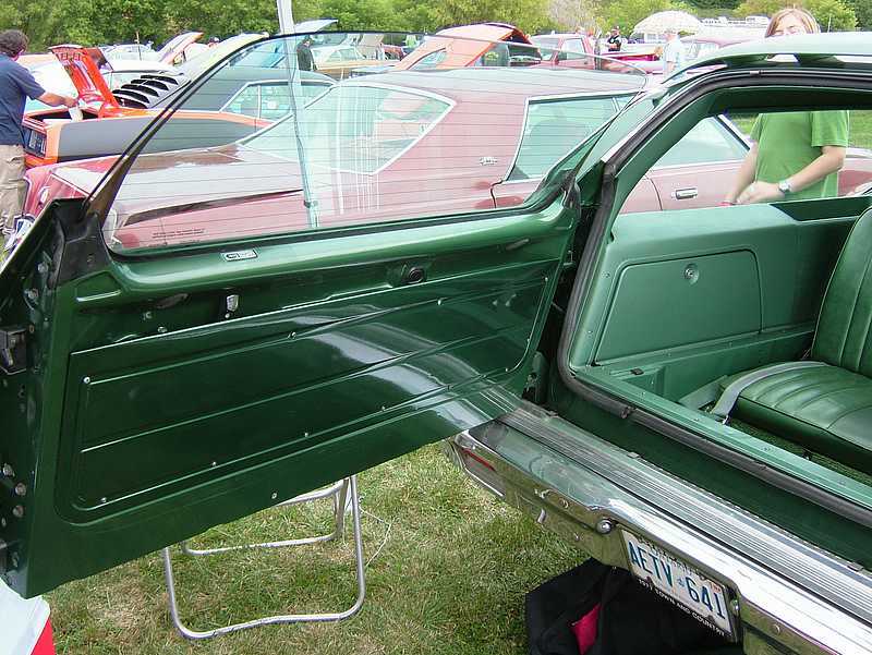

There should be a plunger on the tailgate like the other doors to lock the car. It should be next to the door-gate swing latch. Make sure it isn't locked.
You can see the plunger to the left of the door gate latch ...mines a 77, but it should be the same.

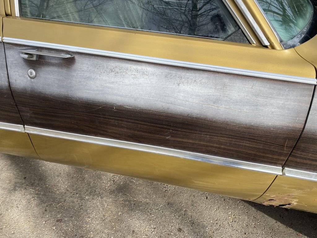

So the woodgrain decals down the sides are the originals, and the top half of the decals are chalky and whitish. I was surprised when wiping down the body panels with soapy water that when wet the chalky appearance disappeared and the decals looked 1000 times better; but then when they dried again they went back to looking chalky.
Is there a way to “condition” the chalky part of these decals so that they stay looking like they should, or will I have to eventually replace the decals to get them to look good?

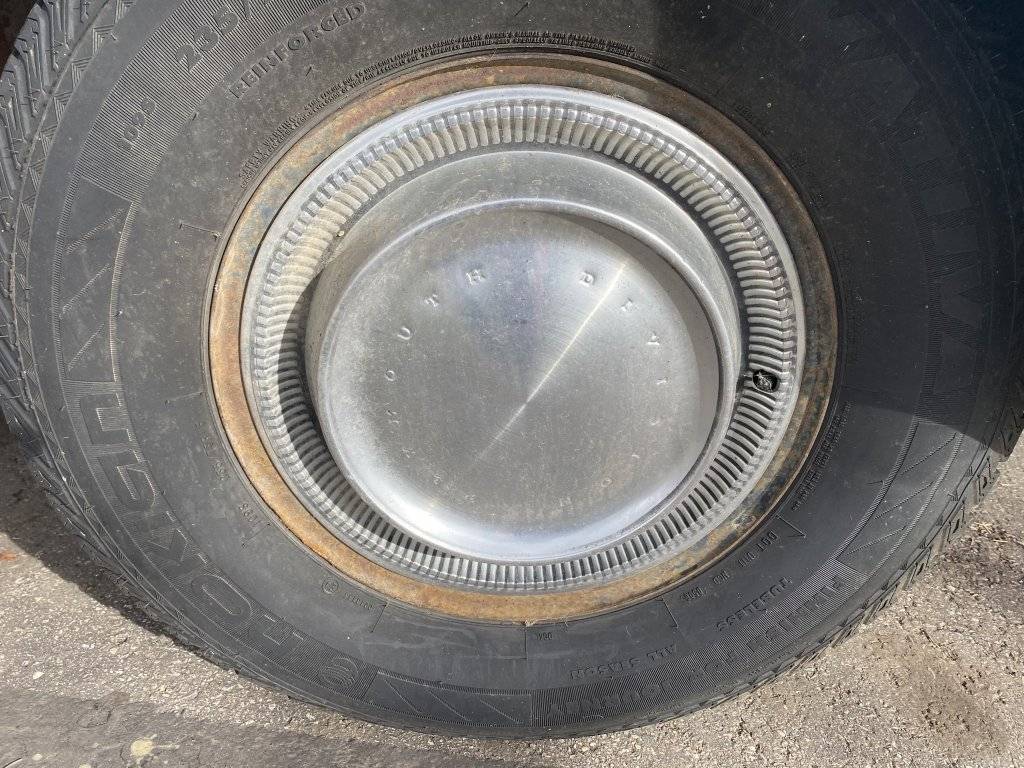

And secondly, the wagon has full Plymouth wheel covers on it; I just wanted to co firm that these would have been the factory correct wheel covers in 1972?

(Frankly I really like the faded patina of the wood grain. That’s just me.)

3M makes a rubber wheel specifically to remove the vinyl wrap material. Any paint shop should have one. A lot of elbow grease, you use an electric drill. Wear safety glasses (and hearing protection?). I think I went through two or three of the wheels, removing my wood grain. It was very VERY baked on. Yours should come off easier. But… I like it just as it is! I wonder if you put some spray on furniture polish like Pledge on it, if it would brighten/clean up any(?).
It’s a lot of work getting the old vinyl wood grain off. Be patient. Especially when messing around with body side trim. Dislike that stuff.

Experiment on those wood decals. Try using hair conditioner - make sure it’s with lanolin. That might brighten them a bit, for a short period. Mechanics hand cleaner with lanolin might work too. Liquid car wax or polish might help too, if the lanolin doesn’t work? Glycerin? Think moisturizer, like skin! Just experiment in an inconspicuous area, as they say…

I’ll post some more pics. The passenger side woodgrain looks pretty saveable (pic above) but the drivers side is 50% gone in most places right down to the paint.

A used car lot trick in the old days to brighten up woodgrain was to soak a rag in used trans fluid or oil a "bingo" woodgrain looks great for weeks (unless it rains, then just repeat).
They also sell products to rejuvenate the black plastic on newer cars...same idea.

Oh. and the wheel covers are original.
