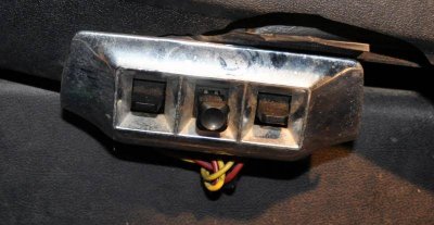

Found an NOS switch for $480...... :huh:
(1) What other year switches will work?
(2) Is this Imperial specific or will other C-body switches work?
(3) Any crossover to B-body switches or is this C-body only?
Any information will be appreciated if anyone has any experiences or knowledge to share regarding these switches.
Thanks!
I'll go out on a limb and presume you found that on e-bay and sold by Frank Mitchell or you located it on Collectors auto supply, thats a bunch of money
Failing to find a suitable replacement, you can buy Dorman (Help!) GM switches that you can use to repair your switch bank. Not a plug n play but it can be done.
Or pay $480.00.

Can you elaborate?
Damn you. Now I have to recall some fried brain cells put into storage. Lol.
Years ago, a friend had a 70's-sumthin Chrysler with a bad driver's side switch bank. He was cheap so he asked me to give it a shot. At AutoZone or one of those places that had a humongous Help! display, I looked at the switch section and couldn't find any Mopar switches (of course) but I noticed that the GM toggles were identical. I'm guessing same supplier? Anyway, I could disect the GM switch assemblies of their switches and use them in the Chrysler switch assemblies. Perfect fit. The only problem was you had to do some real small desoldering and resoldering. Please don't ask me to recall which GM switches specifically. I just picked out ones by visual similarities.

It's coming back to me..........
I used the 2-way toggle from a Dorman 49225 or the 49269 window switch for the forward/aft and tilt switches.
I could not find what I used for the 4-way toggle.
A further note, an AutoZone, et al, seat switch for a Jeep might be able to replace the guts entirely..
