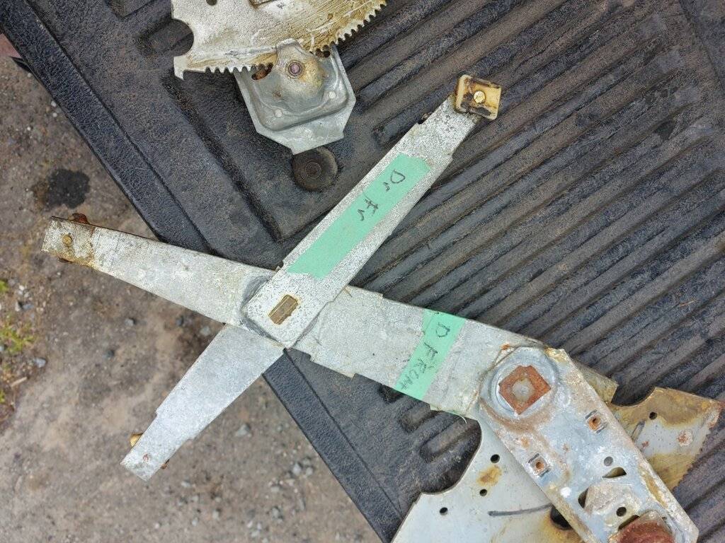

My driver side window has broken rollers. I need those parts and also a serviceable door panel (blue preferred). I can also use the dash switch for the electric tailgate. And the interior panels for the cargo area.

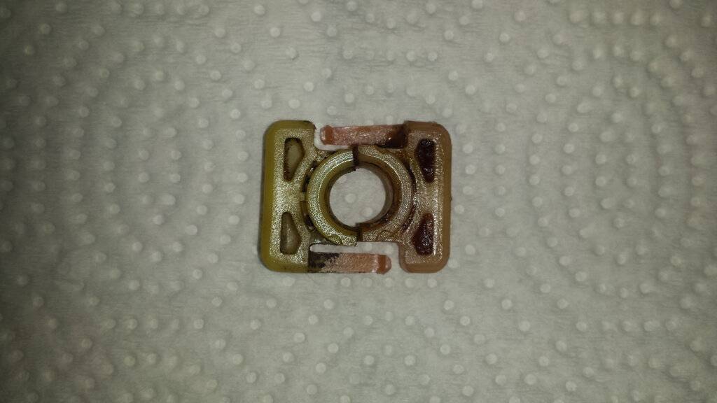

what do you mean by rollers ? my 71 fury custom suburban had a similar issues but the broken parts were slides.

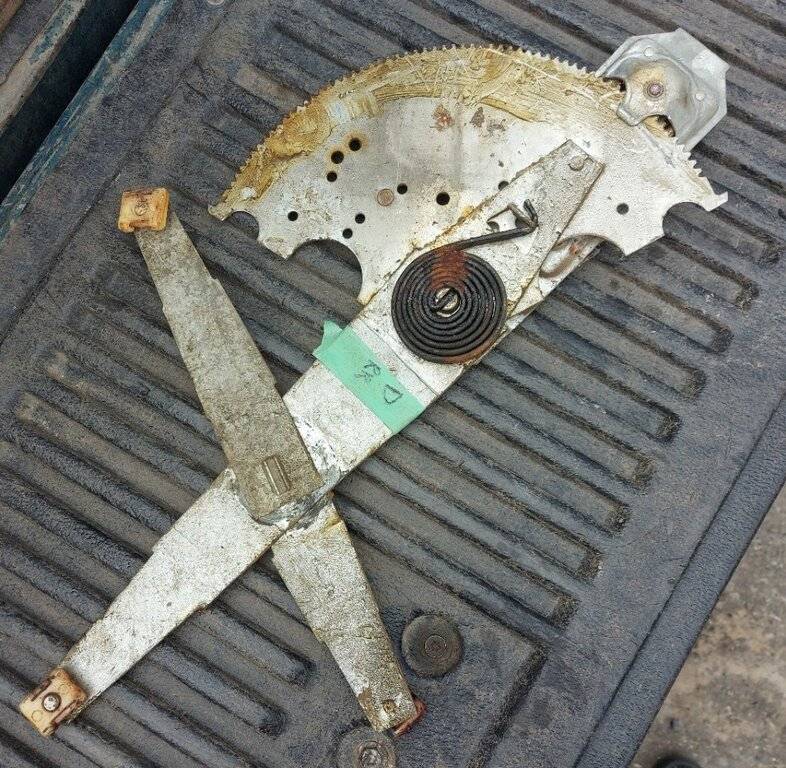

Yes...I'm not with the wagon right now but I do recall the sliders were square. I looked up that part from your picture and I'm very grateful to have found them... Thank you how many per door? I would want to do all four doors
there are 3 per regulator 2 on the front and 1 on the back so 12 for 4 doors
the reason mine broke were because it was very hard to get the windows to wind down, and trying to force them broke the sliders. after lubing everything and still having them stick, i discovered that the problem was with the tracks the glass slides down - as the windows went down they were being squeezed by the soft track liner.
with the window all the way up ( obviously with door panel off) pull the track liner out of the track at the bottom - not all the way up, just part way up. the metal tracks were getting corroded part way up and were full of crap which was squeezing the liner tight which was stopping the glass going down. clean the crap out, i used a screwdriver, and then push the track liners back in place and you should be good. i just replaced the regulators with some from a wagon in a junkyard and havent got around to actually replacing the sliders. hope this helps
