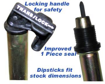

I tried the correct o-ring, in my case it did not work. The locking dipstick with its gromet style seal worked.

The locking dipstick was a GM fix for ATF eruption from the dipstick tube under heavy towing conditions in pickup trucks, in the later 1980s. That "boot seal" on the tube is what GM replaced the earlier o-ring seal with, too, in the later '70s.
I bought that dipstick and gasket from A &A transmission.
Ive found that if the dipstick tube does not fit properly into the trans it will leak regardless of O ring.
I used the shoulder type of seal shown in the picture Mev posted. My trans was drained and I used some RV sealant and let it set up a day....No more leaks
