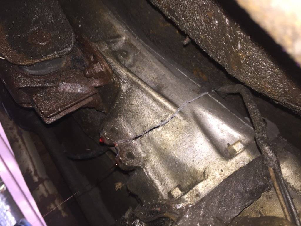

So 2 years ago, my transmission let go and I kept putting off fixing it until now. I poured some ATF in to pinpoint the problem area and came across a cracked extension housing. My question is: it's a 1974 Monaco with a 440, what length of extension housing and output shaft do I need, and what parts/pieces should I order to go with replacing the housing? Bearings, seals etc..
Well that's not good...:( I would pull the tranny and tear it down, could be way more internally wrong then just a cracked tail housing.....they just don't crack for no reason. You weren't doing dukes of hazard jumps when this happened were you??? :wideyed:
It the output shaft needs replacing, you will have to pull the whole tranny anyway, so my thinking is you need to pull it first, tear the whole thing down and inspect it for any other damage internally. I know you didn't want to hear that, but it is the best route to go.
Your output shaft and planetary gears might also be damaged, the output shaft should be checked for run out as it may have been stressed enough to bend it. This type of catastrophic failure has a root cause someplace. As noted, check all the internals of the transmission. A broken motor mount will also sometimes stress the tail shaft enough to break it, so check the mounts as well. You should also consider a full rebuild of the transmission. You can reference the serial number on the transmission to order the correct parts. If the internals have been seriously damaged, you may want to consider finding another transmission as that would be cheaper to rebuild/repair.
Dave
727s are plentiful....it will be easier to go with a fresh plug and play unit + new TC. Change the u-joints while you're at it....
Thanks for the input everyone! I wasn't expecting any "good news" but I agree with all comments, perhaps just replacing the entire trans with a new one is the cheapest/best option. I'll also check my engine mounts as mentioned. Has anyone ever done polyurethane engine mounts? Wouldn't mind going that route if it's suggested
