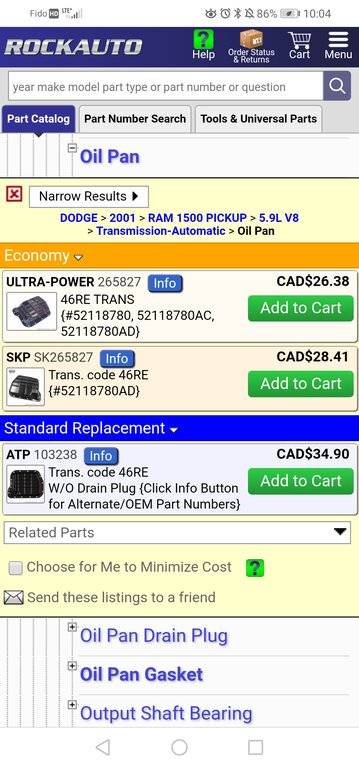

Buy a replacement 94-01 Ram, they're cheap and 1" deeper....

I see some deeper pans you have to use a Filter spacer
You do not have to, although IMO they are a good idea. But you do definately need to account for the extra depth with extra fluid. Simple as following the factory dipstick marks, as per usual.
