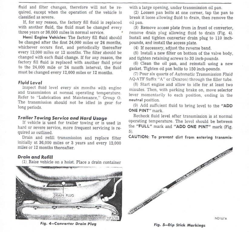

1970 FSM also recs 6 quarts and that's with draining the torque converter as well as the pan.

Hi David,
I published the drain/refill directions from the 1970 FSM, which say 6 quarts as initial fill with trans already in service. See step 7 in FSM instructions from my previous post. Then follow steps 8 & 9 to top off as needed after warming up the car with engine running in neutral.

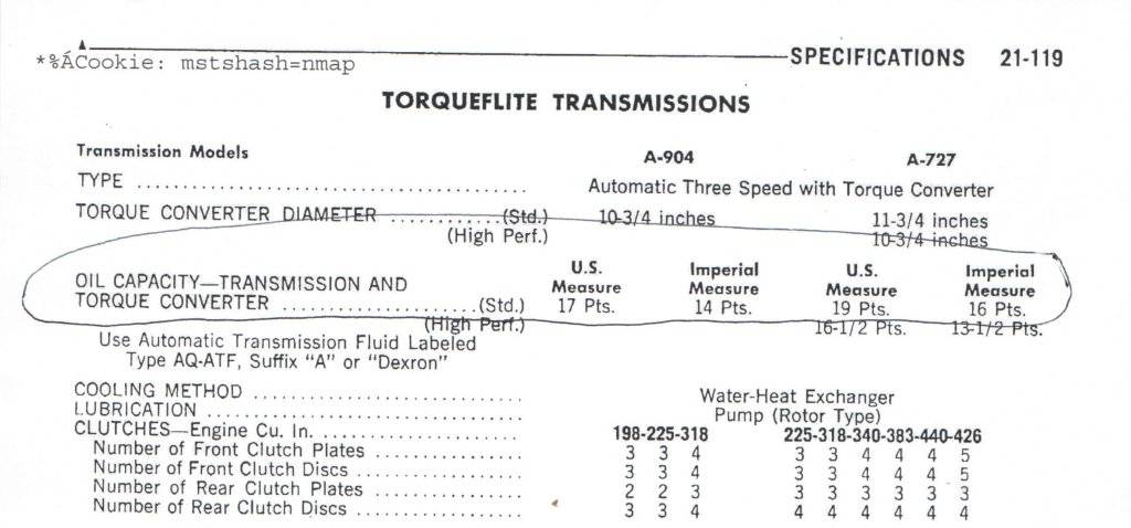

Below is the 1970 total dry (not in service) capacity spec for standard 727 trans: 19 pints=9.5 quarts.
Overfill damages transmissions.
Provided the OP has standard pan, I stand in agreement with @Big_John on 6 quarts max add with filter change on a transmission that is already in service.
Perhaps you are thinking of a deep pan aftermarket set up? Ben
