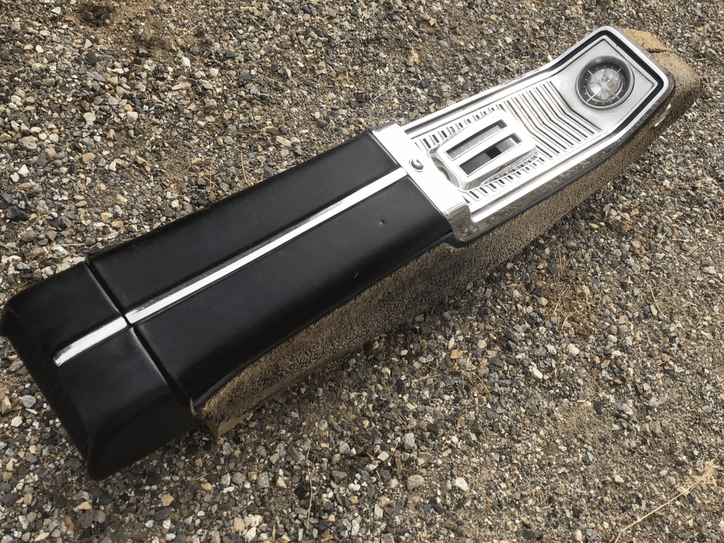

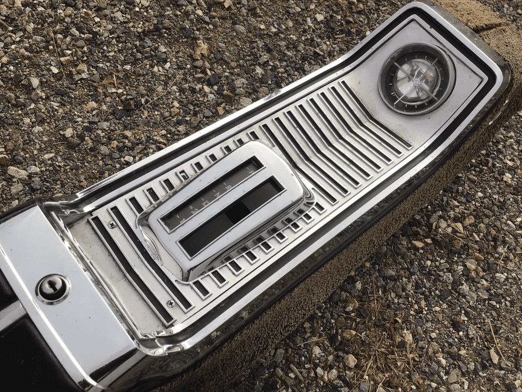

1966 had a different console and shifter than a 65, doesn’t look the same at all.
Consoles are 66-70 on the design department, with minor changes.
Here is a 64 console, 65 same but different front lights.
