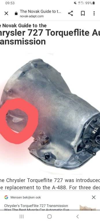

65 was first year for slip yoke and last year for cable shift.
66 and newer 727 have a different number of splines on the input shaft.
This broadens your choices of torque convertors and less expensive vs 65 and older 727's.
The 67 trans you have needs mechanical shift rods.
If you want to use the 67 trans you need to swap out the 65 steering column for a 66 column and all related shift linkages.
Or if console shifted, 66 and newer console and related shifter hardware.

67 and newer is the breakdown on input shaft splines, not 66. 66 is technically a 1-year trans also, but that doesn't get the fanfare that a 65 does.

1964 and earlier TFs were cable controlled, but used pushbuttons on the instrument panel to select the gears. 1965 was the first US Federal mandate that all makers used a "common shifter and shift quadrant" orientation on their vehicles. Which meant the end of Chrysler's famous (post 1955) "pushbuttron drive"on non-floor shift TF-equipped vehicles, Ford's Cruise-O-Matic "D1 and D2", AND the end of GM's shift quadrant which had "R" next to "L". This shift quardrant conformity had been identified as necessary to prevent traffic accidents should somebody get into a strange vehicle and not knowing which gear was where could cause problems.
Chrysler's using a more simple cable rather than the later hard linkage in '65 was a transition into the legislated set-up. So, "one year only". As the internals had incremental changes.

Also the last year for the rear pump, which meant you could push start the car.

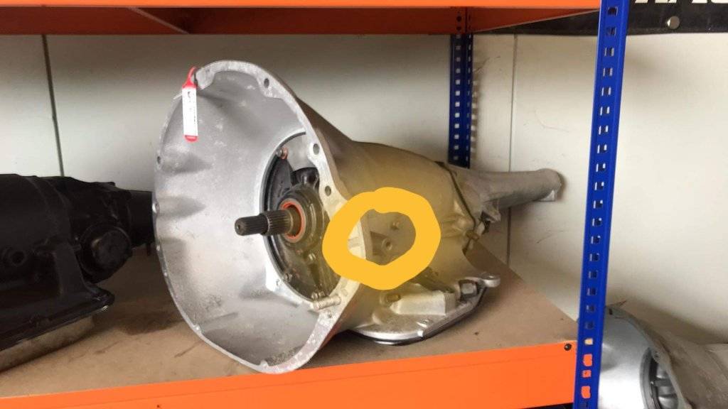

Hi Guys,
I have a 65 NYer and I need to replace the transmission. Since it is hard to get parts here in The Netherlands I only have the choice of 1 transmission that is for sale.
In my car there was originally a 413 but since i bought it what an stuck engine i replaced it with a 1967 440.
That transmission has a sort of knob on the side while other transmissions have an ear on that same spot.
Can somebody tell me what the difference is?

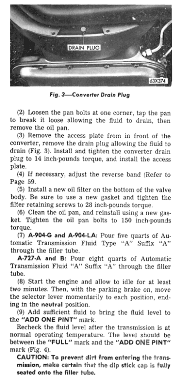

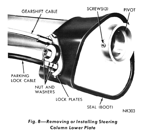

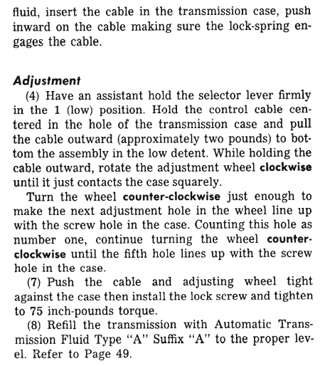

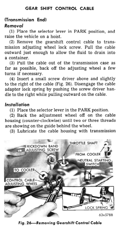

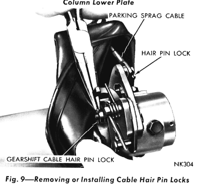

With the cable shift transmissions you have two cables, one for shifting from neutral, drive, 2nd & 1st and one cable for park. the shift cable could be broken or unhooked inside the trans but your park cable could be working fine. So the car shifts out of park but isn't shifting to any gears.
First thing is make sure the fluid is correct level. Then check the shift cable. All the pics below are from the 65 service manual.
Because the shift cable is attached inside the transmission at one end and the steering column at the other sometimes it is bard to tell is the shift cable is moving anything. If you move the shift lever from 1st to 2nd to drive does it feel really loose or does it feel like it is moving something?
This pic shows cable attached at the steering column and at the transmission. Lok at the adjustment section below to see how to verify the cable is connected, moving correctly and adjusted.
View attachment 548081 View attachment 548082
View attachment 548083View attachment 548084
Thanks for the upload of the 65 manual. I will have a look at the linkage and the oil level.
Put the rear axle on jack stands. Start the engine with it full of fluid and observe the rear drive shaft as you go through the gears. If it does not turn it's something in the linkage or transmission itself. If it does turnand the wheels do nothing it's likely the differential. A differential so bad it doesn't turn the wheels is not that likely. Looking at these service manual photos it's probably the cable not connected correctly. My money is on that.
