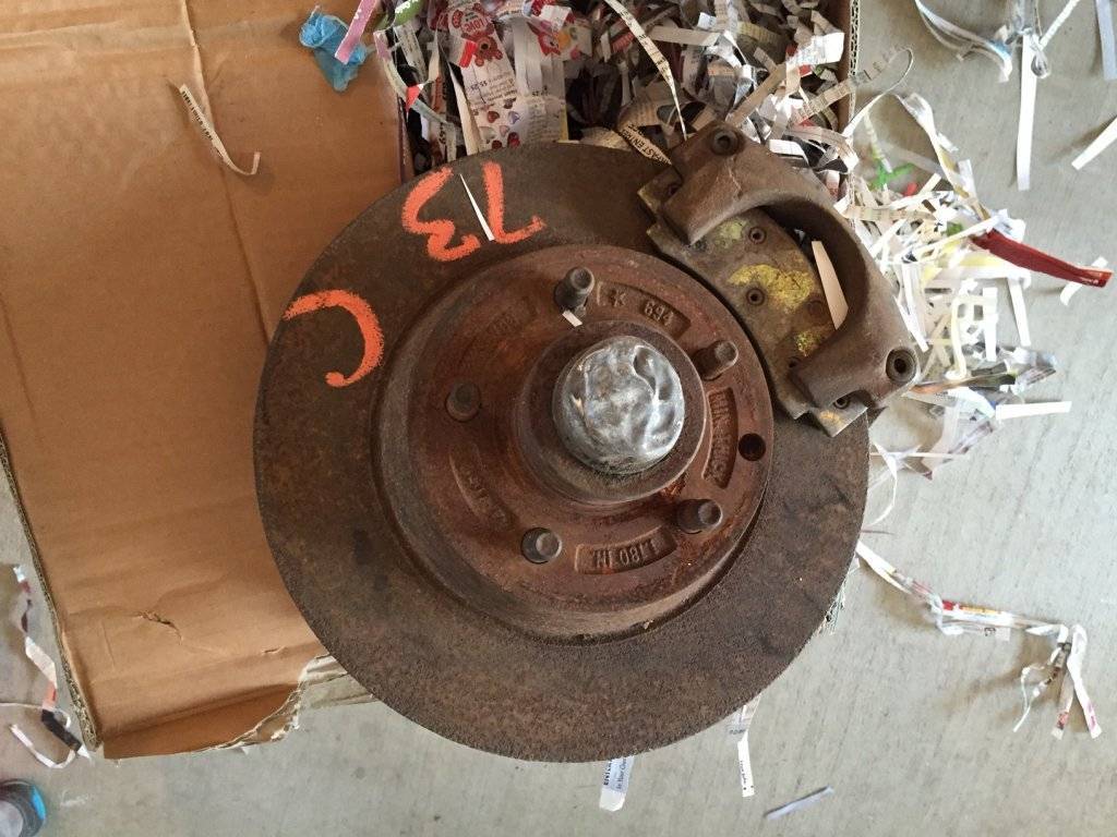

well I got my 73 setup and I lucked out. the master cylinder looks to have been rebuilt,the ball joints are newer and tight and hardly any rust the bolts all came loose very easy. they came from Texas .rotors and calipers were junk though. looked like the car hadn't been sitting in the junkyard very long as everything was loose and the rotors spun freely. just waiting on bearings and seals and hoses from RockAuto. picked up the rotors and calipers and pads today from auto zone.

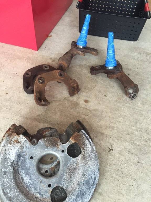

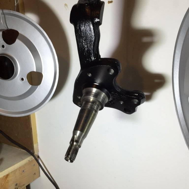

I am actually doing the same conversion on my 1969 Chrysler 300. I picked up a set of 73 spindles and breaks from Murray b. Park a few months back and am installing them this month while I rebuild the complete front end. Here are some picks after I blasted and painted them.
Good Job!
Yes biggest pain was that some of the spindle bolts got stripped upon removal and I had to source some new ones at a machine shop and have cotter key holes drilled.
