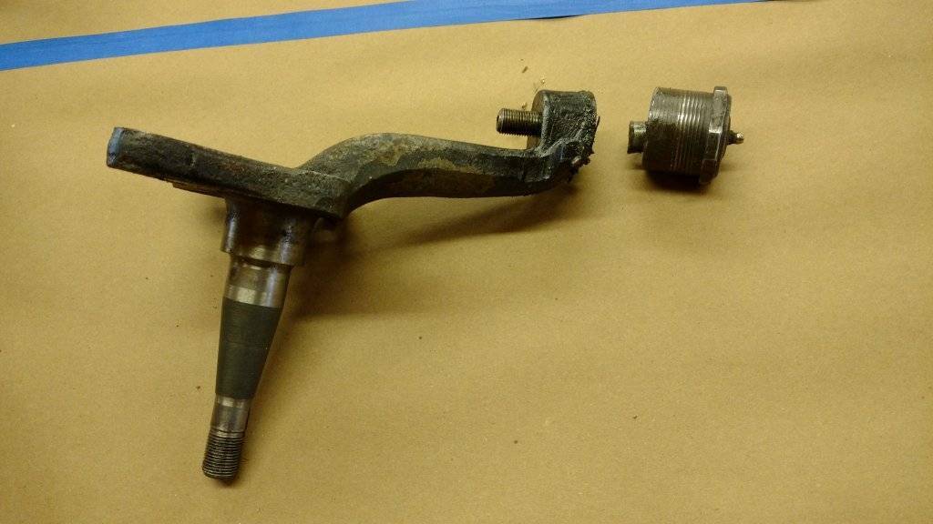

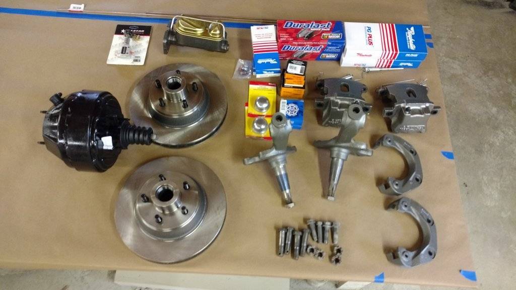

I started my conversion last weekend and accumulated all my parts. The upper ball joints, which are only 4 years old, would not separate from the spindles so I just cut them off. I had smooth sailing after that.
I have the left side completed, right side is nearly finished too. Very satisfying day.

I must really thank Steven SF-66TC for the excellent write up and the list of parts. It surely is making the process easier.

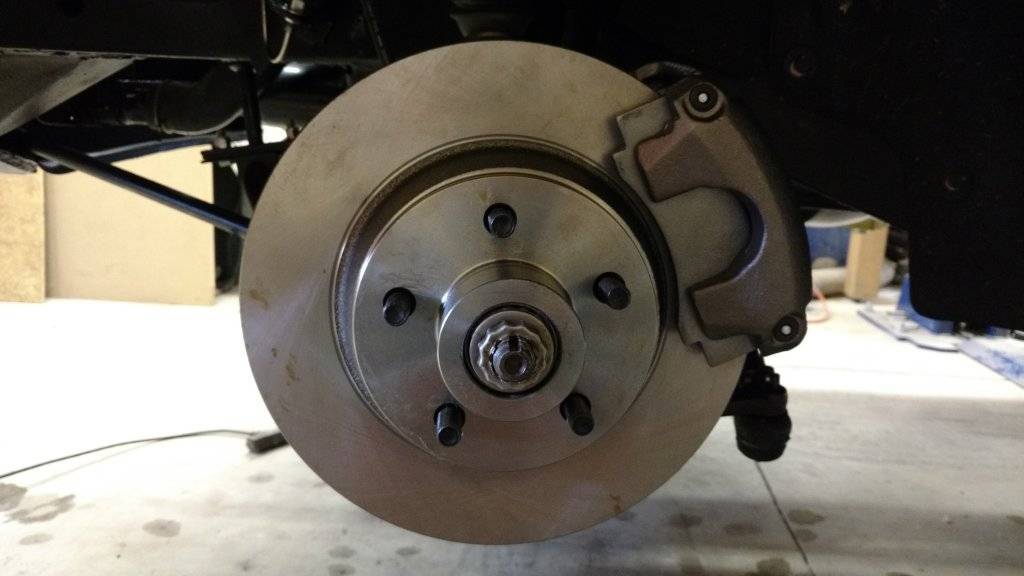

One sight problem, I thought I would give the heads up to others. I have Rebestos calipers and duralast pads. When I was installing the calipers and pads they would not line up. I took them back off the car and took a closer look. The "ears" on the pads where too thick and would not side into place on the outside position, inside pads are fine.
I took a grinder to them and shaved about a 16th of an inch off both ends and now they fit perfect.
I don't know which is to blame but I am guessing the pad.

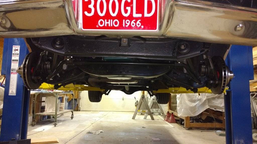

Lower half done. I had a couple of small issues that kept me from finishing last weekend, but finished this afternoon.

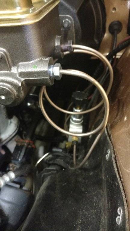

Productive afternoon. I installed the power booster and plumbed everything to the master cylinder, including the proportioning valve. Only one double flare performed without a flare nut in place. :)
Only thing left, bench bleed the master and then bleed the lines
I had to do the same with the raybestos pass on my 69.
Mystery solved. I have had problems in my conversion, and as usual human error is involved. In my case it occurred over 4 years ago. It never dawned on me that there was a front and rear portion on the new distribution block that I installed for the dual master from the original single.
I was never happy with the old brakes now I know why, because the disc brakes and dual booster amplified my problem. In the incorrect previous set up I could never get the brakes to bleed correctly. This go around I could not get any fluid to the front right caliper. Once I switched the input lines the front lines bleed as they should.
I am back to square one on bleeding the lines. I am certain that I have solved my problem, but ran out of time this evening to re-bleed all the lines.
