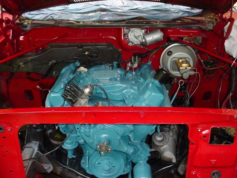

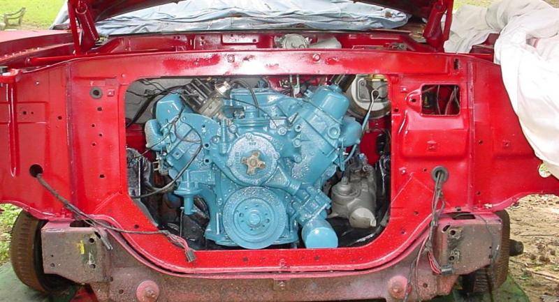

Underhood detail....? I'm in process of doing that on my 69 now. It's a labor of love... just be patient. I stripped everything out except the engine, (even the wheel tubs), then power washed, sand/bead blasted and otherwise stripped and refinished everything. I got the Dupont paint # and bought a quart of base body color for the firewall and core support then applied a clear coat.... Looks great so far.
