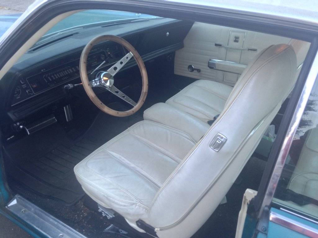

I used a generic steering wheel that wasn't compatible with my tilt/telescope. Grant Products 201 Grant Classic Wood Steering Wheels | Summit Racing In order to make it work, I had to add a bolt to the center hole where the telescope lever pushes against a rod to lock the telescope to keep it all from moving. The car steers fine... my horn doesn't work, but it didn't work with the broken rim-blow either. Tilt function woks.

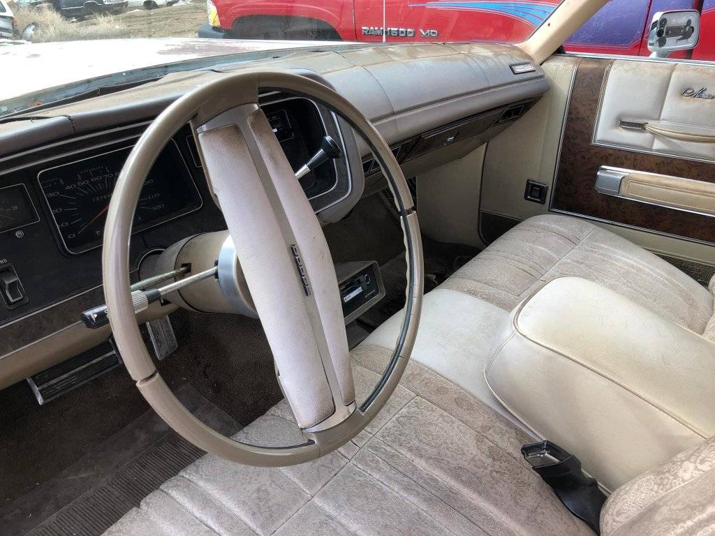

So all tilt steering cars have the same two spoke / large pad model with rim blows. And i must stay with a 4010 ... (or 4012 ....) steering wheel.

For several model years, Rim Blow was about the only steering wheel that went with the Tilt columns. Which is why I aimed toward the '74+ model year C-body steering wheels.
