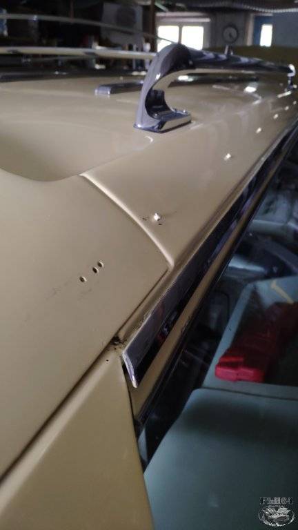

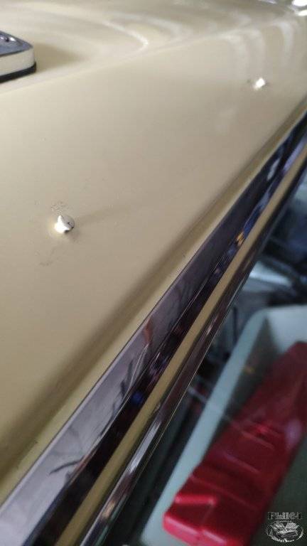

Hi all,
As you know i've a '73 Monaco SW. The car no longer has the woodgrain but I still have the roof moldings, not reinstalled. And that's the problem, there are still pins on the roof but what do the clips look like? The width of the molding is around 11 mm (7/16") but I don't really see what the fixing system is on the pins.
Thanks

When you get them, put the clips on those pins on the body first. I believe they have a locking feature, so look carefully and determine how they need to be oriented so they lock on to the pin.
Align the clips (horizontally) so they are ready to accept the trim. This is not hard.
Gently slip one edge of the trim under the clip. Then push the aluminum trim upward toward the “unclipped” side of the clip so that you have enough clearance to get the “unclipped” trim side over the edge of the clip. There is enough clearance that you can do this. Be gentle when doing this because the aluminum trim is easily bent/ dented. It doesn’t require a lot of force. Just a bit of finesse/technique. You might want to have another (careful) person following your lead, helping you with this so you don’t have the aluminum trim waving around possibly damaging the cars finish.
I should add - as you do this you will need to make sure the piece that goes down the A-pillar is centered properly and can be easily attached there. As I recall it was easier to get the horizontal clips running the length of the body/roof attached first. You may find that to be true, or…you may find it easier to attach the trims at the A-pillar first! Patience and thought and gentleness. And a little help from an equally patient and trustworthy friend.
