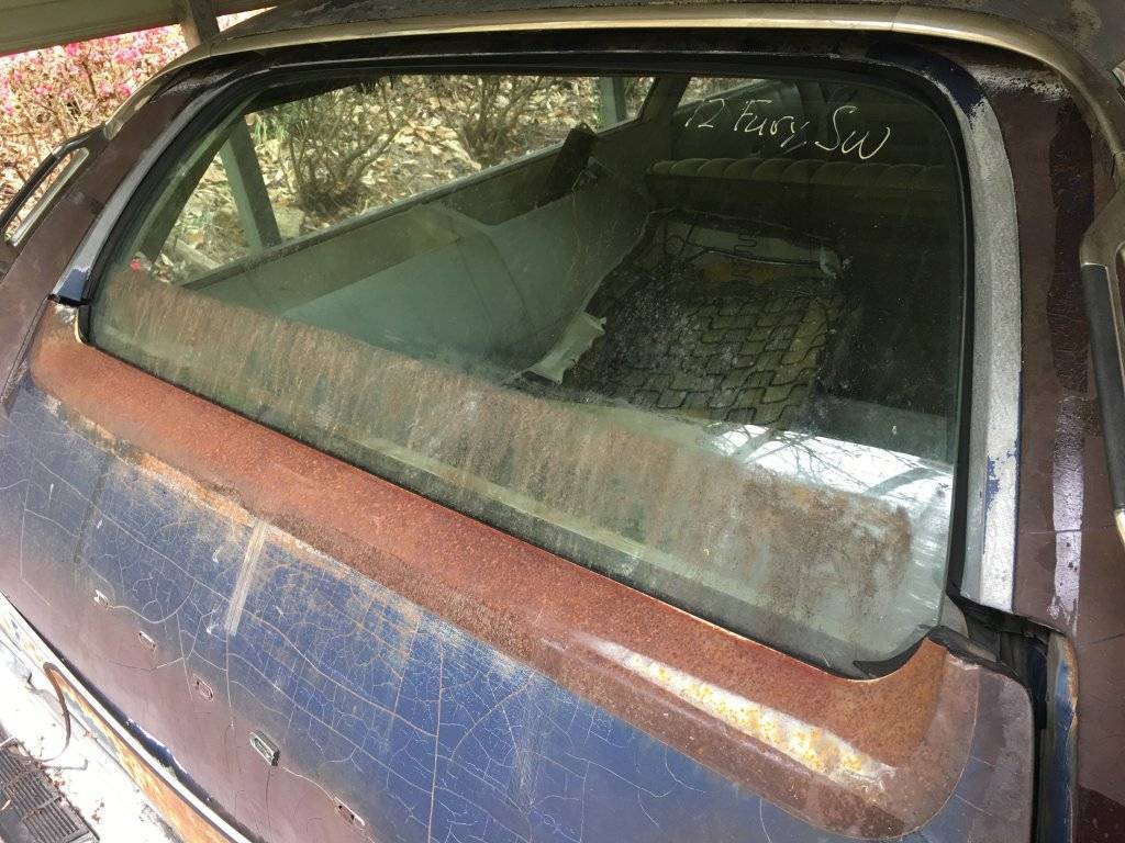

    "Restoration" seems a bit presumptuous and overly ambitious at this point. I figured this was as good a place as any to post some pics of some work I've begun. My goal right now is just to make it roadworthy. It's not far off from that, but we'll see what happens as things progress.
    Today I got the tailgate glass up. Seems like a small thing, but the motor works, that is a relief! $$$ saved. With electrical power on the car, the switch does not cause the motor to work. Continuity, or lack thereof. So it could be the switch, breaker, or wiring. Not sure if there is a relay, that is a possibility also.

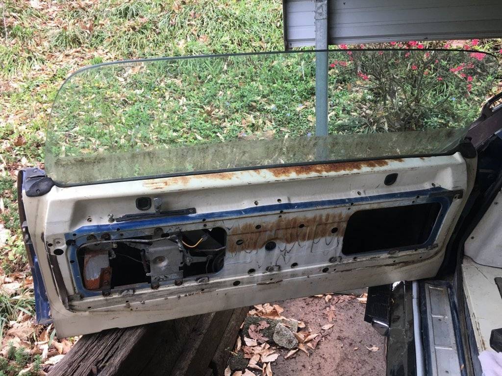

    Hooked up the battery today, lowered the glass over lunch hour. Closed the door, tried the mechanical gate switch lever. Nothing.
    Grabbed a can of PB Blaster, squirted everywhere that looked like a moving part. Tried the lever again, and...KA-CHUNK....down that tailgate went, just as intended! I then PB Blastered a couple more spots (I am petrified of the idea of expensive unobtainium wagon parts failing because they are rusted and I didn't think to let them soak in some penetrating oil). But this was another win. I got some grease and put it on stuff that looked like it needed it, where there was previously grease, like a guide rod.
    There is a black plastic window seal on the interior side of the tailgate where the glass exits the door/gate, it is crumbled and mostly gone. I need to get something on that to prevent metal to glass contact. I also noted one hard rubber rectangular guide inside the gate had fallen off. It needs replaced, about as big as half a domino. The metal tab that supports it could contact the glass. Didn't see it lying in the bottom of the gate. One thing at a time. I lubed the track with just a little grease, which the glass guides travel up and down in. I think when the glass got replaced, not all of those white plastic and metal guides were reinstalled. I found three lying in the side back plastic storage bins/ cubby hole of the cargo area.
