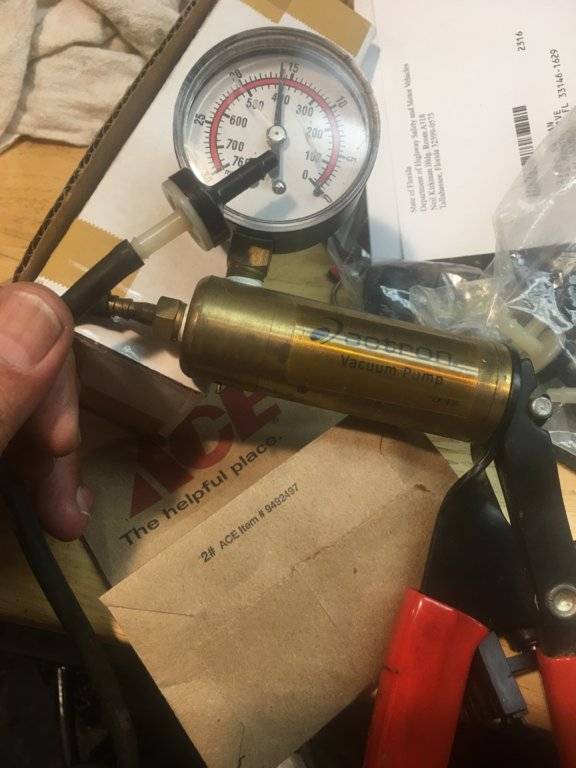

I indeed did use a needle. Pins are too soft. But first I put the check valve on a hand held vacuum pump. To help gauge the size I had made. I start with the smallest needle in my wife’s sewing kit going up in size and when it takes about 20 sec to lose all vacuum in a 12” length of hose I stop. I push the needle down inside through the opposite side nipple.
