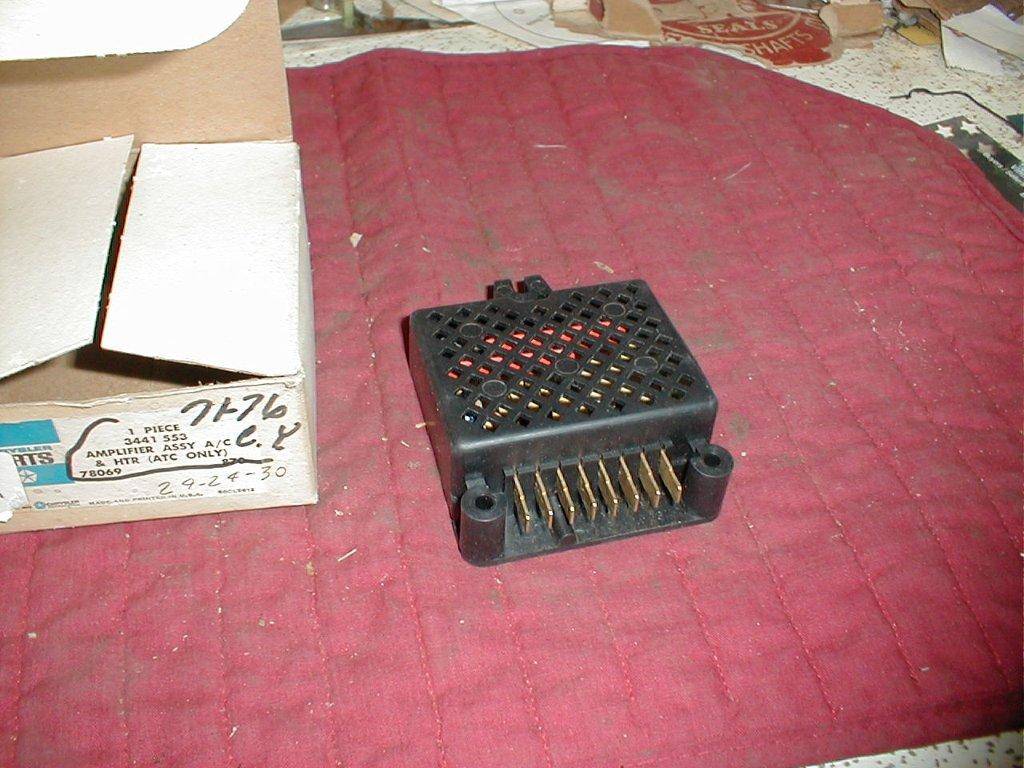

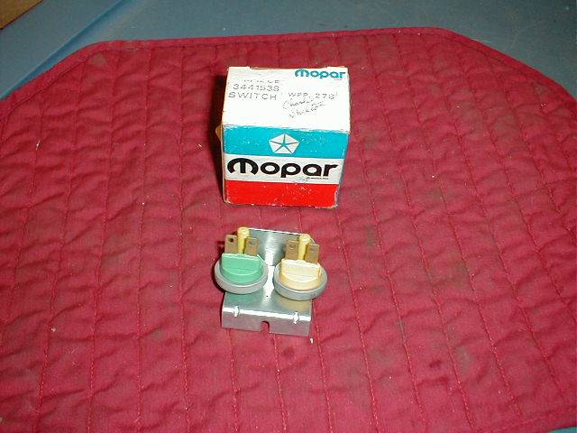

When you push the buttons with the engine running (you need vacuum) you have no fan in any mode? Do you hear the servo whirr? Fuses good?
Pop off the dash and you can see most items. There are 2 vacuum switches on a bracket (green and yellow) that activate the fan. You can jump them to verify the fan is good.
Normally this is dead (the amplifier) Located on the passenger side lower edge of air box.
If everything else is there are in good order, then plugging in a good amplifier often results in the functions coming to life as it sends the signals to the servo.
The servo is often blamed on Formals, but I have never seen a bad one...they are very robust.

Got the dash off, and when pressing buttons on the control panel, I can hear noises from the servo. It also makes noises after shutting the car off. This is while I have the green and yellow vacuum switch terminals jumped. The yellow one clearly opens/closes a relay, the noise is audible and I can see the relay. The green terminals don't make any noises/changes when jumped as far as I can tell. The blower doesn't blow when these 2 vacuum switch terminals are jumped either. The amplifier LOOKS to be in OK condition, but whether or not that means anything is up for interpretation.
I had a purple vacuum line running to the vacuum canister under the hood, it was melted and the canister had been capped off to stop the leak. I spliced the line with some Tygon tubing and got it hooked back up to the canister. It's holding vacuum.
With the purple vacuum line hooked back up, the yellow vacuum switch works properly now, hooked up with the car running it will engage that relay. Green still doesn't make any changes that I can tell. No blower motor noises either.
If my issue lies in the amplifier, can the amplifier be serviced in any way? I have some component-level electronics experience from a couple classes I took in high school, and I also do the occasional audio amplifier repair at my job. I realize this is a different "amplifier" that we are talking about, but if it is an electronic issue I might be able to do something about that. Unless its a vacuum related thing, in which case nevermind haha.
Edit: I took a passing glance at the amplifier and saw electronic components, and at that point I could smell blood in the water and popped it right off the air box and pulled the board out of that plastic housing. This is a very rudimentary circuit, definitely circa 1970's haha. I'm gonna do some poking and prodding and see what I can learn! I did find a diode that looks like it MIGHT be busted, shows a breakdown voltage of ~.8V in the backwards direction. But that was while it's still in the board. I'll remove it tomorrow and test it again to see if it is indeed bad. Being able to service this amplifier myself would be pretty kickass, and being so simply put together, I don't know what I couldn't. Also do you have a better electrical diagram of the system, in particular what is going to the amplifier? The image you gave me is difficult to read. I'm reading through the "what I learned about 74-78 ATCII" thread posted by '73 T&C'. Lots of good info!

I have been on and off self teaching myself on ATC II for the last 20 + years. The system is in many ways simple...the difficulty is in knowing what pieces do what. Once I figured that out I got to the point where I can focus on the standard mechanical repairs.
If you hear the servo changing modes, the amplifier is doing something. What you need to do now is cycle the different modes and see if the air changes direction through the dash vents/ defrost vents as it should...that's all the servo and amplifier do. If one of the modes is not working, then the amplifier is bad for that function and no longer sending signals. As far as I'm concerned the amplifier is a black box where magical voodoo happens...I'm not an electrical guy! For me it's a replacement part...hats off to you if you can do circuit board stuff!
For example- on my car (77 T&C) I had only defrost modes for the longest time. I parted a car and, on a whim, swapped amplifiers and my whole system came to life! For the first time in 10 years I had all modes (Vent, Lo/ Hi Auto and Lo/Hi Def). All I need to do now on my car is standard A/C servicing to get cold air (evacuate system- see if it holds vacuum/ repair leaks (probably rebuild compressor, new oil, expansion valve...yadda yadda).

Apologies for my initial bad direction on the vacuum switches...getting old and forgetful! LOL!, I checked my FSM and only green switch is blower motor.
The yellow switch is called the "Compressor switch" and is activated at 2 inches vacuum to complete circuit to compressor clutch (turn on compressor).
The green switch is the "Master Switch" and is for the blower motor. completes circuit to blower motor when 8+ inches vacuum applied.
