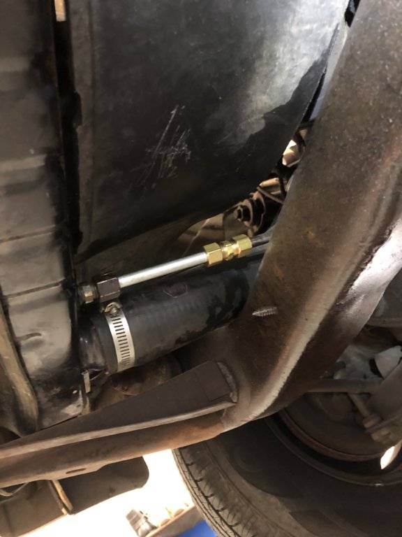

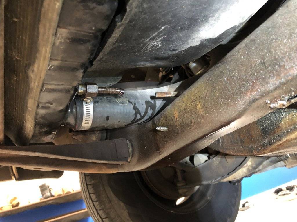

I just acquired a 74 Fury III with a 400 and the passenger side trans cooling line is shot near the radiator end and 'patched' with some rubber hose and hose clamps. It leaks like a sieve and so far is the only mechanical problem I've found with the car. To that end I need to get it patched up.

Grab a 3 foot or so piece of 5/16 brake line at your local NAPA (or whatever) with premade flares. Cut one end off and take off the flare nut and replace it with the flare nut off the old line. That the radiator end. Cut the old line where it's bad, cut and bend the new line and use a 5/16 compression union to connect them and you're done.

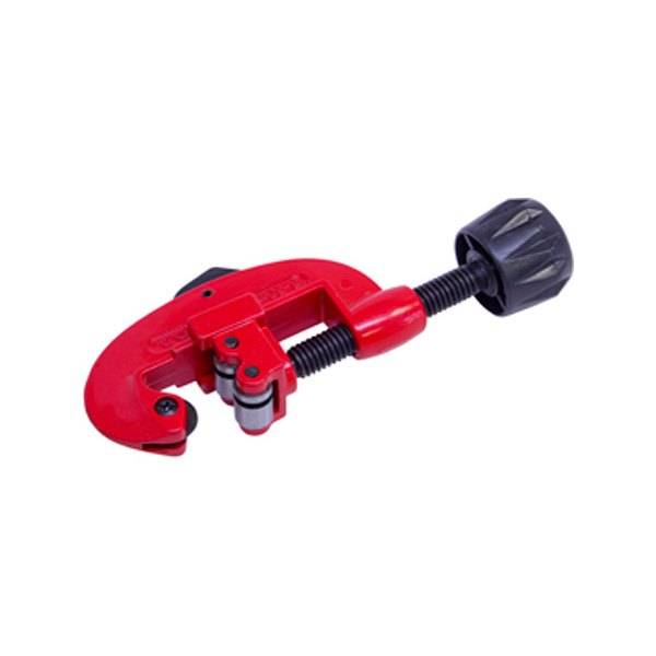

Only tool that you will need is a pipe cutter and a couple wrenches. The bends can be made by hand. Hack saw will work, but you should have a pipe cutter in your tool box anyway.

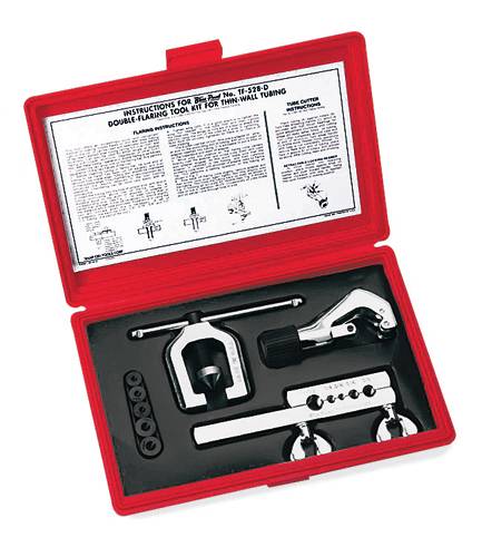

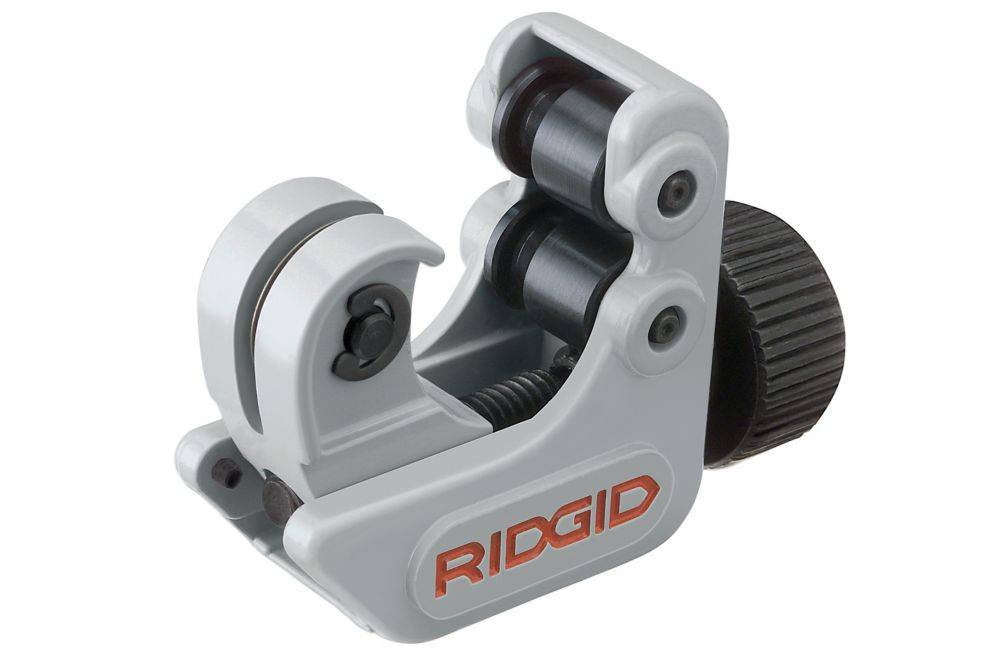

These will be your friend,
For really tight spaces,
Every auto mechanic should have the whole enchilada!

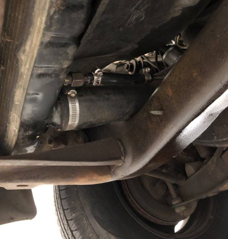

Thanks guys, I don't know why I didn't think of doing it that way.
Finally had a chance to get this done yesterday night and got the car back on the road.
The splice is holding well for now.
