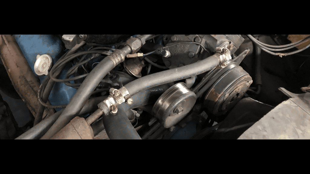

    While I have plenty of basic mechanical things on my list that will come before either of these items I wanted to get some opinions about two things because I like to plan for the future.
    Air Conditioning
    The A/C hasn't worked since I purchased the car and at least part of the issue is one of the hoses appears to be patched by putting a larger hose over it with clamps. It gets hot here and ideally I'd like to have cool air for the summer. I'm aware of the A/C retrofit kits for more popular mopars (A/B/Es), but what are people doing with the A/C on their formals?
    Four Barrel Upgrade
    I have a stock 400 2 barrel setup. Is it worth anything to go up to a four barrel? Is the common path finding a factory four barrel manifold or are people going with 'performance' parts for this type of swap? What will I need besides the carb/manifold?
    #edit
    Visual on the questionable A/C

    Wow, talk about your patch jobs on the A/C. You will definitely need a new hose assembly and a new filter drier. I would have the compressor checked out thoroughly since R134 Freon does not work well in the factory RV2 compressor. Their are many kits to change it over to a rotary type.
