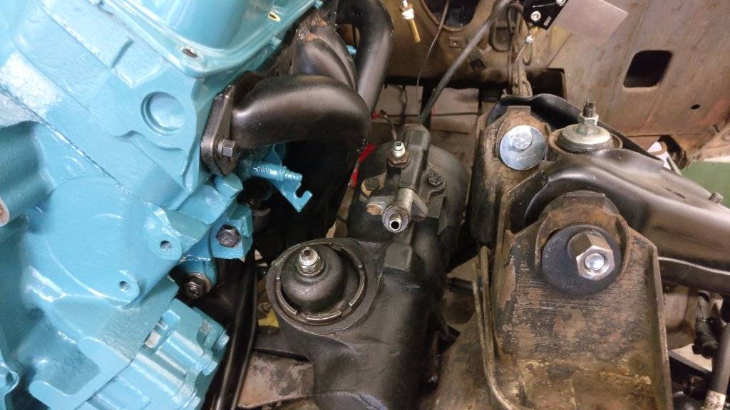

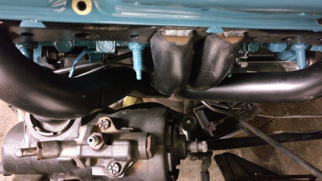

Headers are way better for powers than manifolds. Also compared to the HP manifold.
I can advice shorty headers. Long tube headers are a pain to get right and hang low. More chance of hitting something with the headers
I've used hedman 78070 for my mopar 400BB.
Works great with my '68 Newport. It can get tight to the booster and steering gear when using an RB tall deck engine. No experience with those...

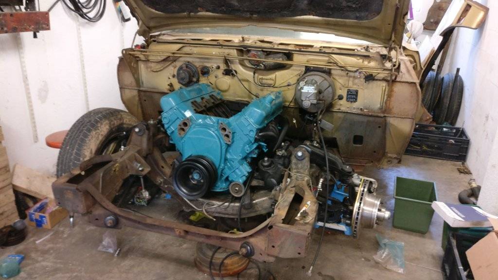

For more info check out my Newport build
