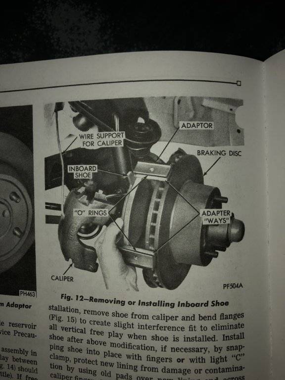

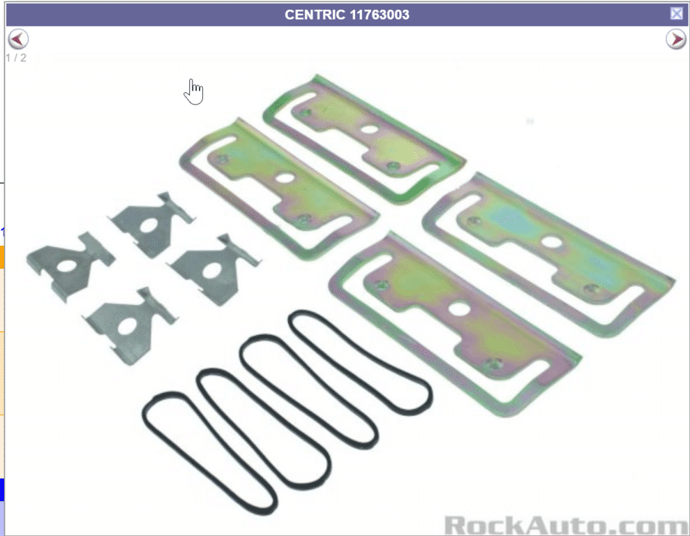

The "o rings" came with the retainers, anti rattle clips, and bolts in a kit like this.
They were either never installed or long gone on my actual car, so it took a few trips through the brakes section in the FSM to find a picture of my actual caliper to find this designated as the location.

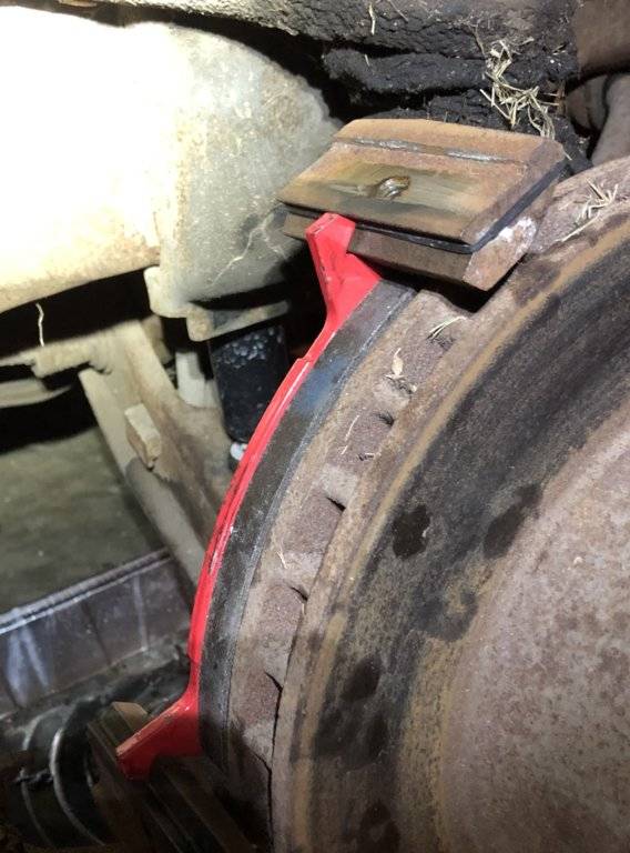

Installed they look like they will jam the pad and then tear or tear and then jam the pad, but me knowing how something works or thinking it will work has zero relationship with reality. I've subsequently cleaned and de-rusted the "adapter", but put the wheel back on before I took a picture.
Ah, I refer to them as elastic bands...anti squeal item. They are not required for efficient operation of the brakes. As you said, they do not last on there.
