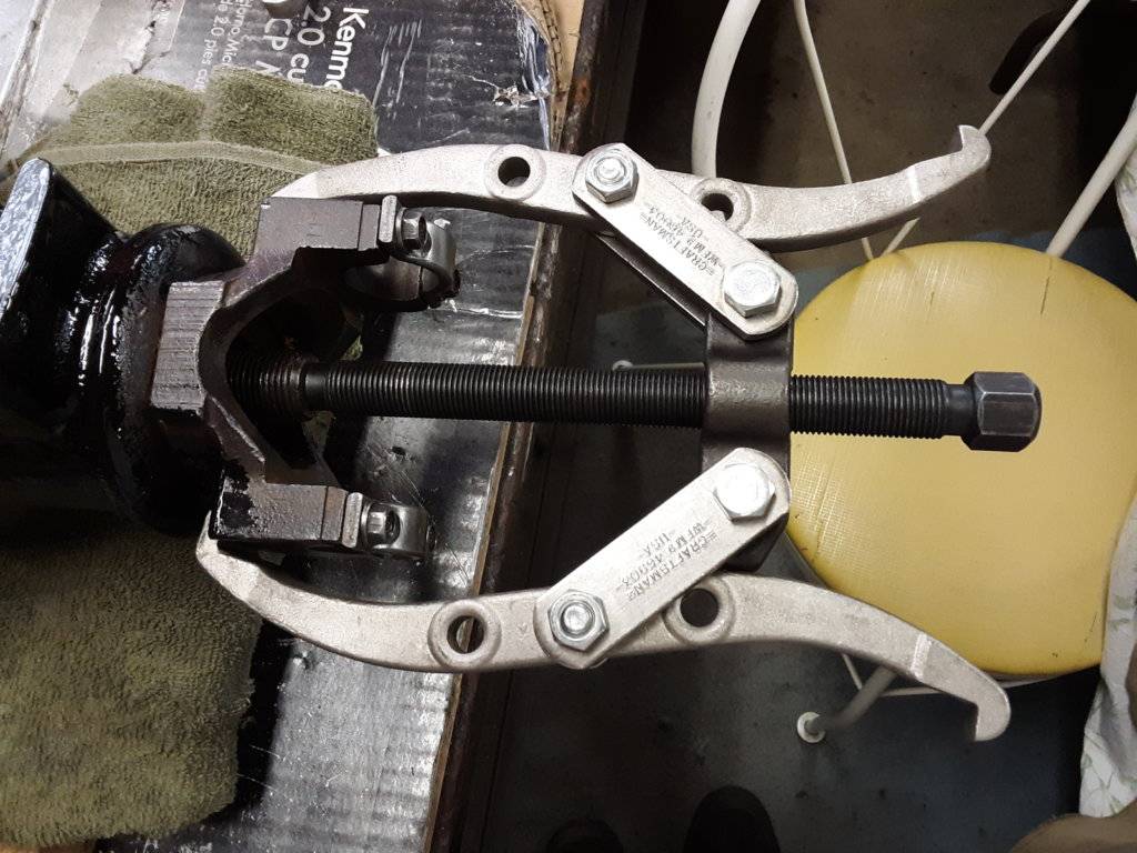

Yoke Nut Removal (my way, not the only way)
Yoke Puller for Reference
