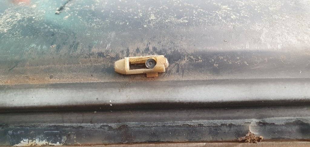

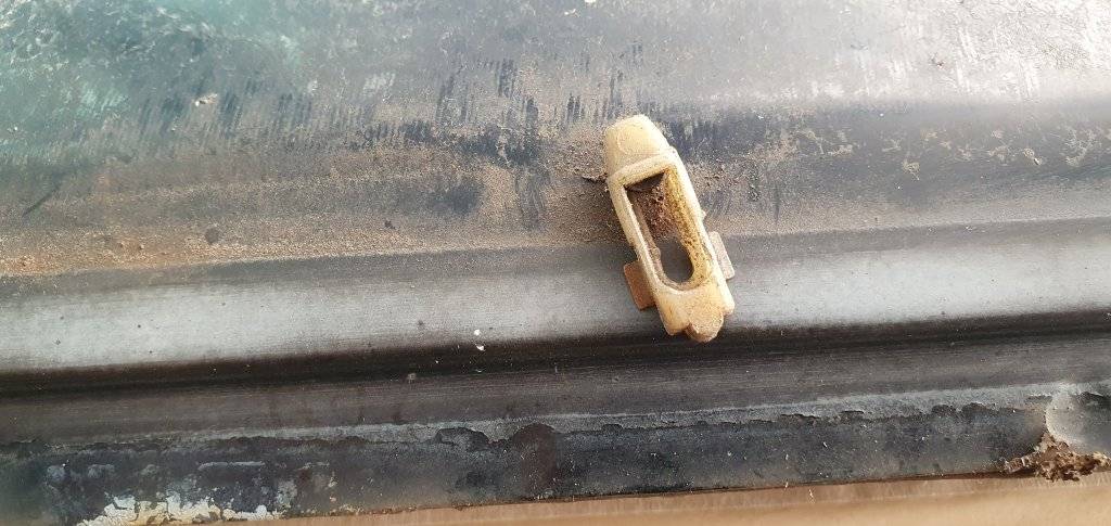

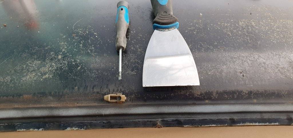

In case you haven't done this yet, I recently have and thought I'd share some info. First and second pic are the trim clip on my '75 Imperial which I believe would be the same to your '77 NYB. Third pic is the tools I used. Don't know how you'd call it but I used the flexible putty spatula (?) to gently lift the trim and the tiny screwdriver to then pry loose the clip. Since they are fixed to the roof at one side there was just enough flex for that to work. Starting point that worked best for me was the corner of the trim at the rear of the roof, at the top of the c pillar. Only one this didn't work for was the last one at the front near the windshield, that was sort of wedged in the trim and I was afraid of breaking it so slid the trim off with it.
Front and rear glass trim were an absolute pig to get off and I bent a couple of pieces so can't be much help for you there as my way clearly wasn't the best.
