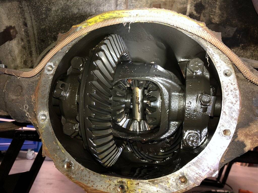

    Oil actually looked pretty fresh, so this probably wasn’t need, but it’s better to know. Now off to scrape some gasket.

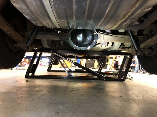

    Buttoned up and ready to go for a ride.
