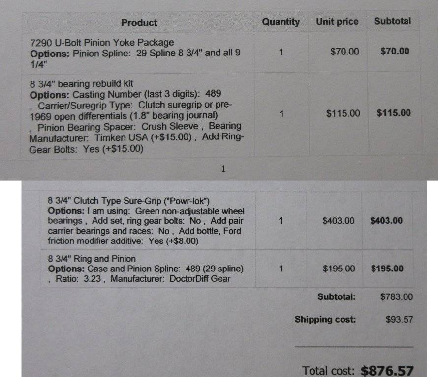

69 Chrysler 300 with 8 3/4, 2.76 Open Axle, 489 Third Member that was converted to a 3.23 Sure Grip. Four rebuilds in 2800 miles. I'm not sure which way to go at this point.
First rebuild
Convert the 2.76 open axle to a 3.23 Sure Grip. All the typical conversion parts from Dr. Diff.. A recommended muscle car shop did the rebuild. Car drove with slight gear whine, nothing bad. "Give it a couple hundred miles to wear in they said." While 400 miles from home on a Saturday, rear end starts clunking, making noise. I take it to the local Chrysler Dealership that happened to be open.

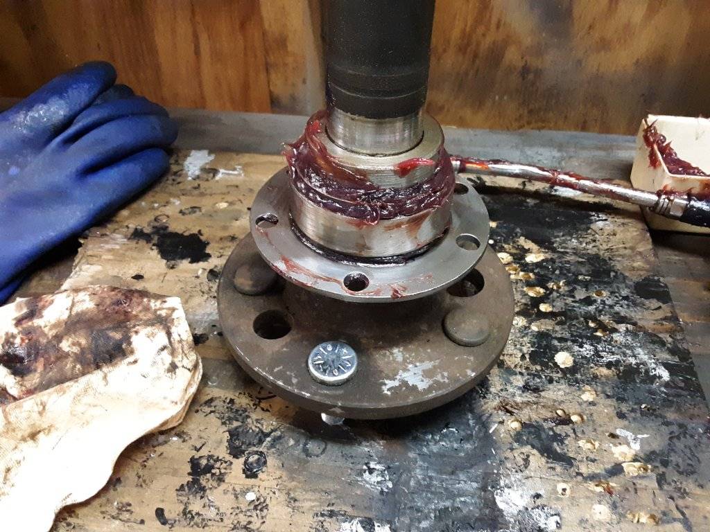

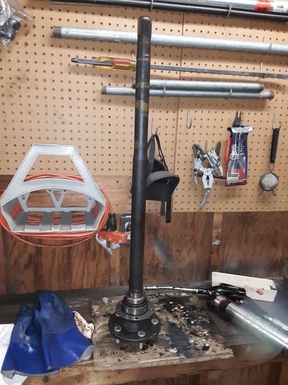

If the car still clunks on left turns after rebuilding the center unit and then replacing the center unit, the clunking is most likely not the center section. Axle shaft outer bearings are done separate of rebuilding the center section. Clunking could be a bad axle bearing, but another possibility is a brake issue at any of your 4 wheels, front wheel bearings, suspension components like control arm bushings and ball joints, tie rod ends.

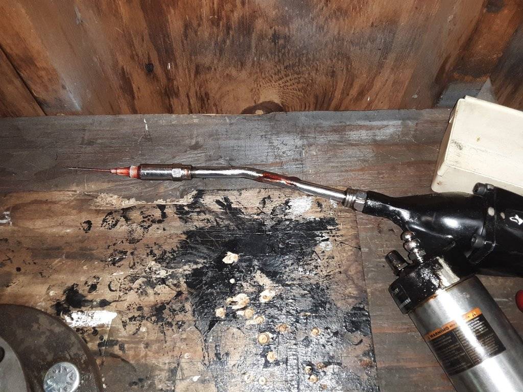

I personally don't think the clunk is an axle shaft bearing. They usually whine on turns when going bad in my experience. 8 3/4 axle bearing lube.

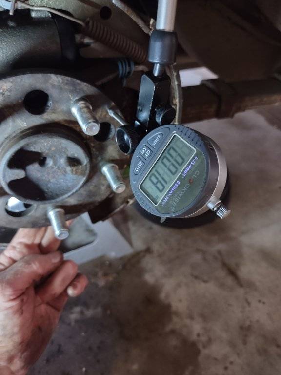

The only other thing I would add is to make sure end play (at the passenger side axle) is set thusly:
Set at .018 on my 8.75 2.94 Sure Grip.

Since you replaced the bearings, I assume that you replaced them with Green bearings. Did he replace both sides with Green bearings? He should. Green bearings will often push the axles too far inward so that they collide with the center thrust block. If that is the case, you won't be able to secure the axles properly, and it could cause similar problems to what you are describing. The fix is to remove the thrust block from the differential. Did he do that when the sure grip was installed?
Why do you say he should replace with green bearings? I like the original taper bearings as I can clean and repack them. As long as they are adjusted properly they last forever. The only time i switched to green bearing are on drag cars with a spool as the spool will not allow you to adjust the end play. IMO the taper bearing handles cornering better that the green roller bearing.
I'm with you on the adjustable bearings, but I look at this from @MJFUR 's first post and wonder if green bearings were used or not. It looks like Green bearings were spec'd on the order.
It would seem to me that a suregrip unit set up for green bearings won't have the spacer that the axles butt up against. If he has used green bearings, then the suggestions about setting the backlash aren't applicable. If he has used the tapered bearings without the spacer, that could be a problem.... Possibly even this problem.
Replacement taper bearings no longer exist. So if he replaced the axle bearings, they put in Green bearings.
Good to know, thanks. Looks like I was lied to by a shop that pressed my axle bearings for me. They insisted that green bearings were the only option.
