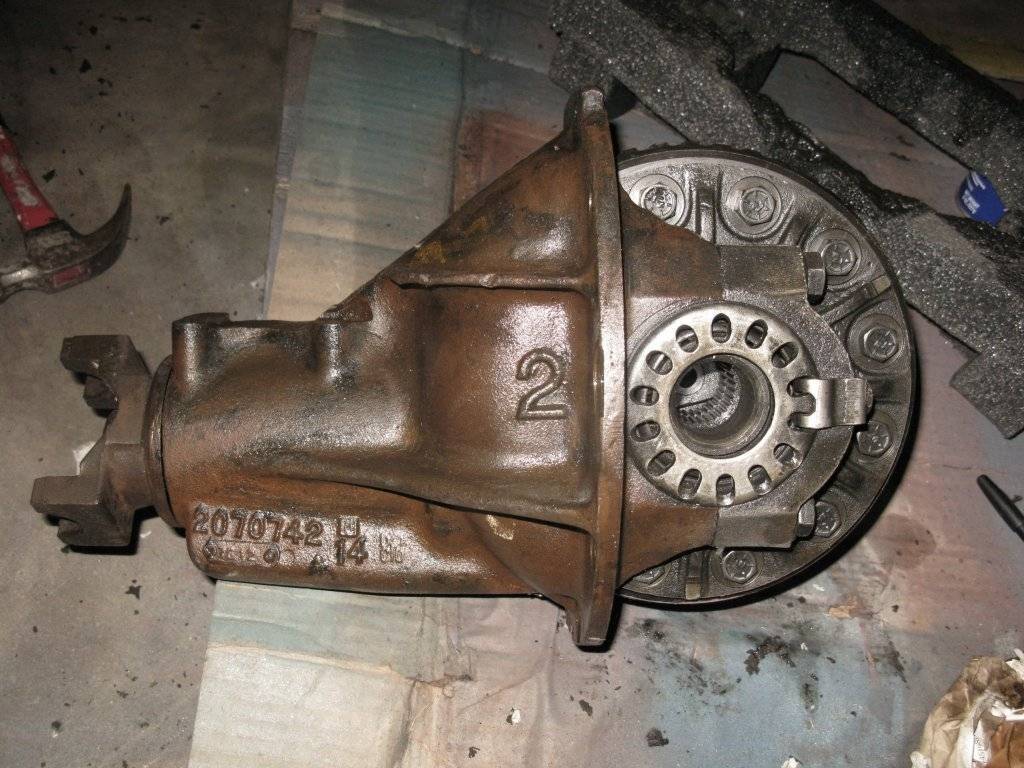

I have a 8 3/4 differential i found in my warehouse (yes, sad i don't label stuff).

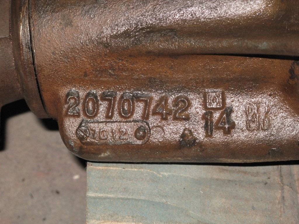

1. "742" case, date stamp "7G12": what date is that?
2. its a 2.76 "Sure Grip" (47 teeth on ring (p/n 2070684), 17 teeth on pinion): IF any car had a sure grip option for a tall gear it would be a C body. Any such thing from the factory to anybody's knowledge?

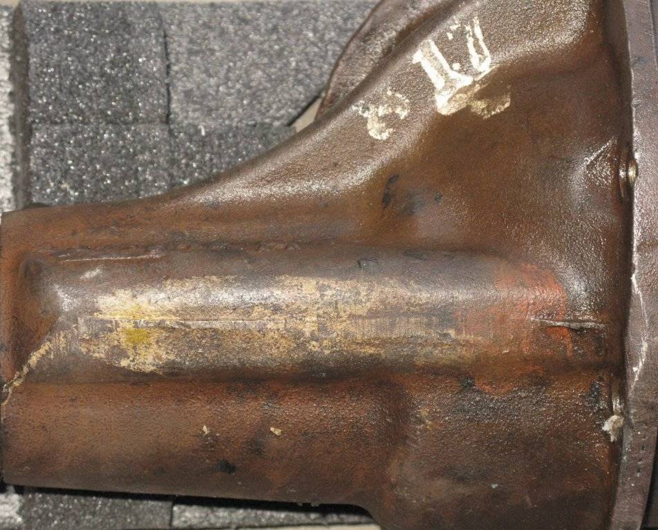

3. an aside...the original case markings (white paint - "817" on other side, stripes on the bottom, even one stray mark showing about in lower right of top picture) were under the grease on the bare cast iron...that make sense?
i thought they were painted from factory -- no?

742 tells us it is a from a 440 car as 383 cars carried the 741, the 742 was replaced by the larger pinion 489 case in about 70 or 71. Maybe 69? Sure grip option was available to anyone who would pay for it. As for the white paint, that is the remains of production line markings put on the housing as the car was assembled.

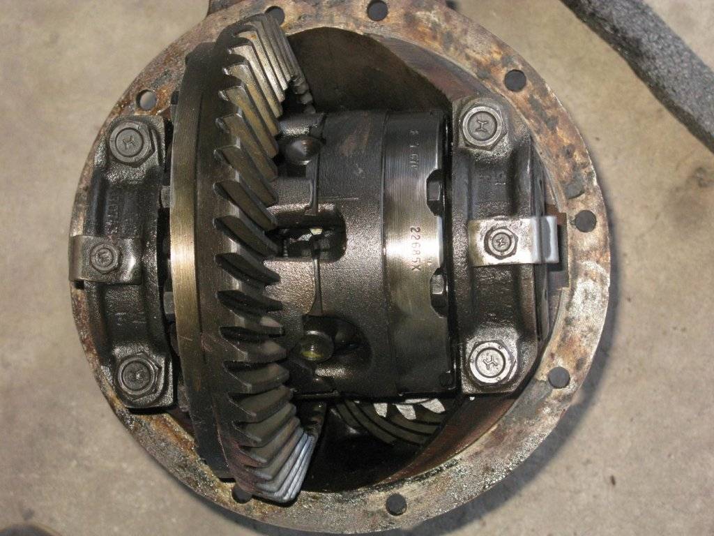

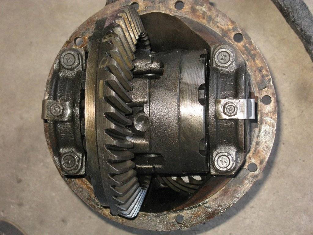

Can we see a pic from the gear end? That will help us to work out if it is a cone style or clutch style sure grip center.
If that was a 2.97 S.G. I'd have been interested....nice find though.
Okay that is the more desirable clutch type sure grip as the clutches can still be purchased for them.

any thoughts on date of this assy? my guess is 67 or 68 MY. but i cannot find "7G12" anywhere as dating convention for diff castings.
unless 7 is yr, G is month and 12 is day?
I'm not sure what the numbers stand for on that, but all I can say is it can only be for the years 1964 to 1969. The sure grip is, to be technical, supplied by Dana and was called a Power-Lok. A lot of guys here will latch onto that by the way, it actually has two names!

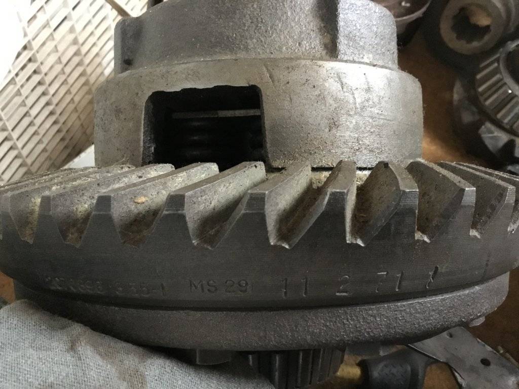

There should be a date on the ring gear.

Here's one I have laying around. Dated clearly...

so back on topic: yes, matt, you are HELPful. AND the answer to my question is the RING date is August 8, 1967. on the Ring it shows as "8 8 67" widely spaced like your example. now my judgement is the case casting is dated July 12, 1967 - three weeks before the ring.
I have high confidence this piece was from a late 1967 or early 1968 model year car. All mysteries solved. Thanks everybody --- particularly Wollfen and detmatt.
