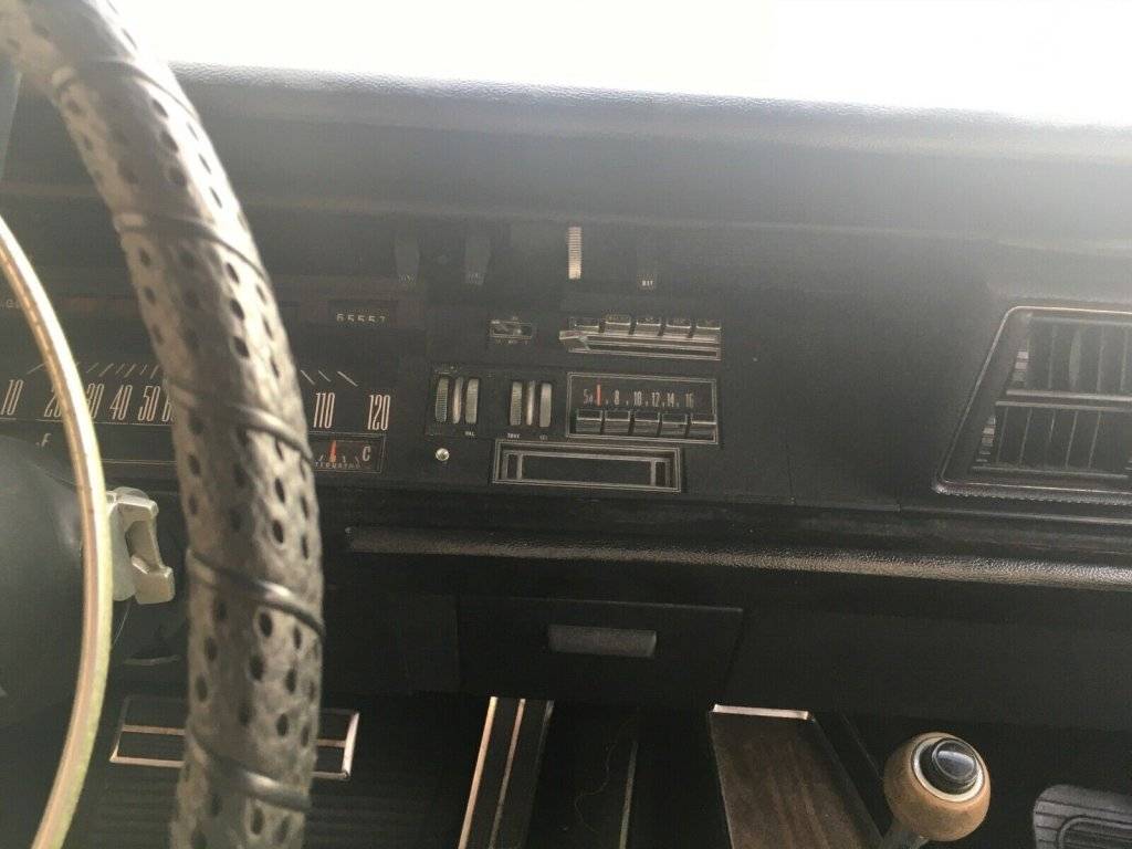

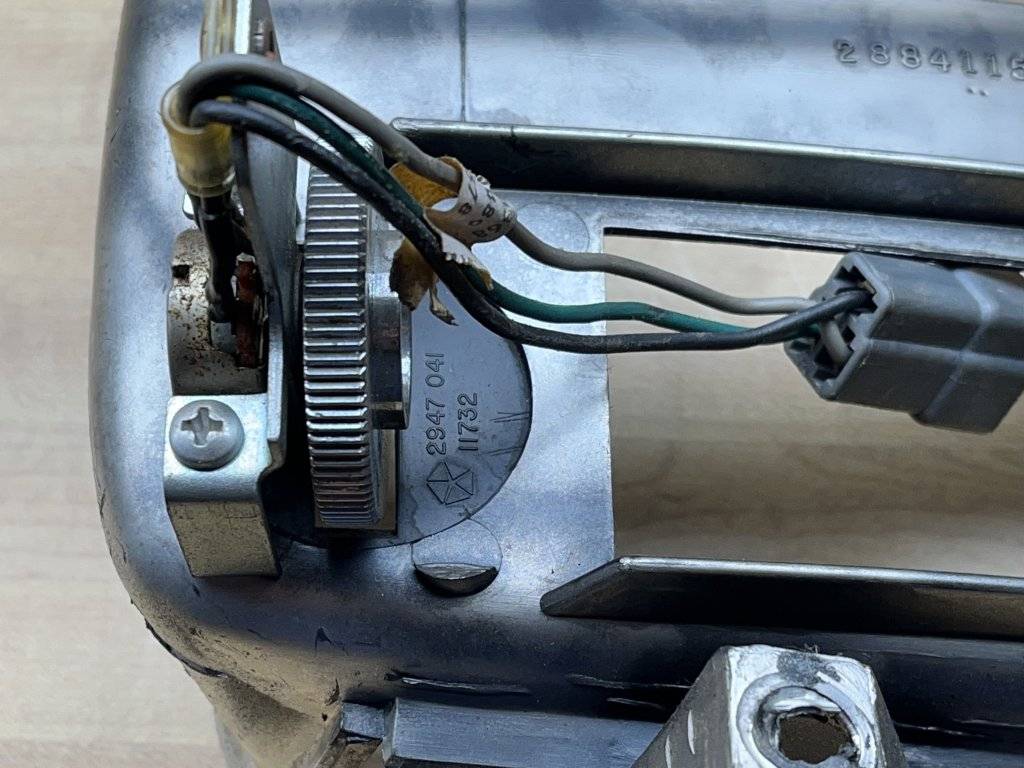

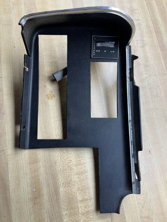

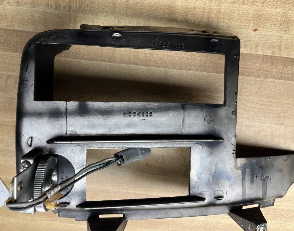

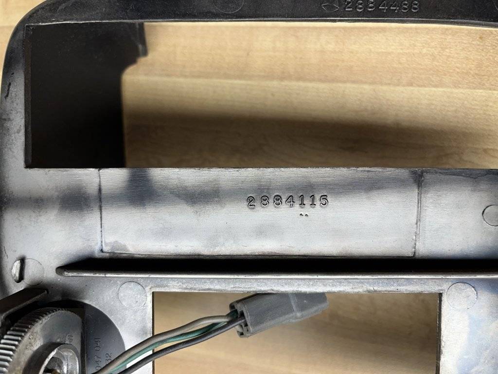

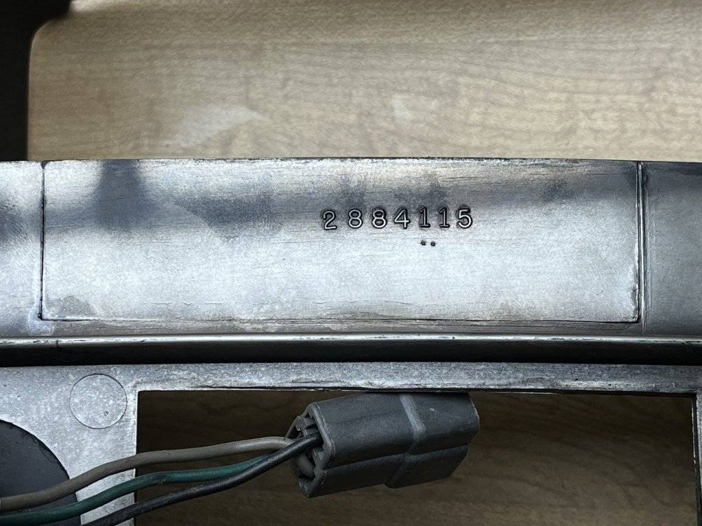

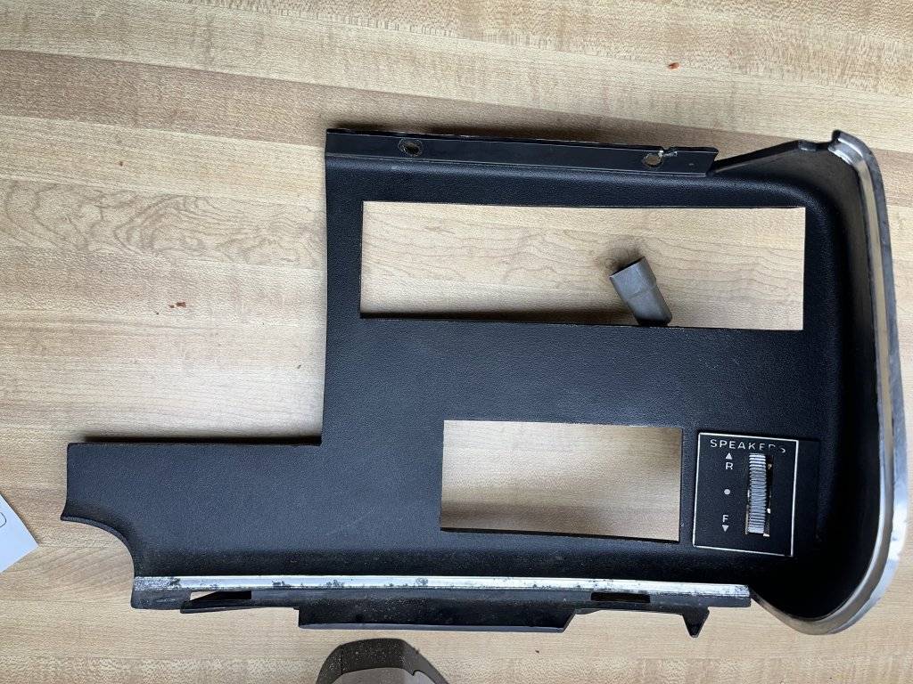

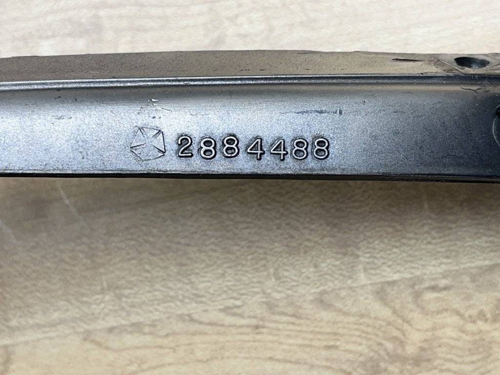

Here are some pictures of a spare radio bezel with the optional front /rear speaker speaker fader roller switch. Pictures 3,4,5 show an outline that should be very close to what you need to cut out for your 8 track face . From there it’s just a matter of lining up the control rod , marking it and drilling it out. It should look pretty good when you’re done . The only difference from the original would be the small silver square to the left of the notch you cut out . It’s just for show and doesn’t affect the 8 track .
The Fury is a very different face plate than the 1970 Chrysler 300 dash. Here is one from a Chrysler.
Samplingman is correct ! I should have read the first post closer . Sorry about all the pictures and confusion.

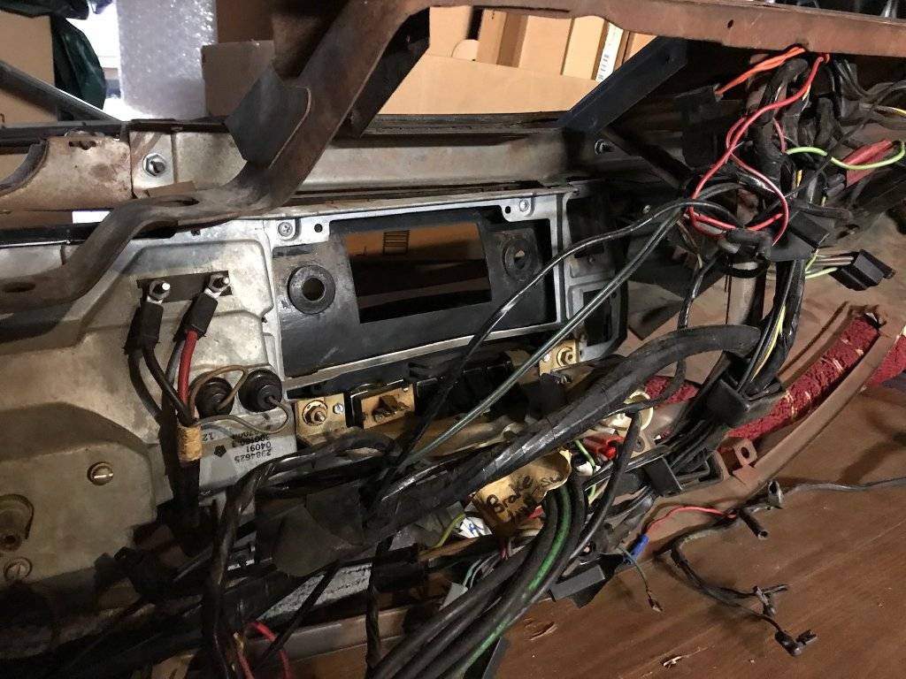

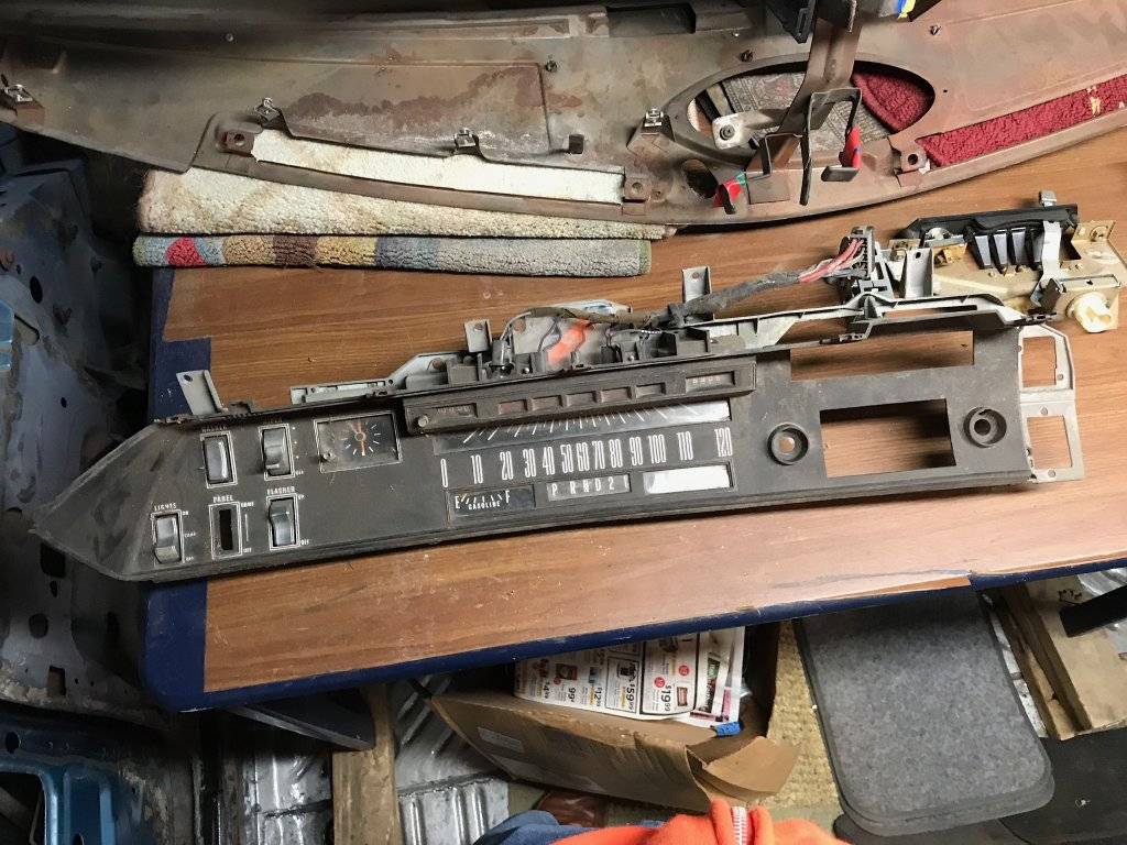

Here is a non-8 track dash, and a view from the back of the dash. I don’t see where you can retro fit an 8 track without getting the correct dash. It doesn’t seem to have simple cut out lines like the Plymouth.
