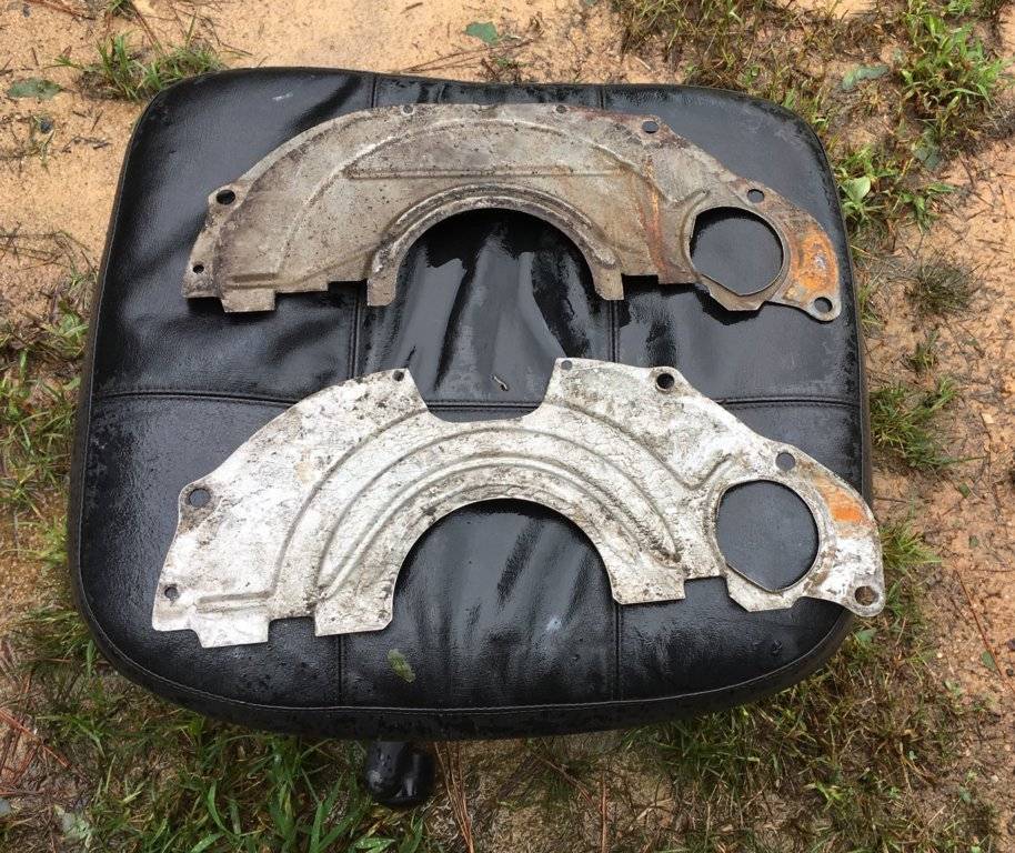

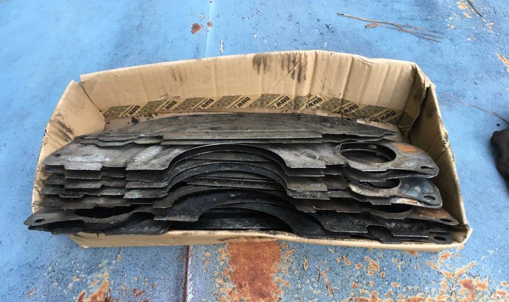

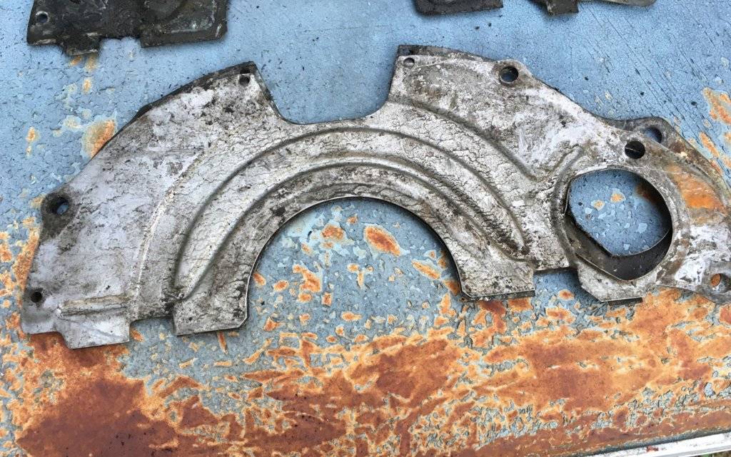

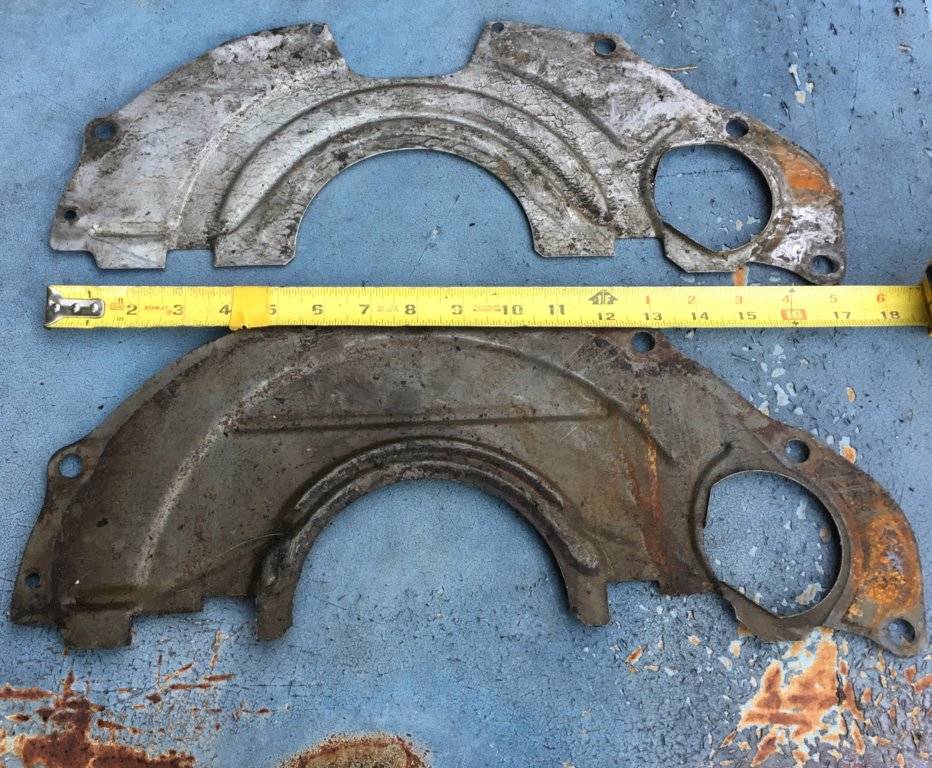

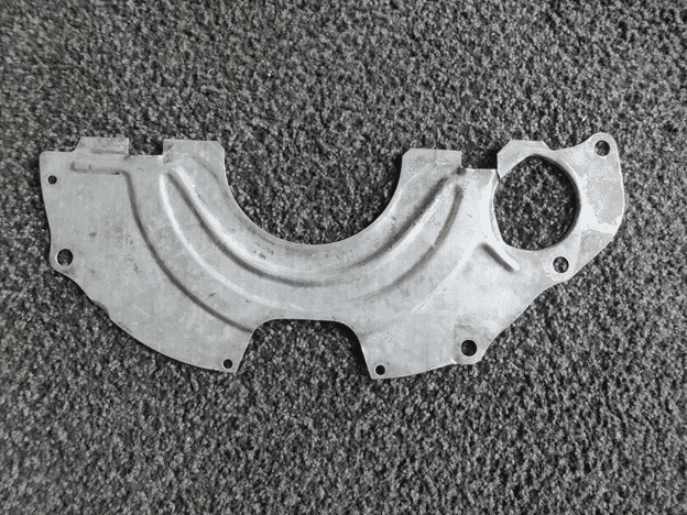

I forgot. I brought those to the shop a couple months ago as I had a local guy needing one. I have a bunch. The longer ones have S/6 727 written on one. They do not line up with the other two. So I’m thinking you need the shorter one. They are different also but line up correctly. Let me know if you see the one you need. All are good
View attachment 212816 View attachment 212817 View attachment 212818 View attachment 212819

Hi Bob. On ebay, 2 sellers are emphatic that 904 and 727 are different. I would also guess that the 904 is the shorter one. But, as I said in the OP, mine is cut, so I can't measure it. :confused: Maybe @Wollfen Gary can help. Otherwise, I'll do like @jct says and take one of each.

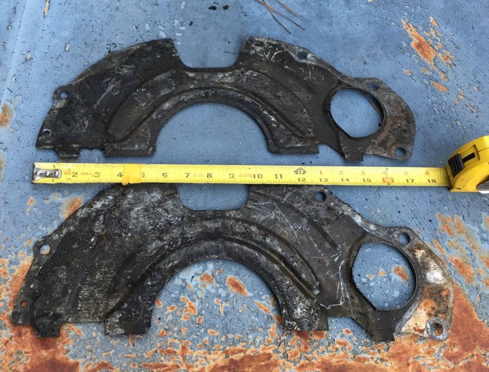

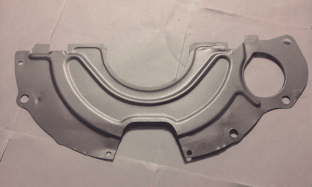

Will this work. This a 904 trans. Not bent quite the same. Also I can see which one of those covers fits.
Thanks for checking to see which cover fits.

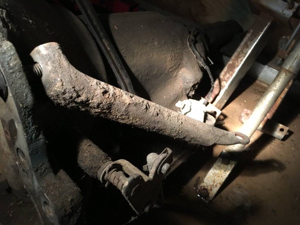

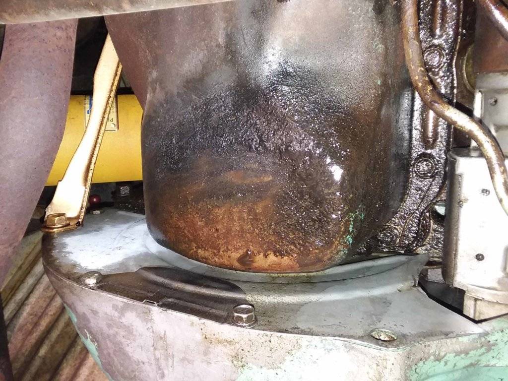

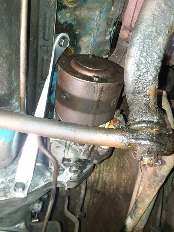

If the brace mounts at the trans below and to the inside of the starter and mounts to the engine in front of the starter on a small block v8, I guess it might work. What year & model, engine is it out of?
The pics I took were from a 727. You're right that the shape is different. Left side brace is on right in this pic I found.
Left side brace on 727, mounted. (2nd trans cooling line not yet installed)
Bottom line, I'm willing to pay for it as long as it went from 904 trans to SB-V8 and was on the left side, ... especially since with you test fitting the covers, I don't have to pay for an extra cover.
Thanks again, Ben

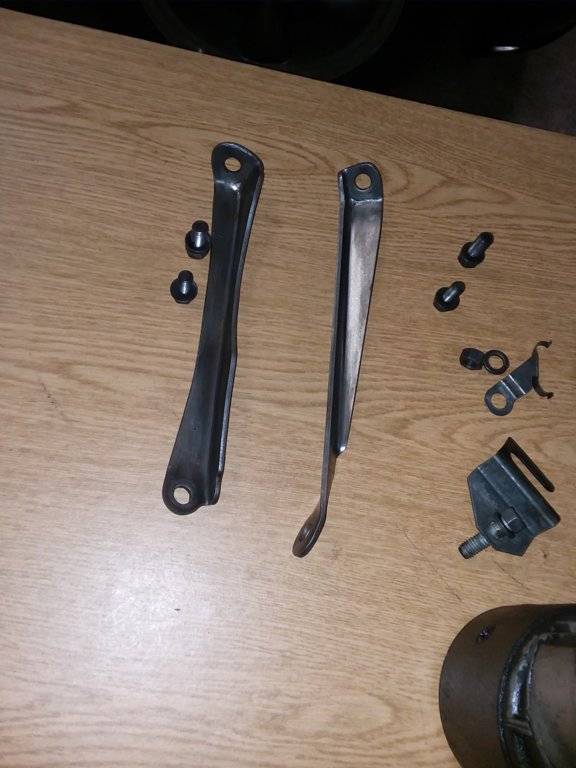

Side view of both 727 braces, left side in front. For anyone reading this, I'm missing the left side brace on my 318/904 70 Fury Conv. Bob is helping me replace it, to add stability and help get rid of a sporadic deep rattle. See pic in original post
Let me pull that brace off & measure it better & get a better pic. I cannot remember what this trans came out of.

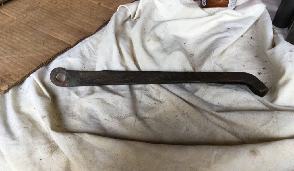

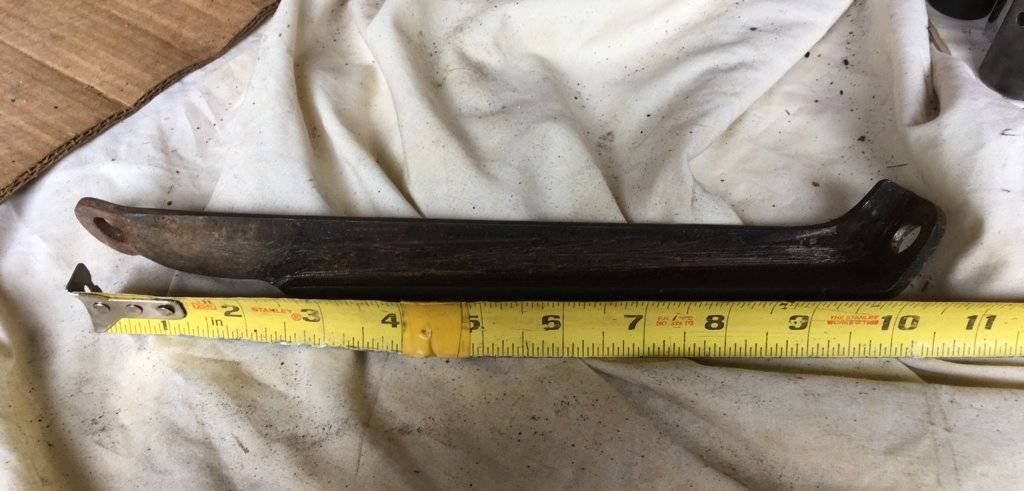

View attachment 213801 View attachment 213802 View attachment 213803 View attachment 213804

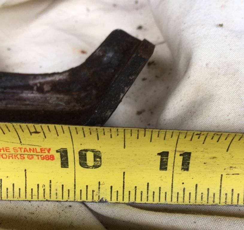

Here is that brace. I took it off. 10.5 inches hole to hole. Both of these covers fit my 904. Take your pic
Hi Bob
Brace: 10.5" is the right length, so I'd like to have it
Cover: I'd like to have the lighter colored cover that has the opening for the inspection plate.
You can PM me your email and price and I'll paypal you the money. Thanks, Ben
P.S. was the shorter cover plate the one that fit?

Yes I checked & the others are for a 727 Big Block. After the race I’ll get you a quote. Won’t be long
